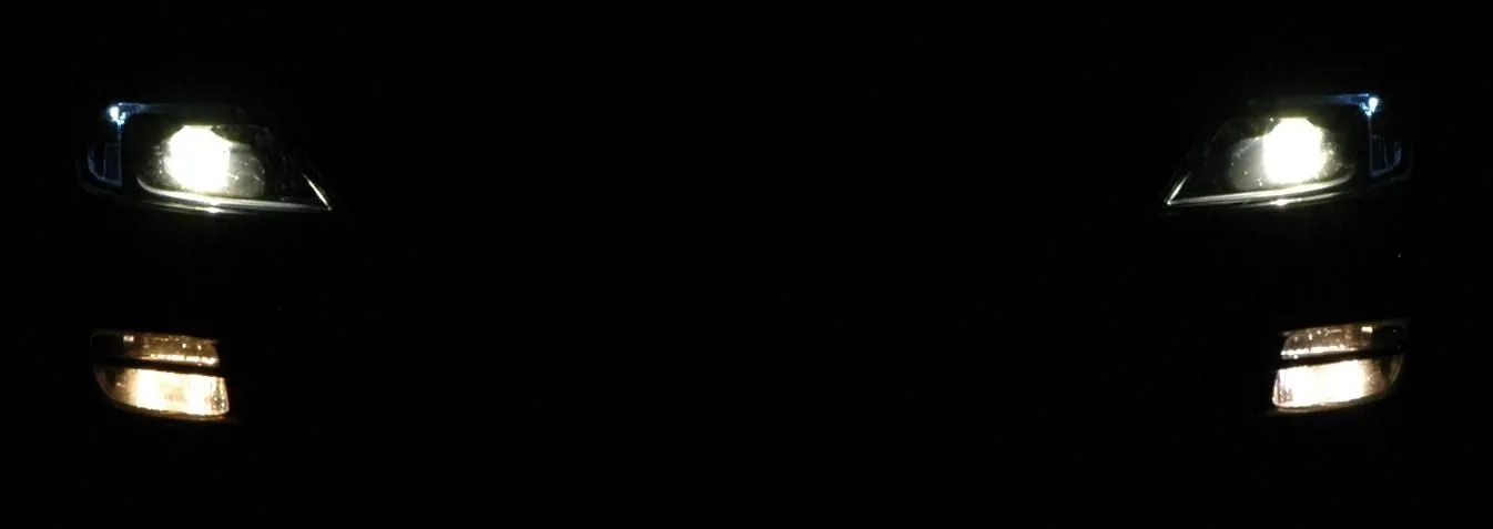

I promised to report back, so here's my report...
Attached is a photo with one new foglamp installed. The driver's side (on the right in the picture) is the new bulb. The color is not a perfect match for the HID headlights, but it is a LOT less yellow than the original. The difference is not as obvious in the picture as when you are actually looking at it.
The color difference in the hight lights is even more subtle. However, the additional output from the higher wattage bulbs is definitely noticeable.
