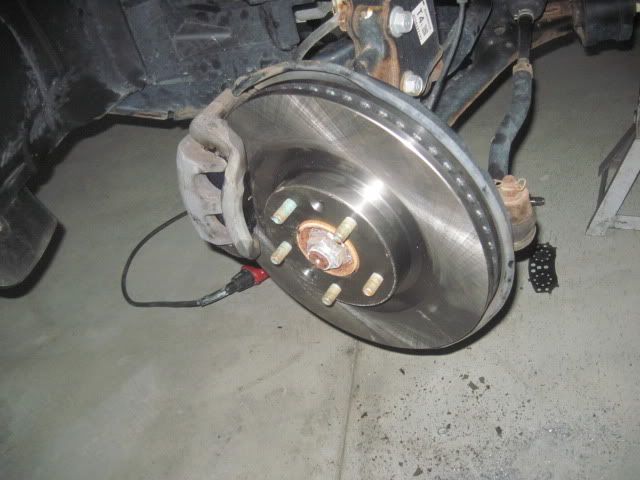

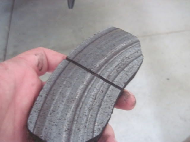

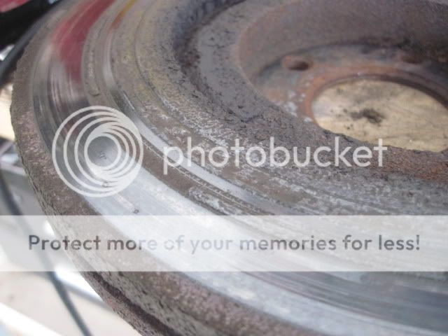

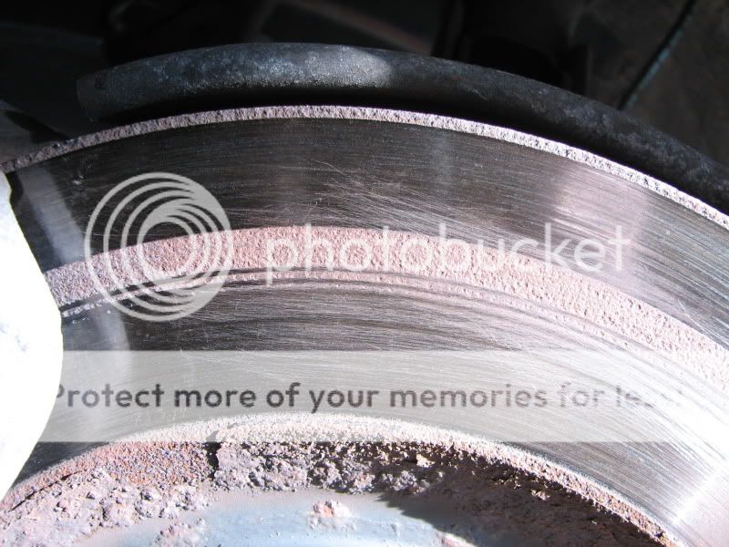

Our 2008 CX-9, driven by my wife, has had an every increasing pulsation of the brake pedal for a few months now. She really complained about it lately so I decided to pull it apart today. This is what I saw.
Looks good right? Nice rotor surface, pad looks nearly new!

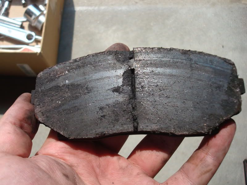

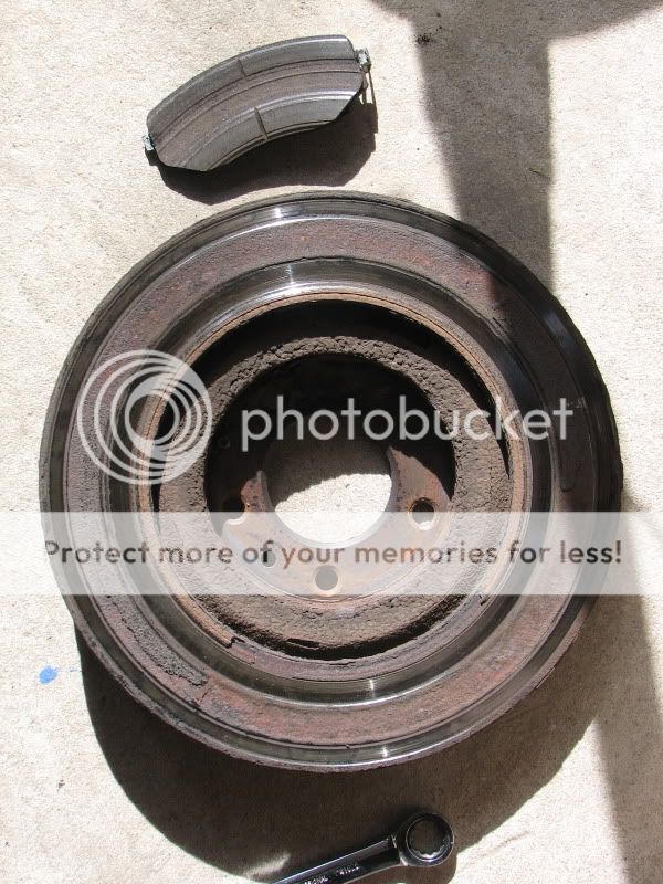

I've been working on brakes long enough to know to do a thorough inspection, so I popped off the inboard pad. Houston, we have a problem.

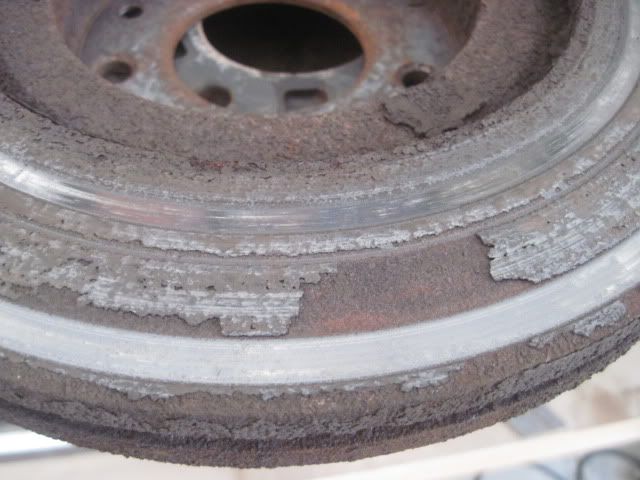

Further inspection revealed a much bigger issue on both front rotors. This is ridiculous on a car with just 23,000 miles that sits in a heated garage. The dealer tried to help but we are 2 weeks out of warranty.

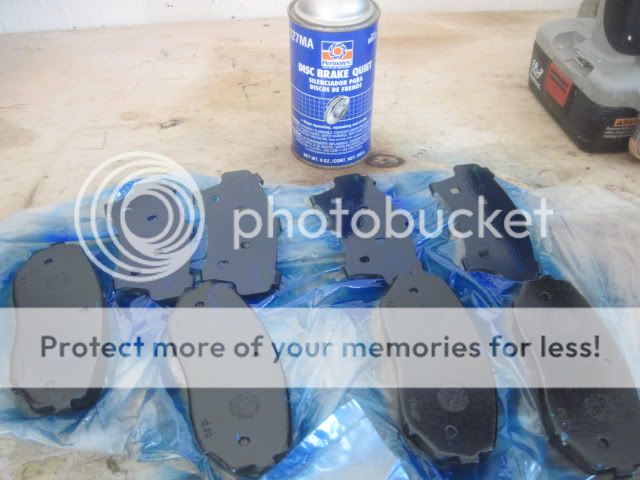

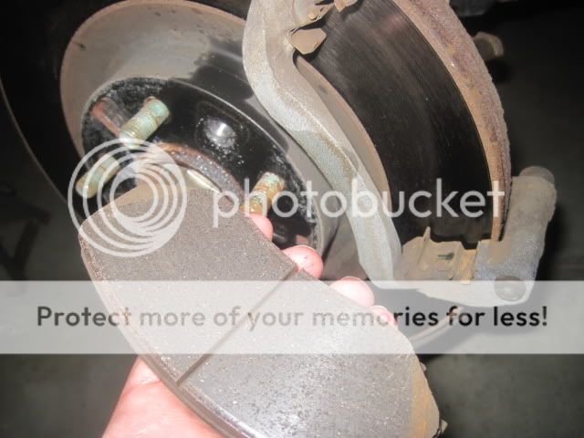

Through a local source I was able to find some halfway decent rotors and I went with ceramic pads. I want to upgrade to some high end rotors, but that's not in the budget at the moment. I also needed to get the car back in service TODAY because it's our only 3-car seat capable vehicle.
I always use this stuff, always.
Reassembled
And torqued. The dealer had tightened the rims so tight my 1/2" blue-point impact couldn't get them loose. (hand)

She just drives my 3 little kids around. We take an occasional road trip and an annual 1,000 mile run down to Florida. Nothing that would cause the rotors to fall apart. I would suspect road salt, but why only the inboard side?
Yea, I'm going to keep an eye on that. I've had calipers stick in the past but they've never caused the rotor to rust and fall apart. Also notice that the inboard pad still had plenty of material left on it, which would be unlikely if it were sticking. I think it's case of crappy rotors.

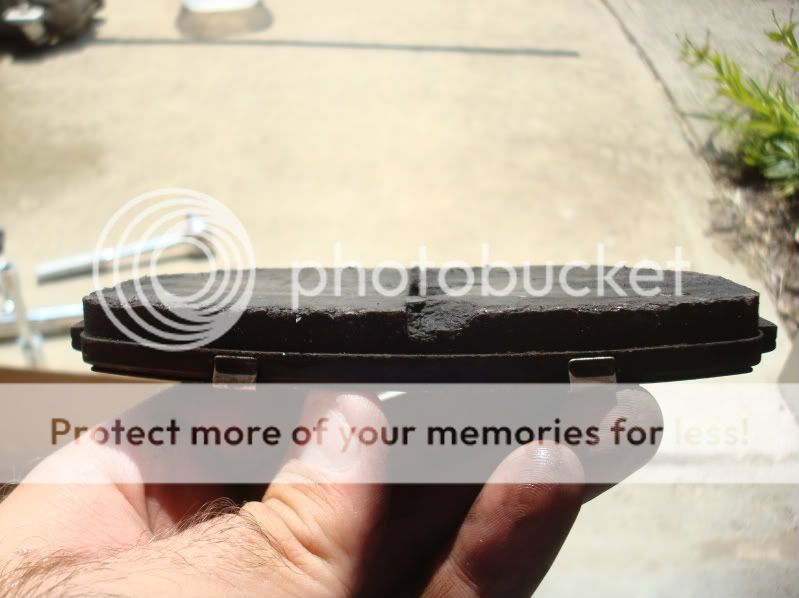

So here are my pics.
Craptacular!
Also the exhaust heat sheild supports and bolts all rusted through the heat shield is just flapping and rattleing away in some places.

I can't believe what I'm seeing in those pictures. Pulled the tires off today to inspect the brakes on the 09 CX9 and found that my pads have lots of life in them and the rotor surfaces are still smooth. However, the inside of the rotor hat, bolts, and surrounding areas are all rusting. My 07 Honda accord with more miles hardly have any rust on them and we don't even use salt on the roads here. I wonder if it'll be like yours in a year or two? This is really dissapointing.
