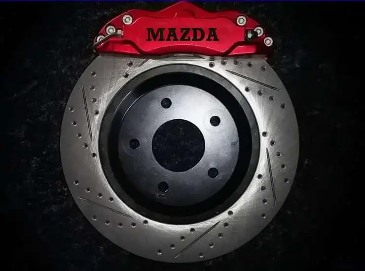

When I machine the rotor from high quality machined raw discs I am carefully with not build fictional heat during the machining and drilling rotors I micro polish every hole from front to back. My rotors have never had any incident of fracturing or breaking.
Drilled and or slotted rotors on a street car with some wheel designs you can see clearly the rotor and IMHO KOOL! All my vehicles for the "KOOL" drilled and slotted rotors.
This the most resent MAZDA BBK rotor I machined drilled for an application that did not offer both drilled and slotted rotors in the size needed for the BBK kit.
