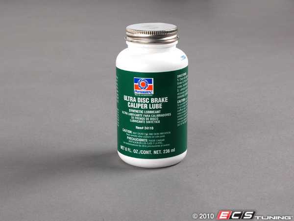

This is all ive used for years. Its what i was trained to use when i was a tech, and still use to this day. Never had any issues with any rubber swelling or such. Possibly your dealing with a separate issue there? Plus the bottle shown will last Years!
