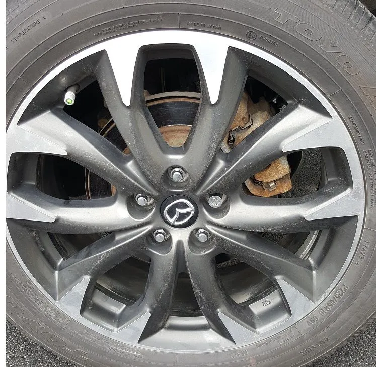

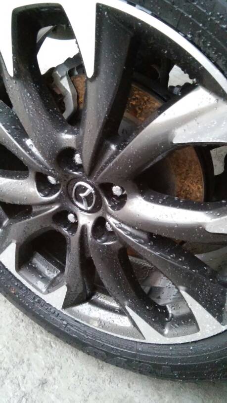

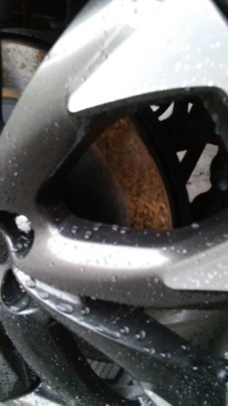

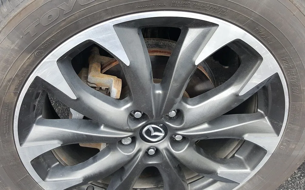

Is anyone experiencing unusual amounts of corrosion and rust on the brakes of the CX-5. I had my tires swapped this week from winter to summer and I was shocked at the amount of corrosion and rust on the brakes.
I do live in a place where salt is used on the roads during the winter months, but I have never experienced this before on any of my previous vehicles.
Are you talking about the brake rotor "hat" (the portion directly behind the wheel mounting flange) or the working part of the disc? If it's the hat, this is normal; and salt on the road (which should be a criminal offense as far as I'm concerned!) only makes it worse.
See the attached pictures. This is the worst I have ever seen on a vehicle only 9 months old, salt exposed or not. I checked out my sister's 2016 Rav 4 and there is nothing on it. If this is normal for Mazda, IMO, their quality standard is not very high.

Well the rotor looks to be about what I would expect under the conditions you describe. The caliper surprises me a bit, but I don't live in that kind of climate. I'm sure others here have more experience with this issue.

Rust on the discs is normal, but not directly on the calipers.
The Disk is the part the brake pads press against. The caliper is the part holding the pads. I think it is unusual to have rust on that part of the disk that the pads presses on unless the brakes are unused for quite awhile.
Rotor will often flash rust like that. It's only surface oxidation and wears off with the first stop of the brakes. could probably wipe most of it with your finger. The steal rotors have no protective coating or anything so they flash rust pretty quickly.
