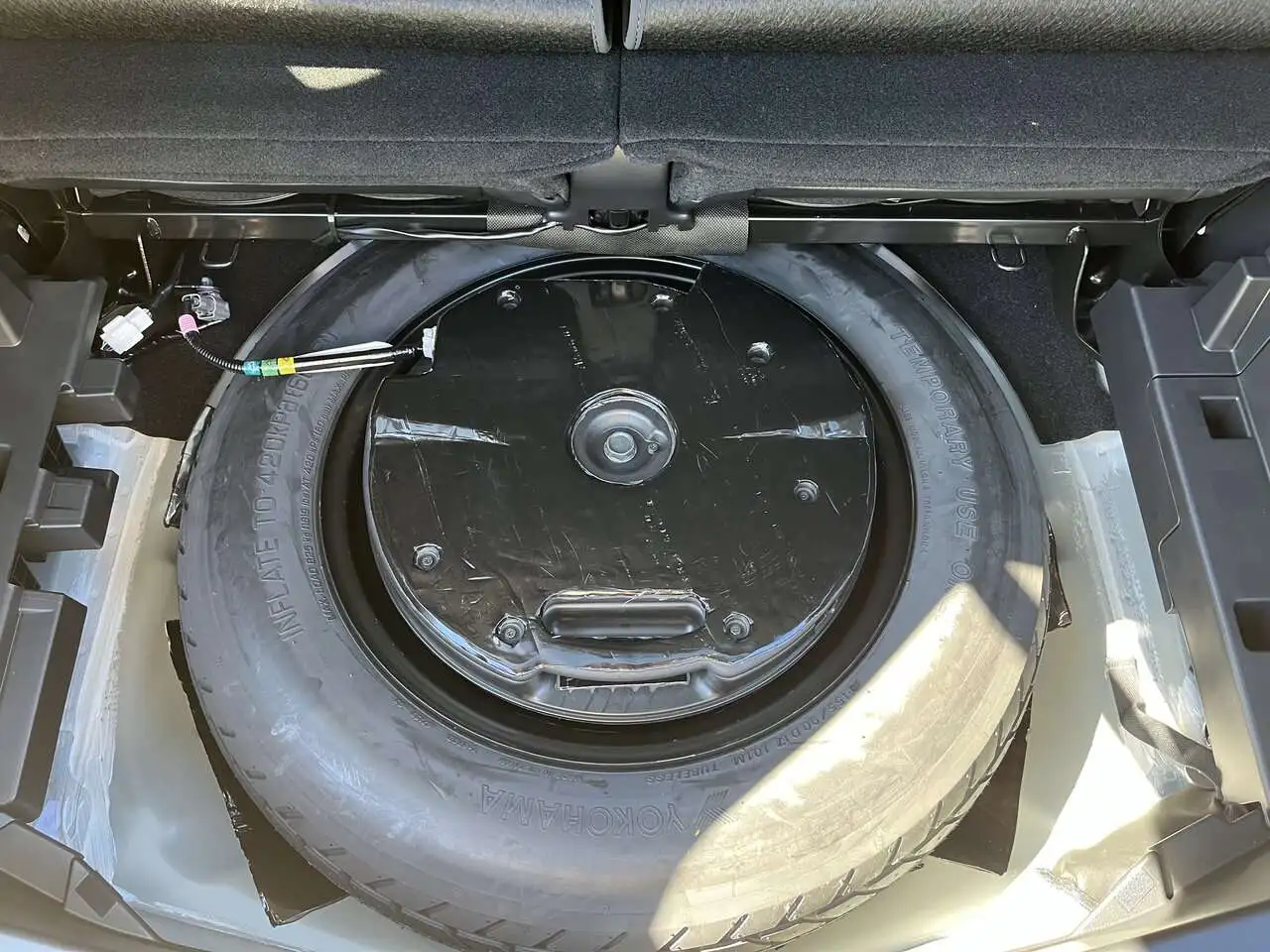

I checked the audio levels and i set them to the same positions as the 21 GT. I took the sub cover off to check it and the speaker does move. However if i unplug it i don't notice that much of a difference. I remember the 21 GT's sub moving more air out of the port...Maybe it's just me...

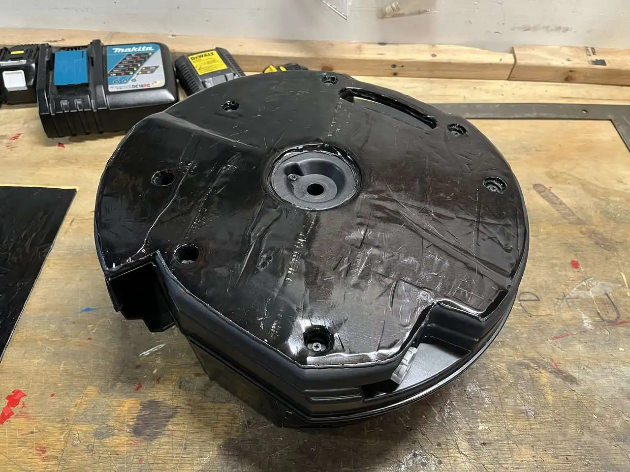

The subwoofer is now powered from the amp under the passenger seat. It use to have its own independent amp built into the bass box. In my opinion the 22 Bose system sounds better than 17 Bose system. I just traded my 17GT for a 22GT. I agree that the 22 sub is weaker due to not having it’s own dedicated amp.

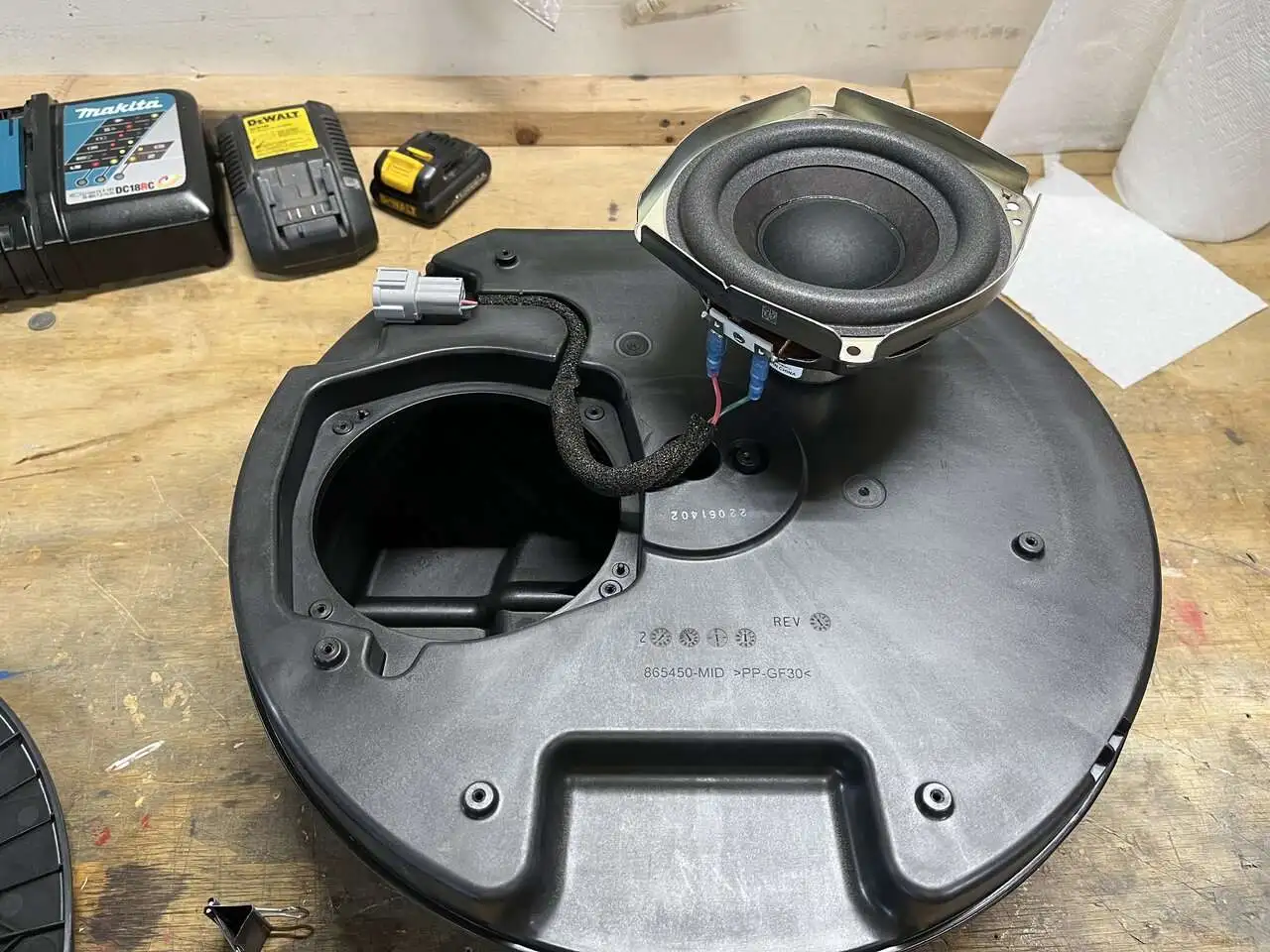

My 22 bass box
My 17 bass box

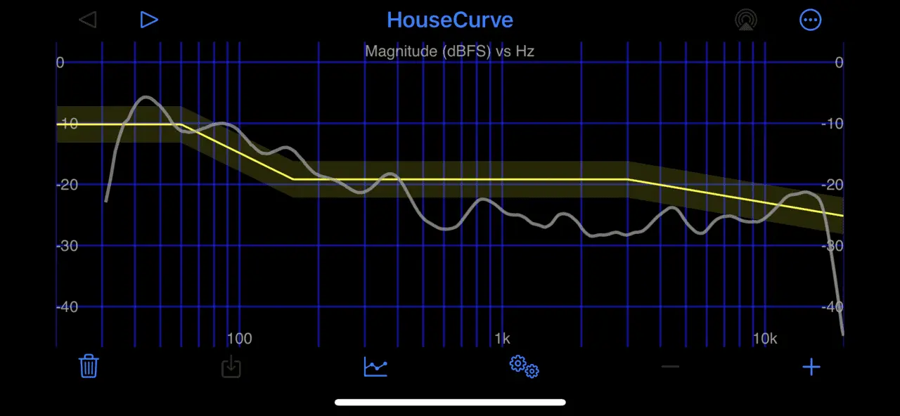

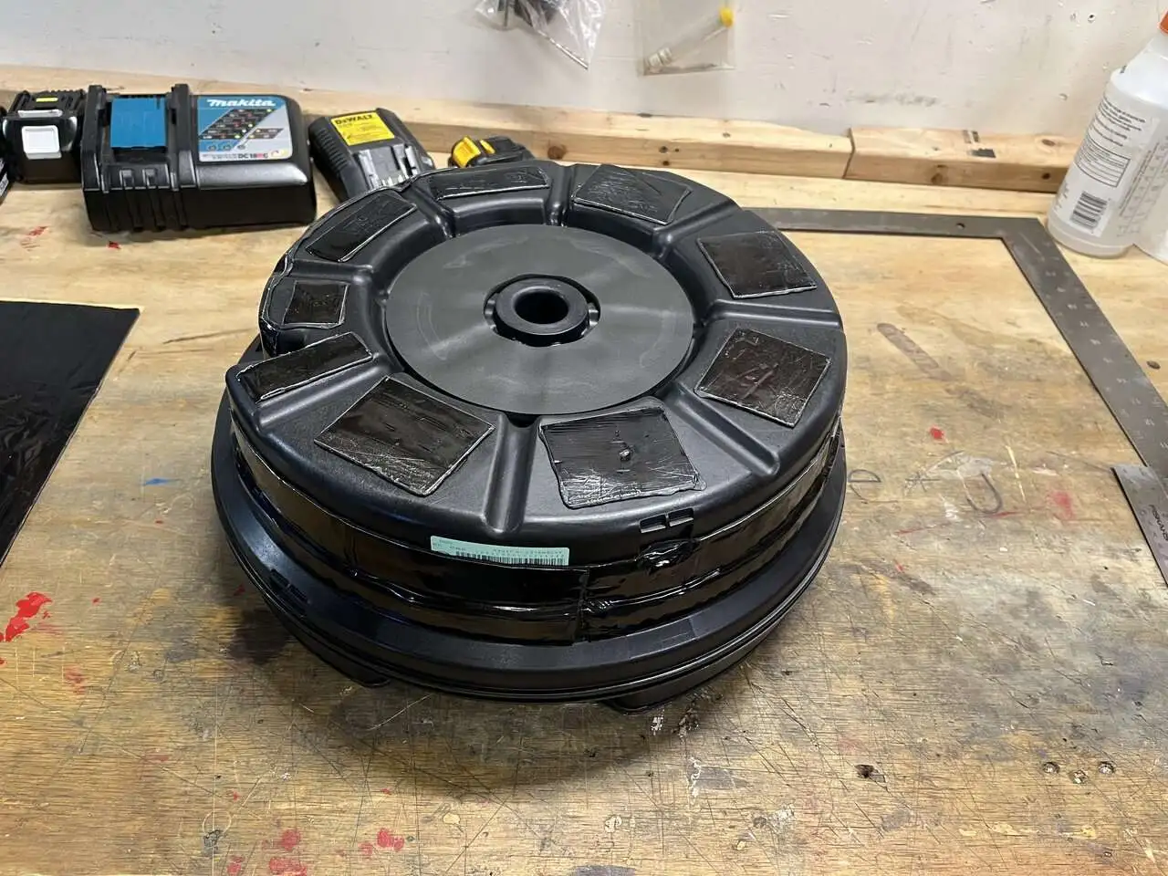

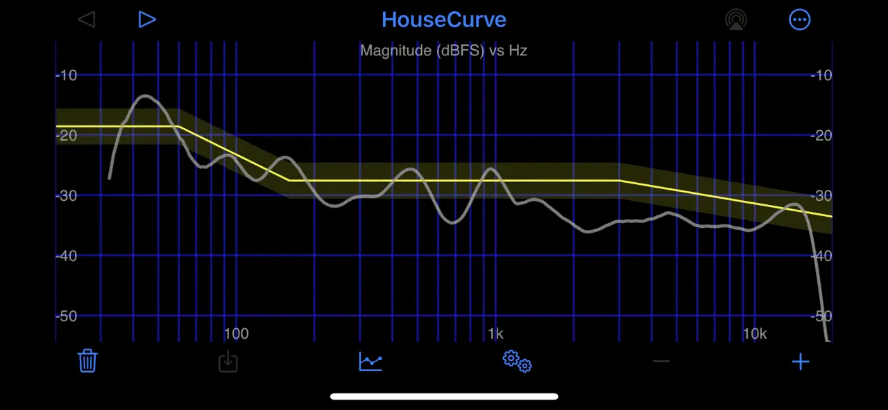

These are frequency response graphs. This was after I sound deadened all 4 doors and the hatch, under the spare tire. I also sound deadened the entire sub box. The sub only adds output from 35Hz to 50Hz. The bottom is before sound deadening. Sound deadening really increased the mid bass.
With factory sub disconnected.
With factory sub connected.
Before sound deadening.

The curve with the sub connected ain't half bad! Especially considering it's stock!
After sound deadening I think it sounds very good. I’m no audiophile but it I compares to my other home systems, that have much better components, which I built by buying drivers and building boxes. I just wish the bass went to around 30Hz. I’ve added a 12” sub to a 17 CX-9 and it improved the bass but created a huge peak at 45Hz. I tried eq’ing it but I hated the delay caused by the processor. I didn’t move the sub to my 22 because it sounds better than my 17 did.

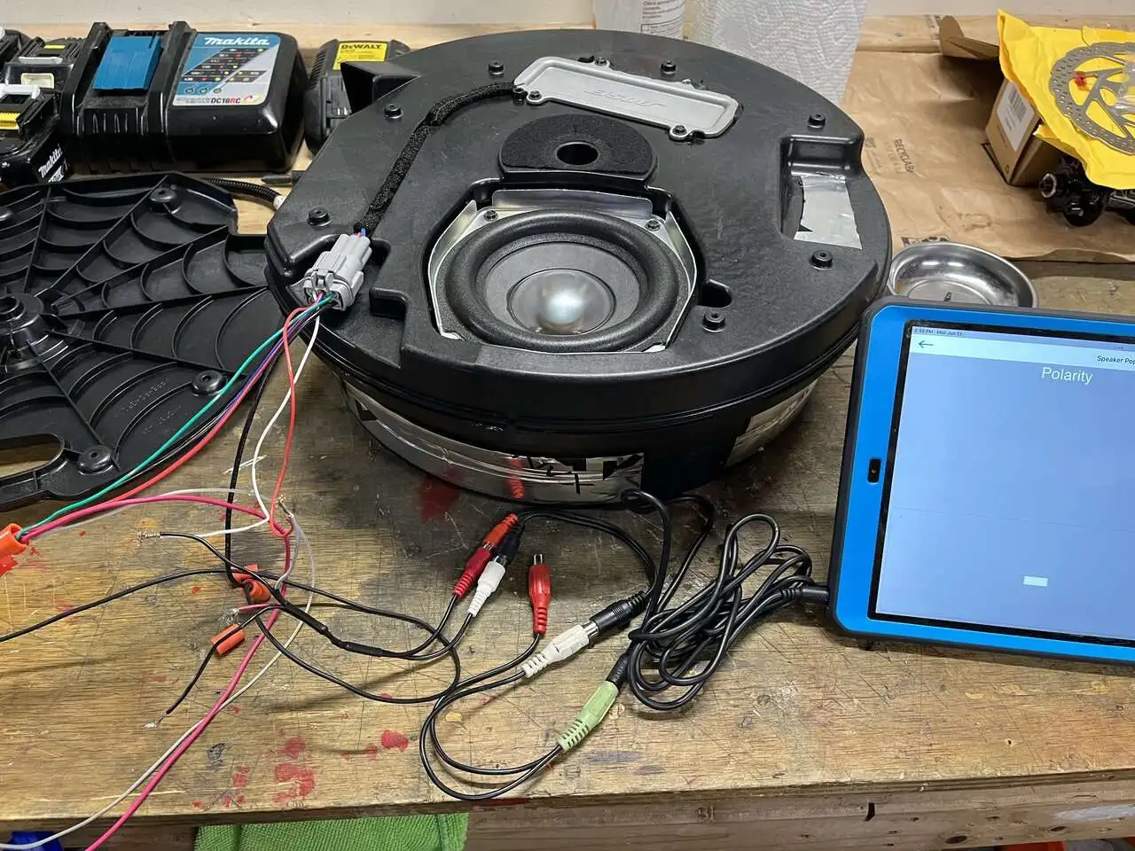

Yes, it’s in the spare tire. My 22 GT has a passive sub. My 17 GT had an active sub. Both have the same box. I believe it’s a 6th order bandpass box.
Bottom with sound deadening.
Top with sound deadening.
Sub in.
Sub out.
