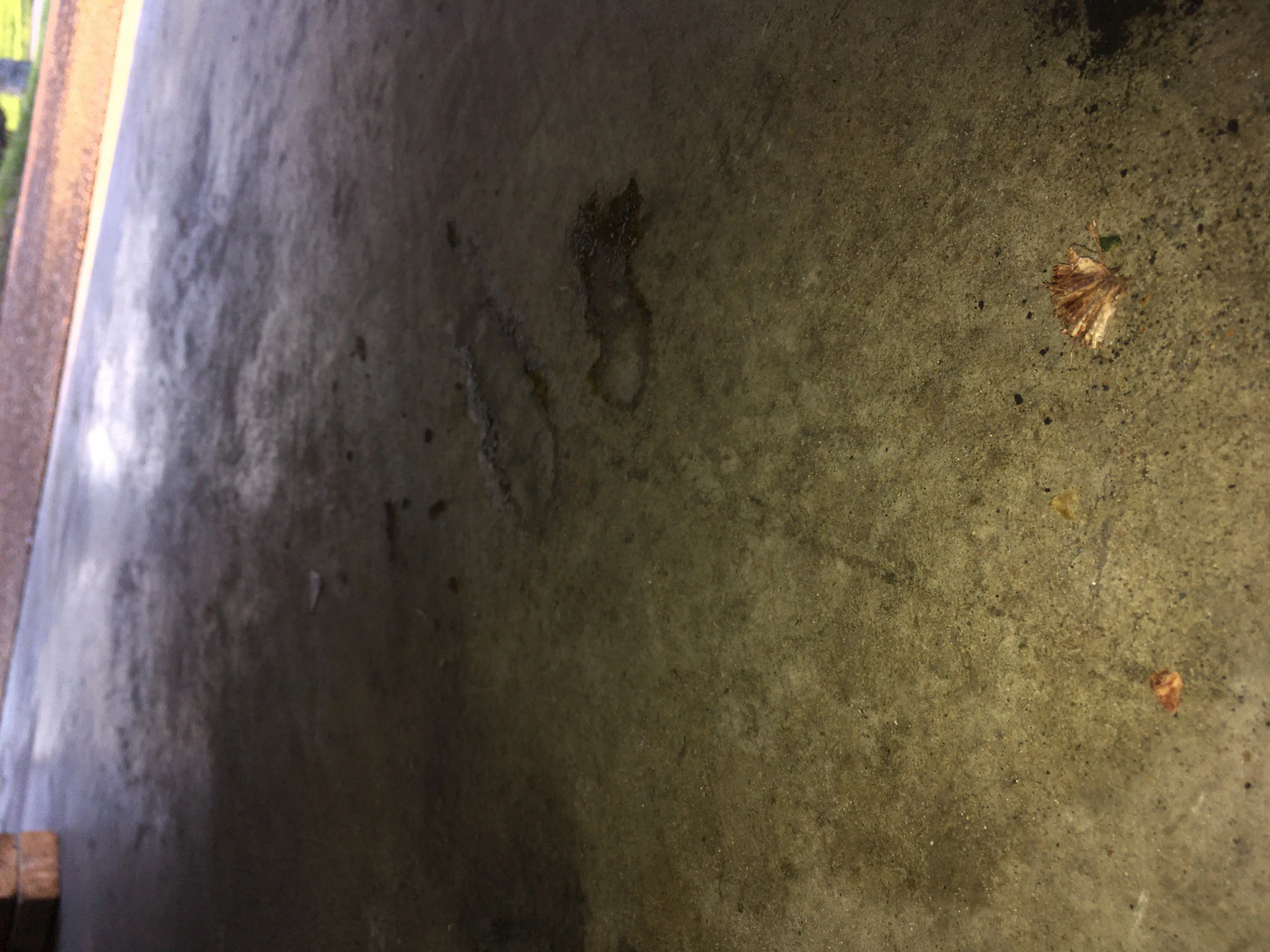

Also it has now left some gas on the garage floor since the tank is full
Also something is rattling again
That REALLY sucks.
Gas leaks are a huge dirty dangerous job.
My gas leak led to a new gas tank.
There's a good chance that you will be popping a code soon (small evap. leak) but my car didn't when it rusted through at the seam.
It may not have had time to register a code before I got the tank replaced.
You might get lucky and only have a leak when it's completely full and it may not throw a code.

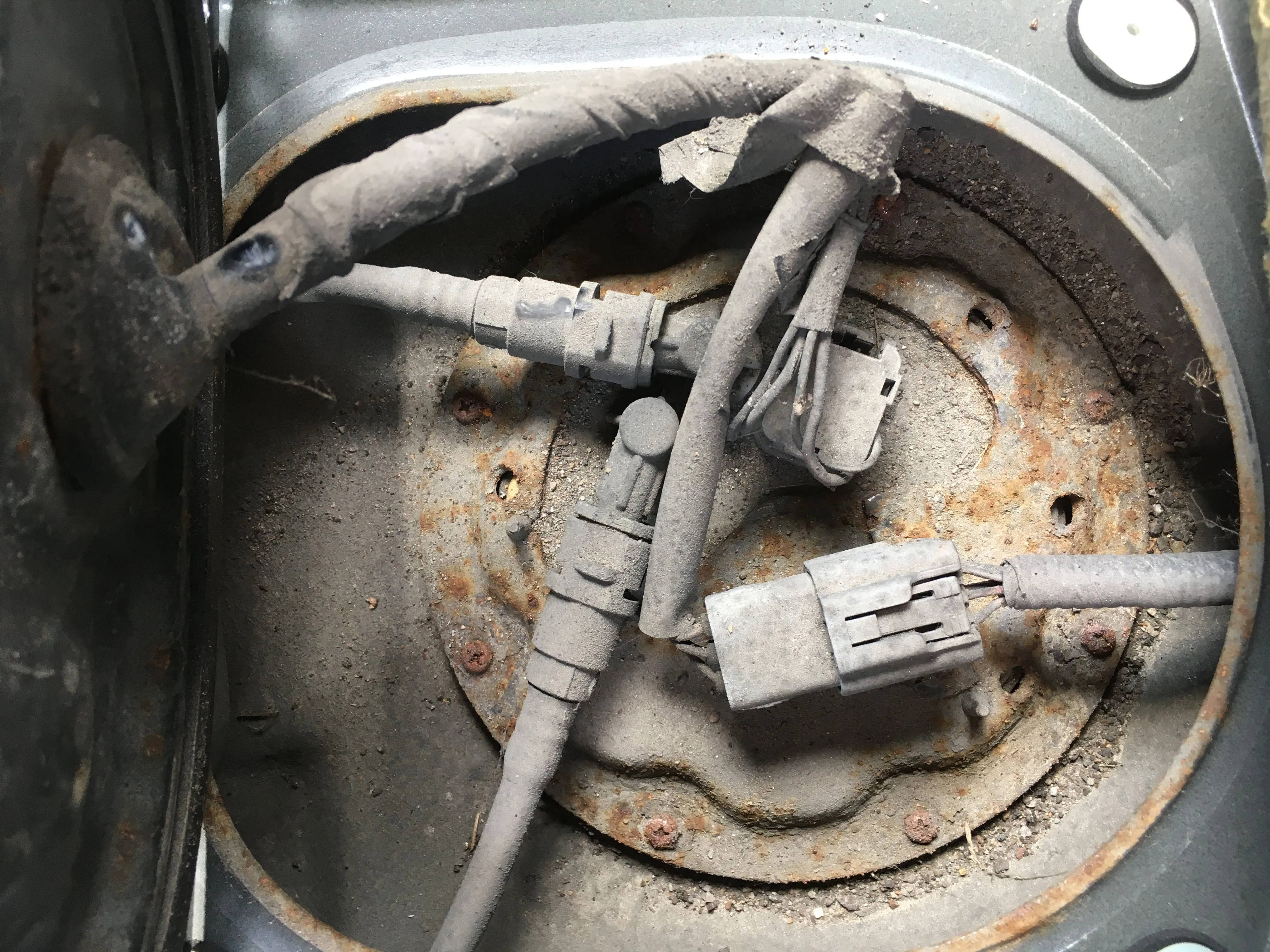

Lift up your back seat and remove the access cover and take a look and sniff at the fuel pump housing.
They get old and crack and start leaking.
You may need to replace it.
You can buy just the housing instead of replacing the entire fuel sending unit at around $400.

Try to find the source of the drip.
Your car may need to be running to get it to drip.
Well, last night it leaked on the garage floor while it was parked, then I drove it and parked it and it leaked on the driveway overnight. I drove it today about 15 miles and it doesn't seem to be actively leaking anymore, time will tell for sure but nothing dropped on the driveway while I was working in the garage all day. The fuel gauge has only barely barely moved from past F to just about at F. What I don't understand is if it only leaks when it's absolutely full you would imagine its leaking from the top but the top wasn't wet. Anyway, it doesn't matter I'm not worried about it, it leaked last time I had it and it leaked when the PO had it, and as I said I'm not doing anything until I can get it on a lift. So I'll wash off the underside and not fill the tank again.
..., it doesn't matter I'm not worried about it, it leaked last time I had it and it leaked when the PO had it, ...
If you're not throwing any codes or if it doesn't matter in your state, then don't worry about it.
