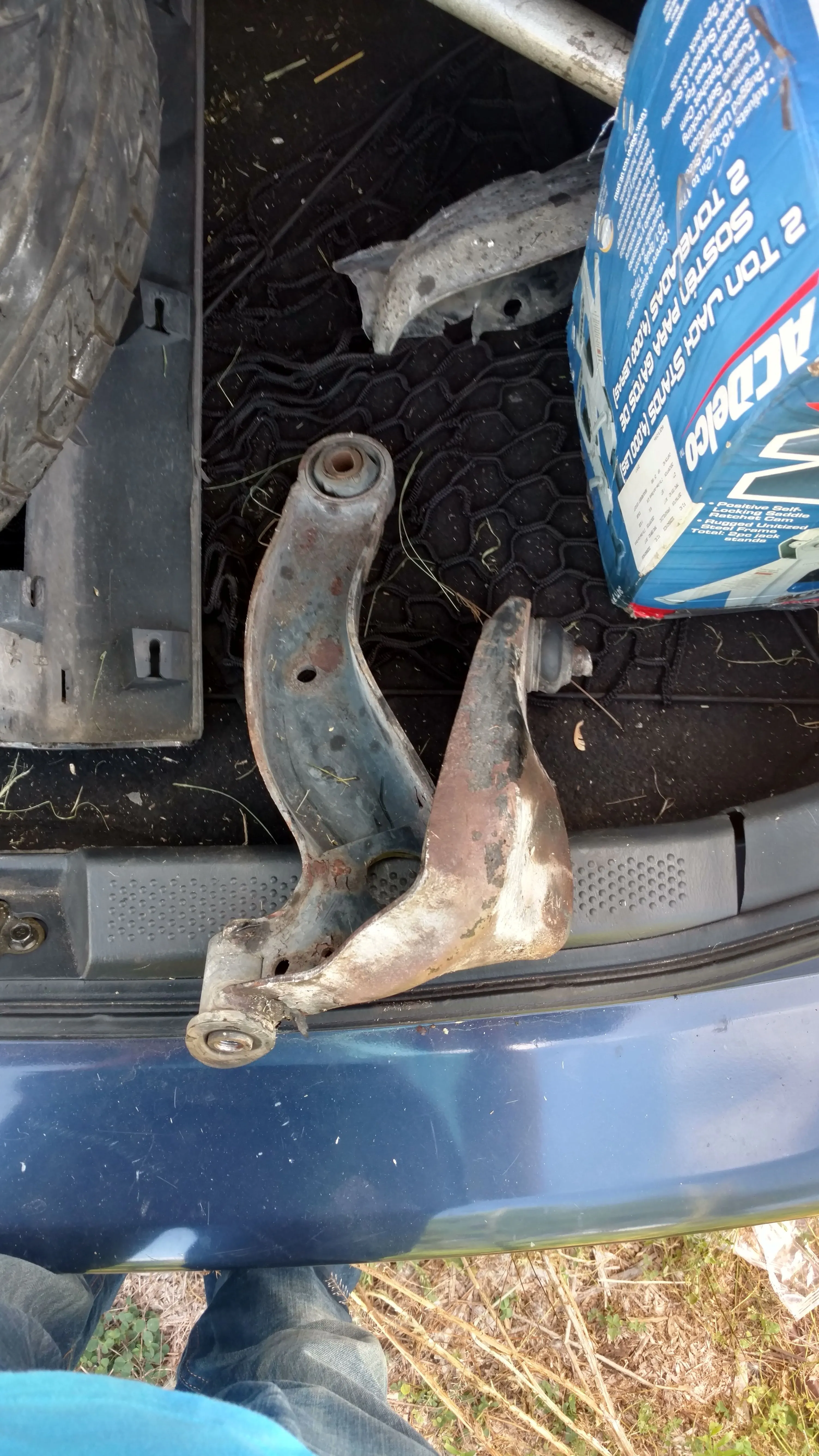

Spencer, I know your pain regarding bent LCAs... Happy you managed to save this one. Mine was my fault - cement culvert walls don't tend to move very easily..

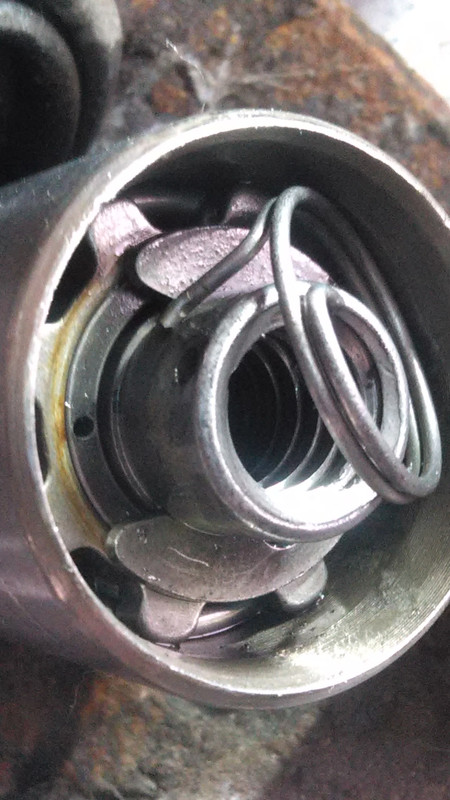

There are all kinds of weird gizmos inside that I have yet to wrap my head around. Lol
They are supposed to ratchet the rear pistons out.

These parts don't last forever and I doubt that they are being replaced when the caliper is remanufactured.
Our rear calipers are one odd duck.
I don't think there's anything else the same.

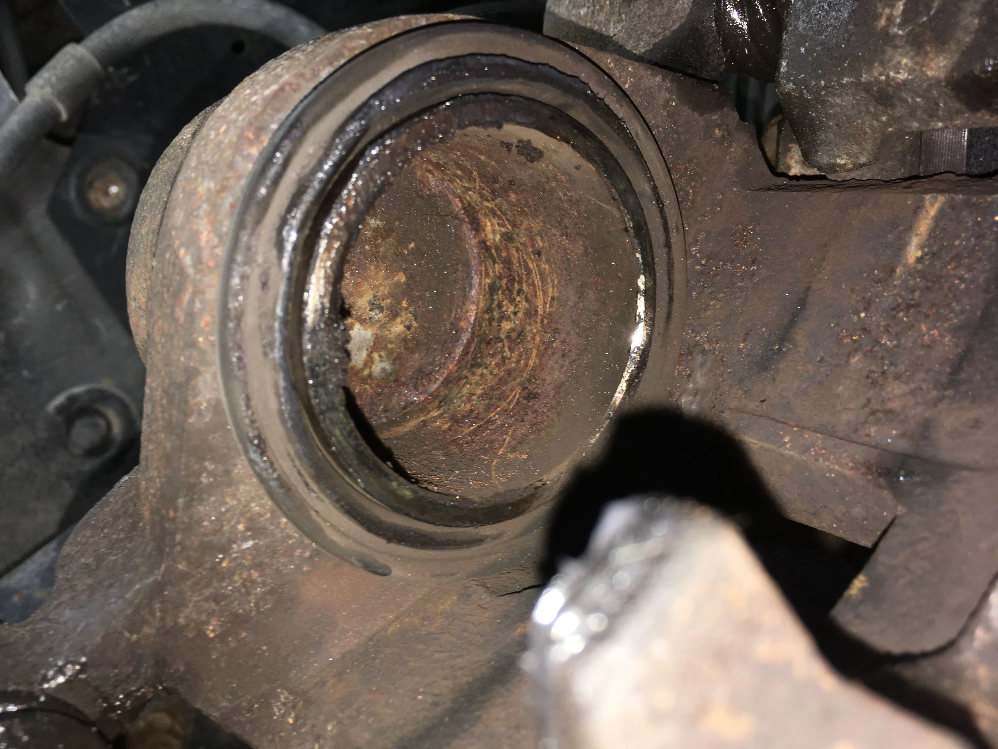

Odd thing is, mine aren't leaking at all and they actually look great on the outside. They function properly as rear brake calipers, it's just that neither side will hold the rotor and keep the car parked when the parking brake is engaged. I'm not greatly bothered about not having the parking brake, but I'm at a point where I'd like to have it working.

... it's just that neither side will hold the rotor and keep the car parked when the parking brake is engaged.
Crawl under your car and check for movement at the P-brake connection point with someone pulling and releasing the P-brake handle.
With the handle released, it should look like this...
With the handle pulled, it should be close to this...

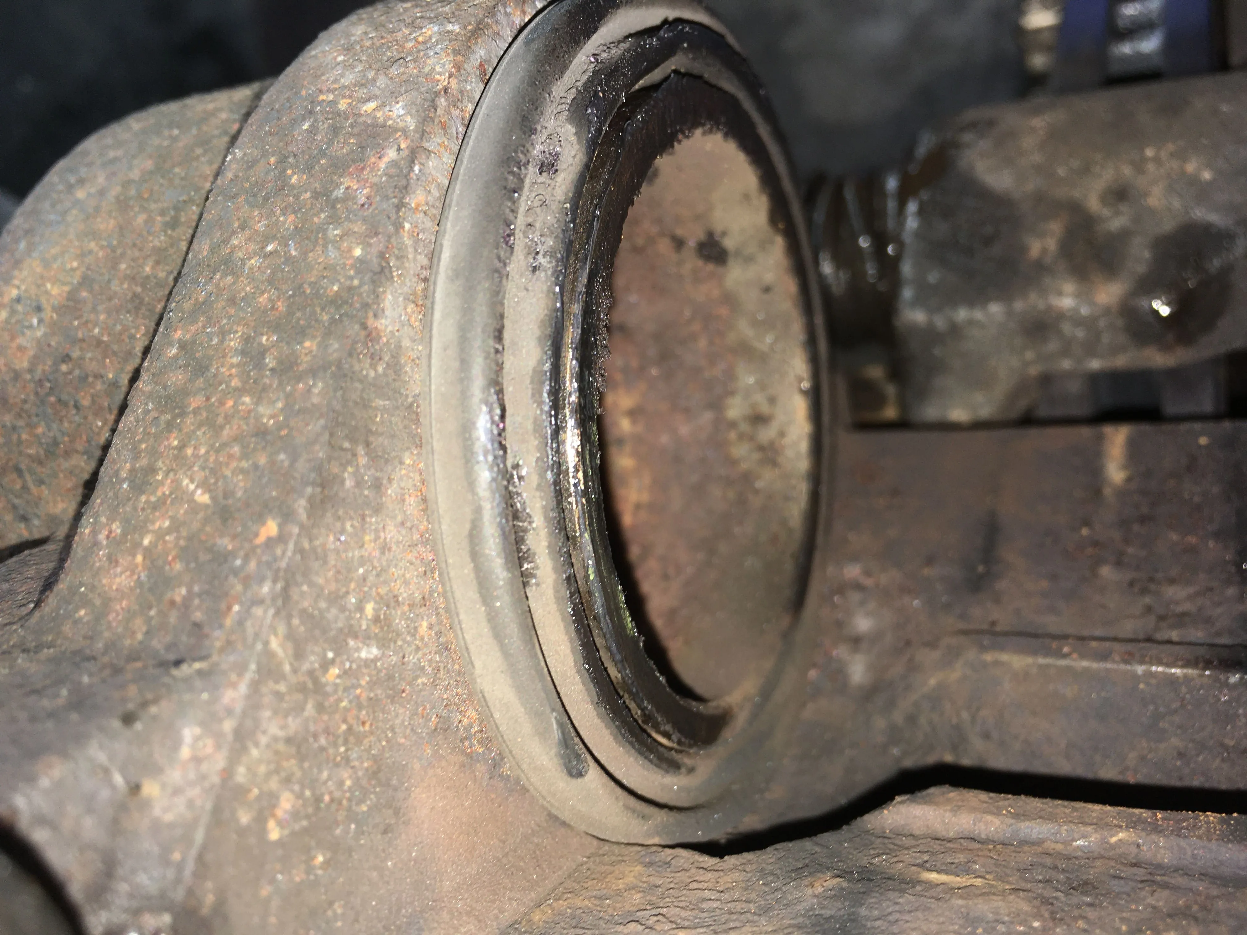

If you turn the adjustment gear till it stops and your piston looks like this, it will bind in the bore and you'll strip your adjustment gear or the part it mates with and it won't work.
I find myself scared of curbs now lol.
Just don't hit them, simple as.
(I jest, but these LCAs not being boxed in allows for easier folding over. My Subarus are stronk like bull in comparison!)

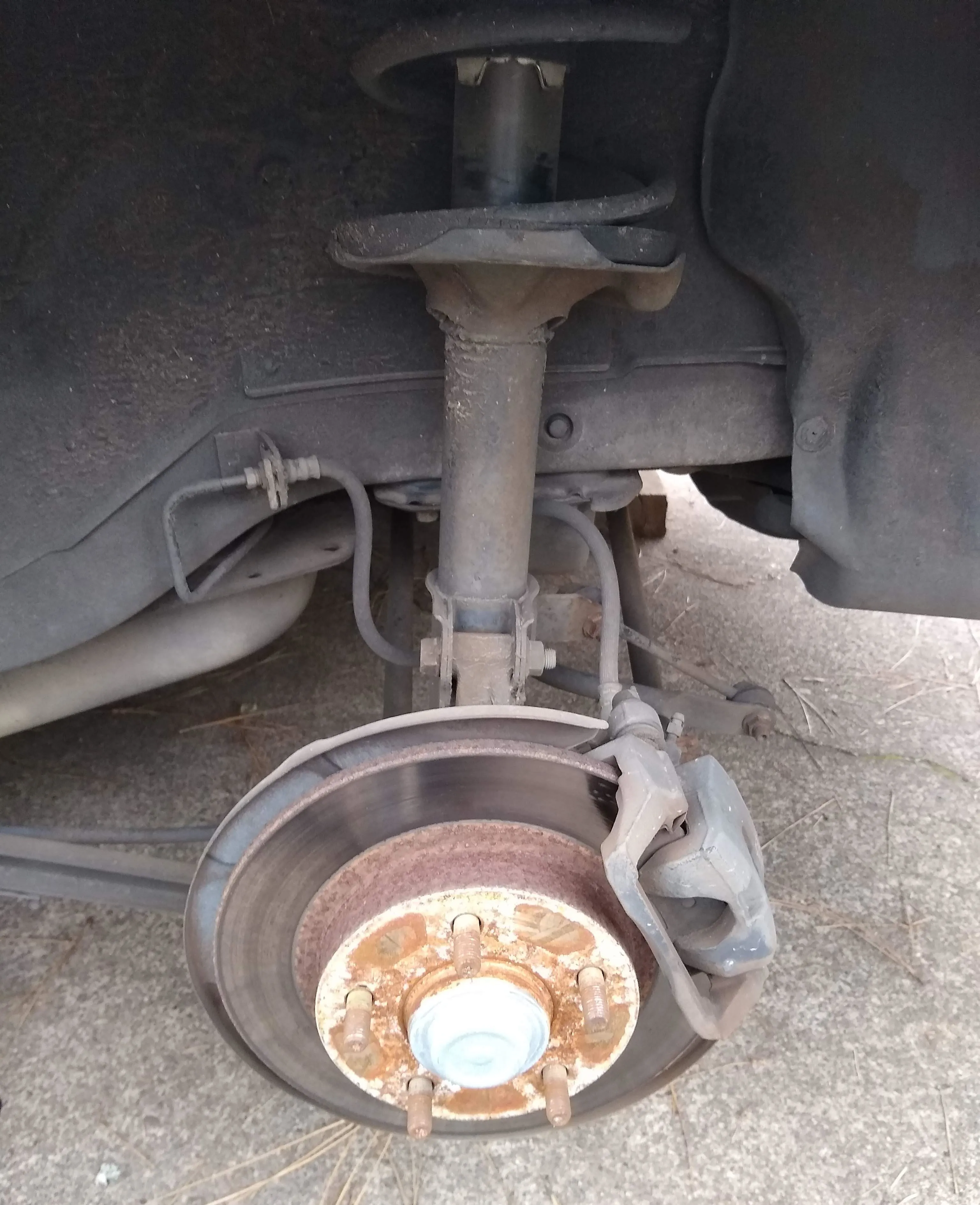

Pulled of the passenger tire to compress the caliper piston and the caliper slid off without a fight and this is how far out the piston was. I compressed it. I imagine the caliper would’ve fought if it it was seized up. Then I went to get gas and I checked the temperature of the rotors when on for back, both at around 100 F.

The rotor and pads were probably just seating themselves the first time with a bit of extra rubbing and friction.
It sounds like it's good now.
