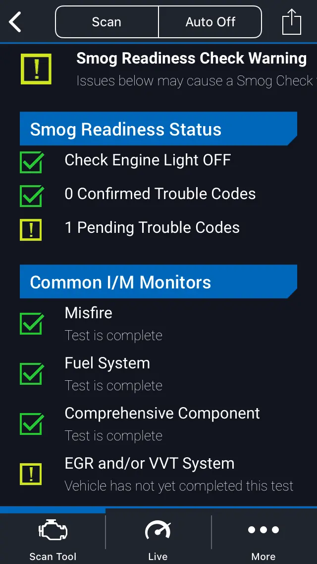

Since all the smoking cleared up after about a minute of driving, wouldn't that be a pretty good indicator that it's the piston rings?
Yes but oil draining down past the valve seals after a night of sitting would do the same thing.
Valve seals leak much slower.
Maybe a little more oil in the cylinder than yesterday but not much. I do think the spark plug hole gaskets that come with the valve cover gasket are leaking because the spark plug boots are wet as well as the spark plug threads.
That makes sense,
check the grommets for leaking at the top of the valve cover.
Mine was leaking and running into the spark plug hole.

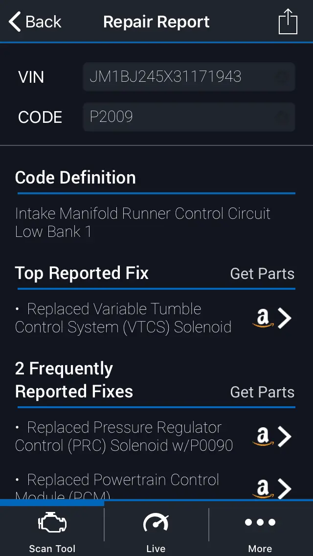

Do you know what Rockauto calls the VTCS? I haven't had luck finding there or at Autozone.
I think I entered the VIN although on other cars the scanner has pulled the VIN on its own.
