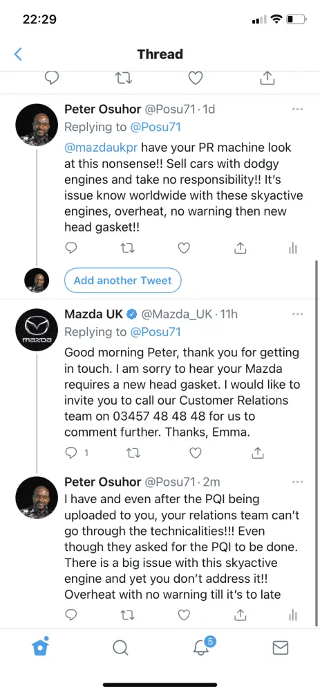

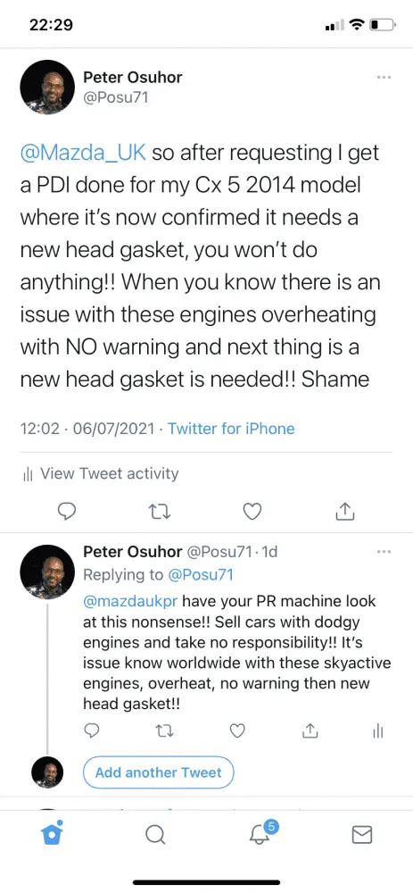

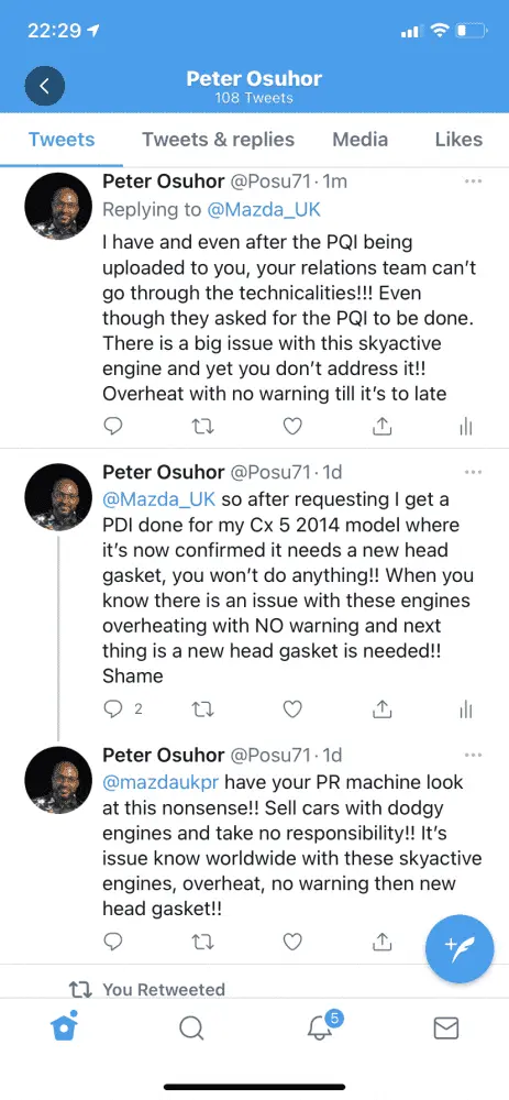

Please, all with this issue in UK and worldwide, can you please add weight to this issue on my Twitter? Hopefully we can get some weight behind this and Mazda will start to hear us.
