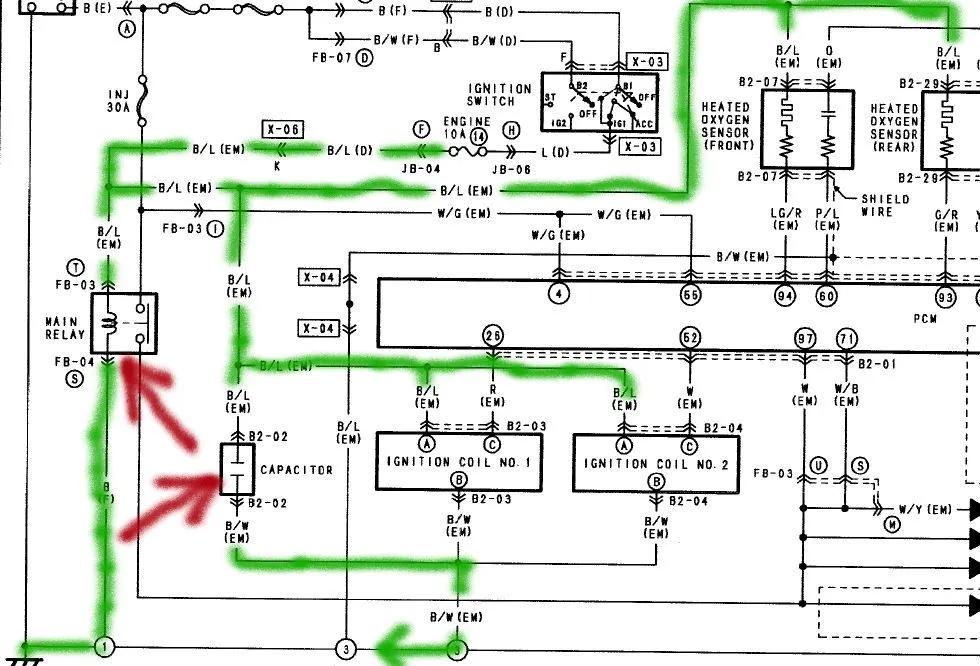

Alright- I found the electrical diagram. I am not sure where you are seeing that this circuit supplies all that stuff. Perhaps I am looking at the wrong thing... I've included a screencap where I have traced the circuit in green. I'm seeing that this 10A fuse powers the main relay, a capacitor near the coil packs (according to the component placement), the coil packs, and finally the O2 sensors.
My thought on the O2 sensors is that if they were going bad- the car would run like crap. I'm not putting a lot of stock in them being the issue. Additionally, if the coil packs were going bad- I'd equally think that the car would run like crap. So while I think it's more likely to be the coil packs than the O2 sensors shorting out- I still don't particularly think that's the issue. That leaves the main fuse and capacitor.
What is very, very interesting- when this issue first happened, I had found that the capacitor wires were pulled out of their harness. I didn't put much stock in that because I didn't realize that was a cap, and it didn't seem to be a sensor of any kind. Now, I think I will definitely go check my solder job and ensure it is no longer shorting. I might replace the cap as well.
The main relay is also a trouble point. A relay is just a resistive coil that creates a magnetic field. If the coil gets a short, the resistance drops. When it shorts bad enough- the resistance will go to near zero ohms and that's a direct short to ground. So I think that a new main relay would also be a very good choice (and probably pretty cheap).
Lastly- I can't find any indication in this schematic what circuit is actually powering the ECU, but I am questioning that it is the circuit in question...

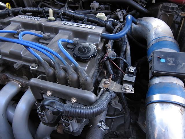

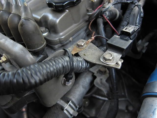

HUGE update here! After this many blown fuses....
...It was time to find the damn problem.

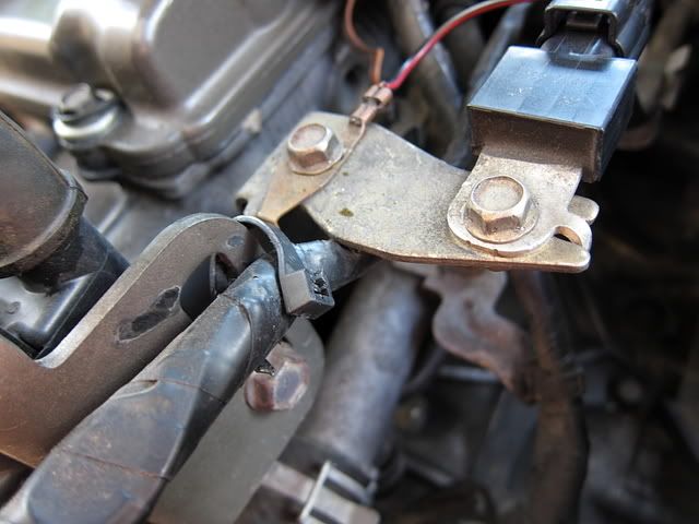

This is the bracket that was causing the problem. Also note the busted wire tire.

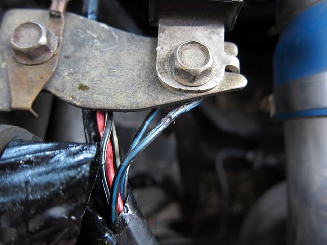

Here you can see the rubbed wire harness.

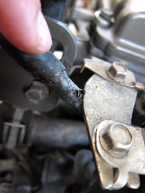

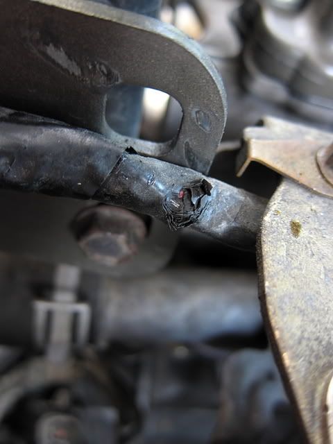

And here you can actually see the wire rubbed down to the copper.
Unwrapped the tape to expose the bad wire.

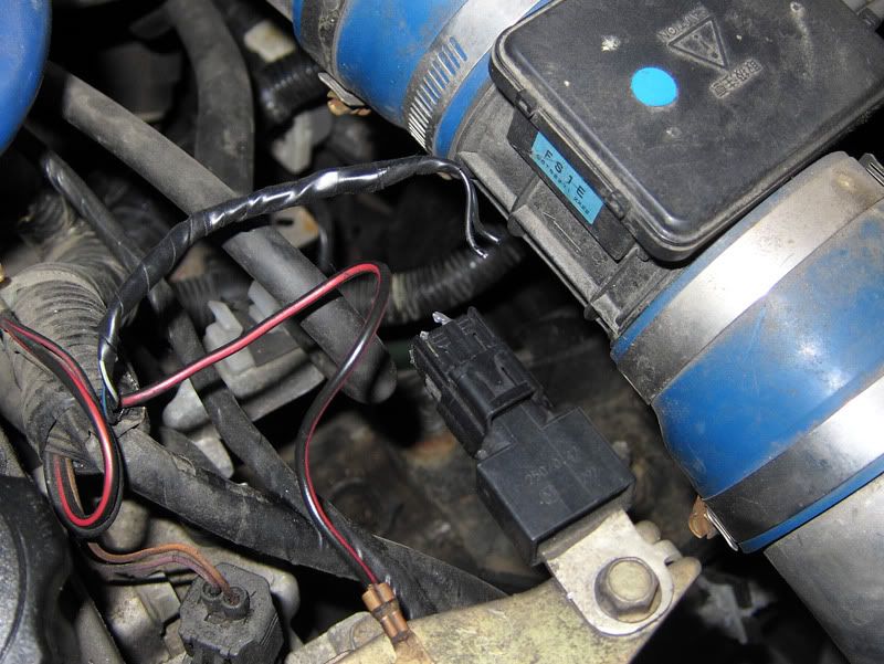

All wrapped up, AND wire loomed. I used the highest rated black tape I could find- rated for 130* C
All fixed.
