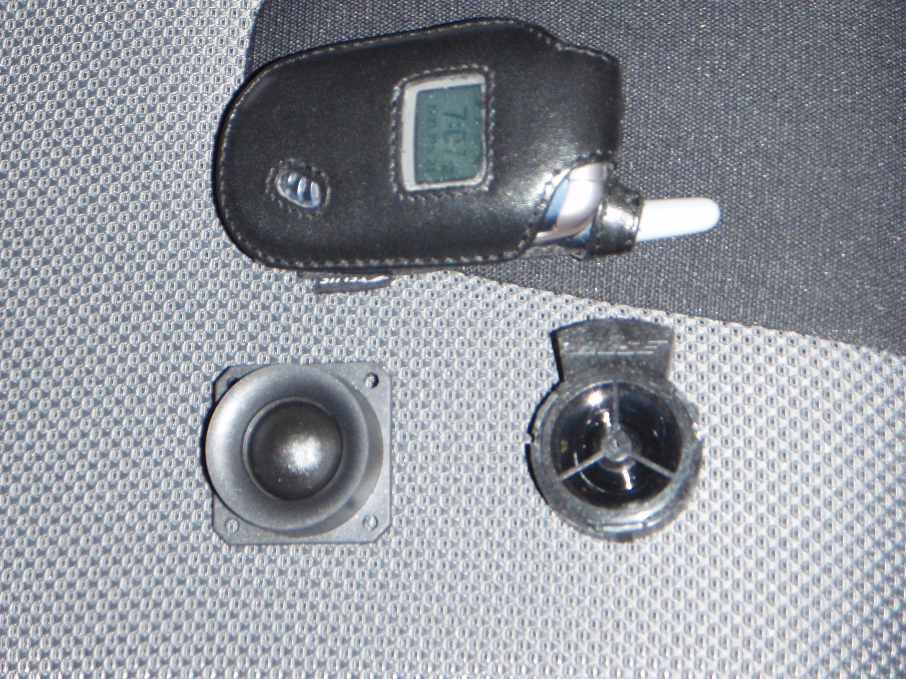

Here's the dayton tweet on the left and the bose tweet on the right. I put my cel in the pic for a size reference.

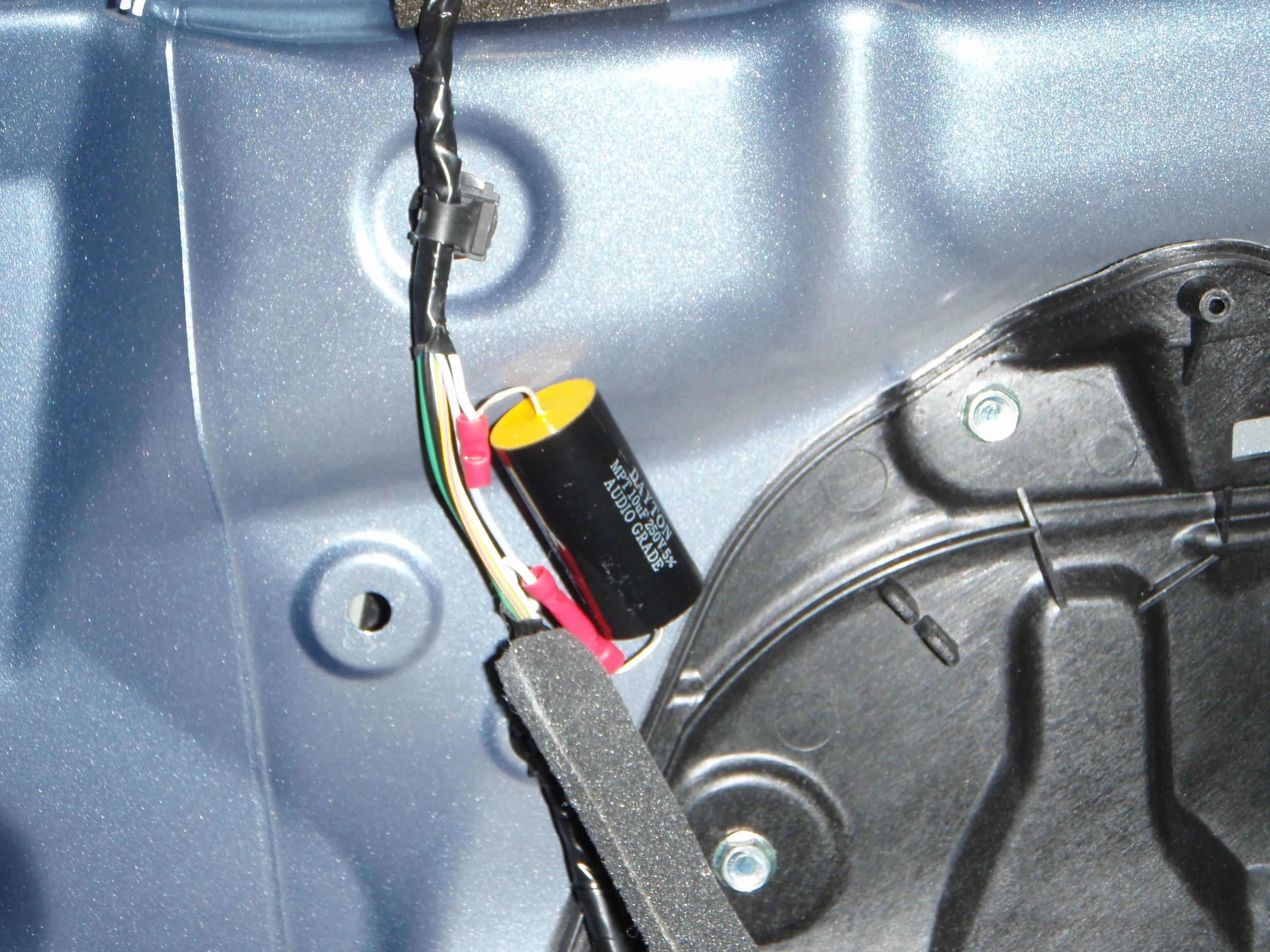

This was the only place I had room to put the cap for the tweeter x-over. In hindsight I should have bought a lower power rating cap as these are huge and probably overkill for what I'm using them for. I normally prefer soldering connections but since this was an experiment and will eventually be replaced anyway I used quick n' easy crimp connectors. After this pic I wrapped it all in electrical tape to protect the connections and support the weight of the cap.

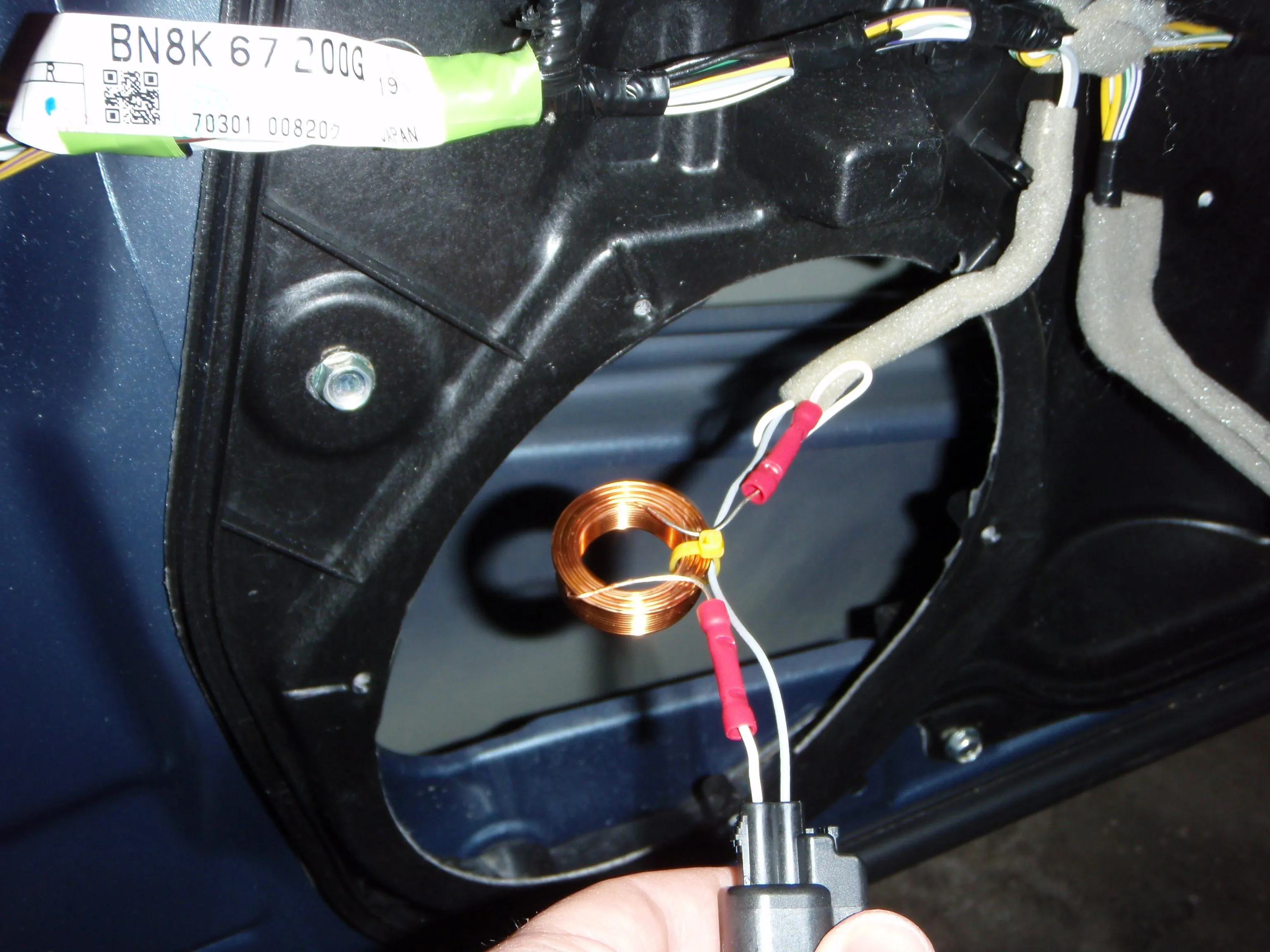

The inductor for the woofer x-over. Taped it up as well afterwards, not the way I like doing things normally but it can be returned to stock quickly if needed and like I said, this will all get replaced within a year (hopefully).

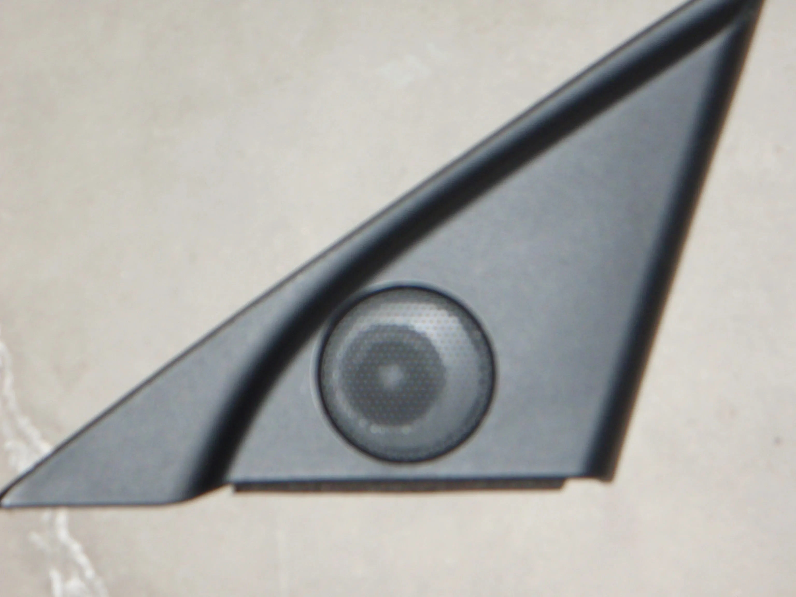

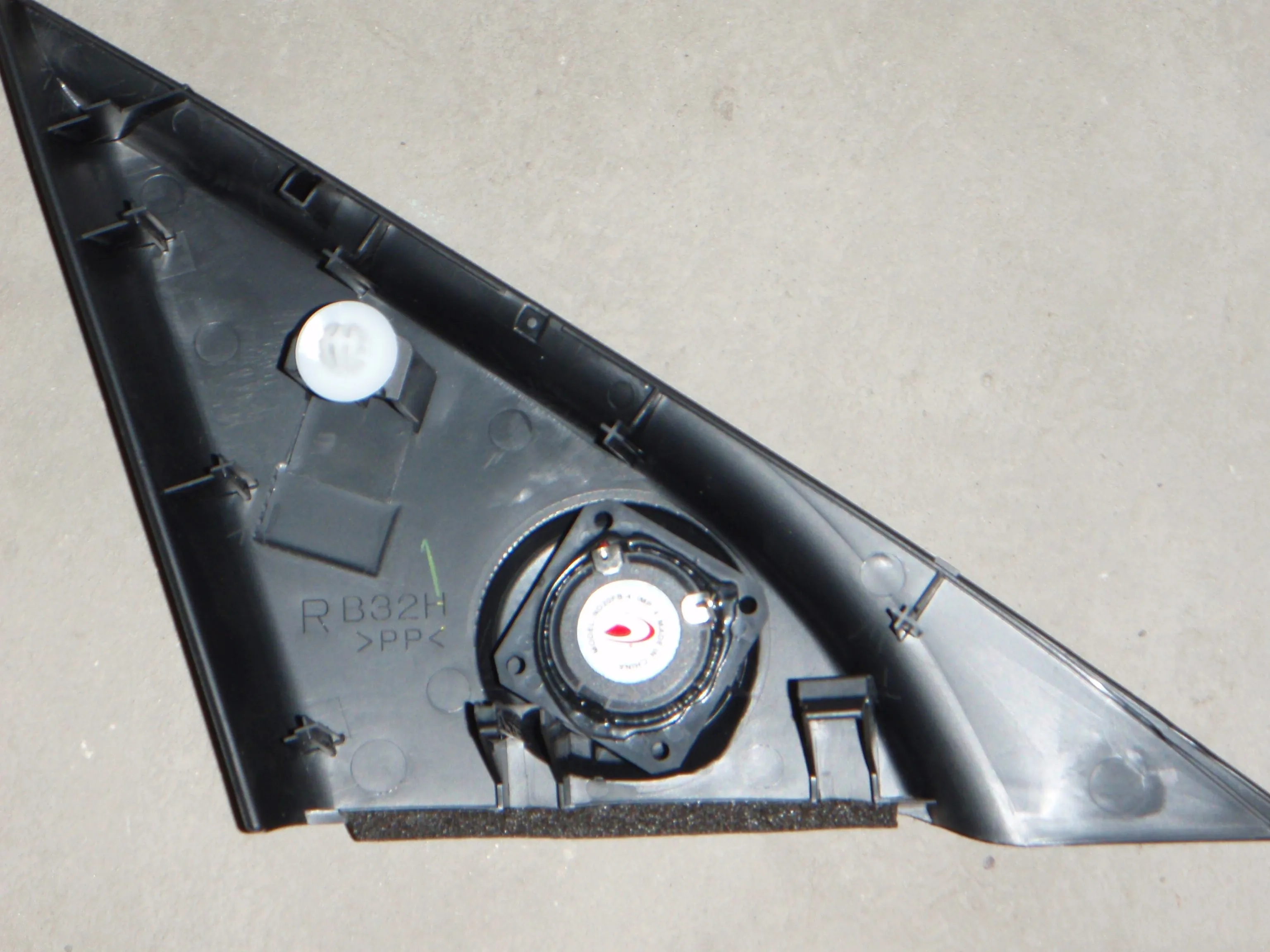

Dayton tweet in the factory hole. 2.5 wraps of electrical tape around the tweet body makes a solid press-fit. If anyone's wondering this is as big of a tweet as you're going to fit in the factory hole, there's just not much room. Notice I had to carefully bend the terminals as there's not enough depth to clear the connectors if they're straight back.
http://www.mazdas247.com/forum/attachment.php?attachmentid=127968
Click image for larger version Name: P3310020.JPG Views: 0 Size: 1.19 MB ID: [ARG:4 UNDEFINED]
What the dayton tweet looks like from the front, nice and stock-looking.

Looks pretty easy to do. The only question I have is the capacitor install. It looks like you put it in parallel to the wire instead of in series. Not sure if that's just the way it looked in the picture, of if you really did it that way.
Code:
--|---------|-------<| )) (speaker)
(Parallel)
I thought it was suppose to be in series like this:
Code:
-----)|-------------<|)) (speaker)
(Series)
Can you clarify, please? Thanks!
