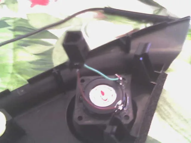

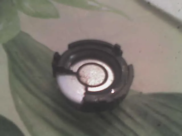

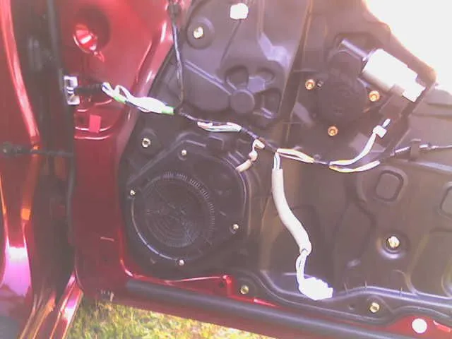

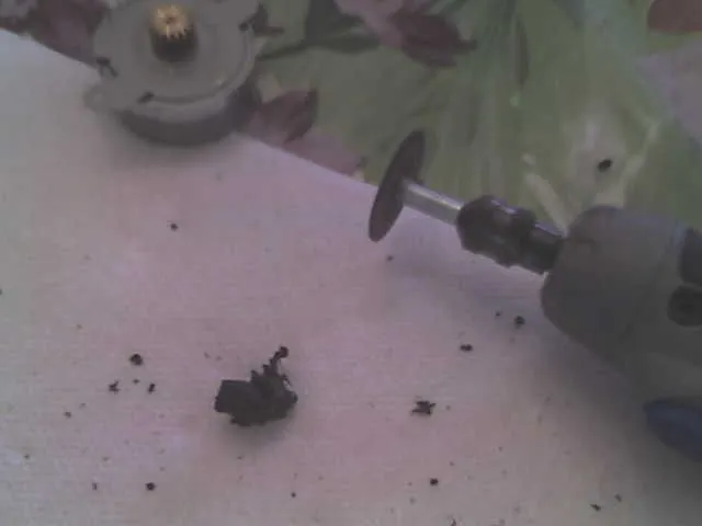

So I got home today to find my speakers laying on my doorstep! Needless to say I jumped right in and started to install them. The woofers couldn't have fit better. The best part is that they came with the right connector on them! Go figure! So once I got the woofer installed, I went to work on the tweeter. This was the more difficult part. I didn't have an extension cord to solder the tweeter right in, so I had to innovate. I ended up taking a dremel tool and cutting off the connector on the stock tweeter and putting it on my new one. Wasn't too difficult, really. After that I put everything together and gave it a test run, and my initial reaction can probably be best described as such...
(nana)(nana)(nana)(nana)(nana)
The improvement was enormous. No more muddy bass (well, not as muddy as before anyways), and I could actually hear the tweeter! The left right comparison was ridiculous (only had the passenger side done), so I then went out and did the driver side. That's when I realized I only ordered one capacitor (boom07) So tomorrow at work I'll try to find one laying around so I can get the other tweeter in, but at the moment I have both woofers going strong!

Is there another capacitor hiding somewhere along the wiring up to the tweeter? I just removed my stock tweeters and they only have a 1 uF capacitor on them. For the 4 ohm speaker that would put the high pass frequency at 40 kHz, which obviously doesn't make sense.
