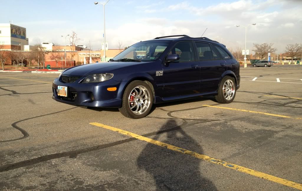

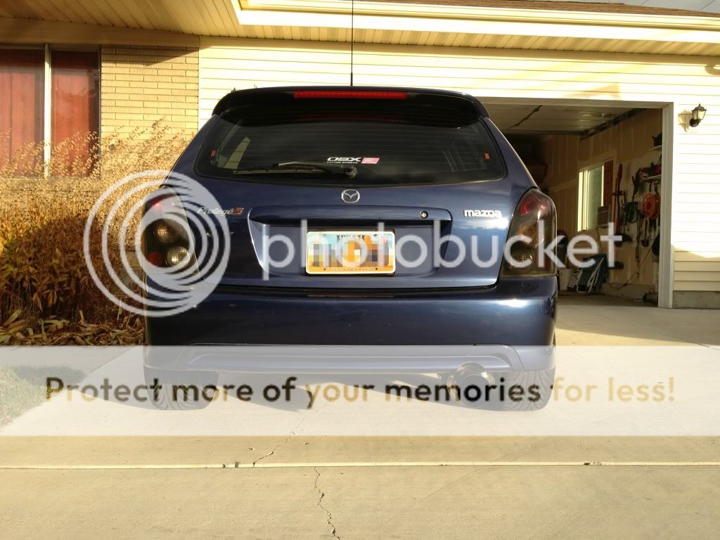

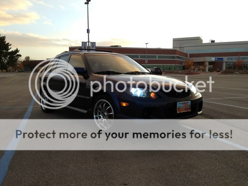

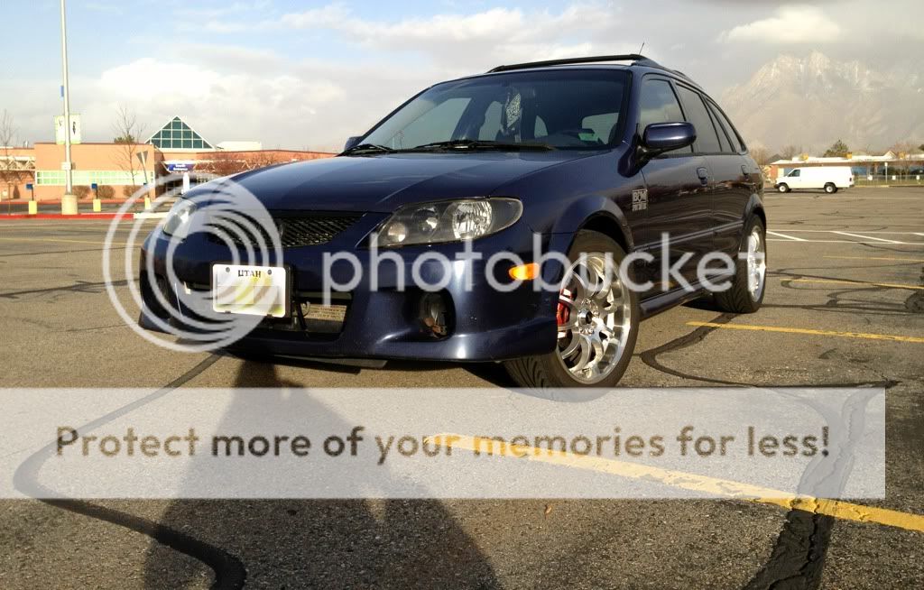

Here are 4 pics of my car as of 11/25/11. We had some nice weather today for a change so I decided to wash her and get her cleaned up. Also, it shows my car with the black housing headlights better than the other 2 bad pics of them, and updated pic of the rear without the "MAZDASPEED" sticker. Enjoy! =)
Car looks good man, keep up the good work... I like the bkack housing headlights with the midnight blue, makes me wanna do that to mines
visiongt9506: Thanks, its nice to receive positive comments about my car, I really appreciate them. And I recommend going with the black housing, it cost me $6 or so for a rattle can of hi-temp flat black and about 2 hours of my time. Completely worth it in my opinion, I think the black looks so much better than the chrome with the midnight blue.
walkingchaos: Thanks! That's actually my favorite part of the car is the wheels, I think they compliment the car perfectly =)

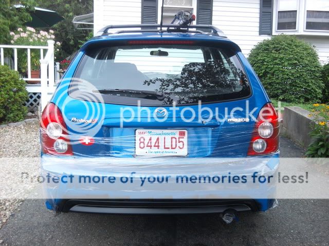

If you do decide to paint the rear bumper, I'd recommend using PlastiDip. It's about $6 and is super easy to do. Just cover up everything you don't want sprayed. It comes out as a soft plastic, and looks sharp. Best of all, if you don't like it, simply peal it off!

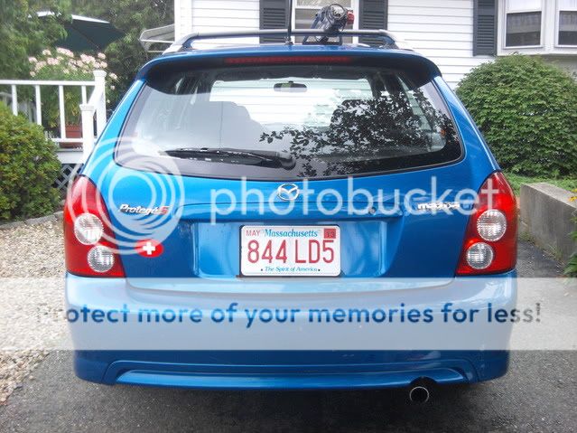

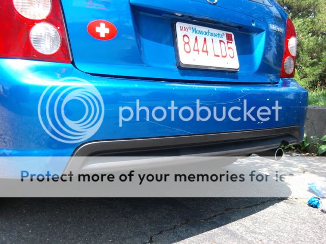

This is mine. I did 5 coats, once every half hour, then let it sit overnight.

Thank you much for the input! So where can I buy that stuff? Because that would be great to just be able to peel it off if I don't like it. Also, what kind of prep work did you have to do, did you do any sanding? I really like the way it looks on your P5.
Thanks! You'd probably have to go to Home Depot or Lowes to get it. Your neighborhood tool store (Ace Hardware) probably won't have it. All you have to do is make sure the surface is clean, no sanding required (2thumbs)
That is excellent news! I will have to look into that. How long ago did you do it and how is it standing against the test of weather and time?
I did it at the beginning of the summer. So far it has held up very well, I haven't noticed any deterioration or peeling. You can wash it along with the rest of the car. I am interested to see how it handles the winter, but I don't foresee any issues. Worst comes to worse, I still have about 75% of the can left ;)
