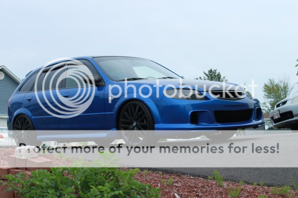

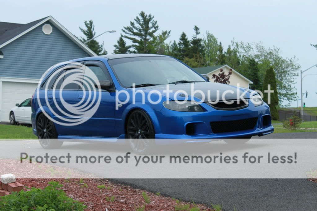

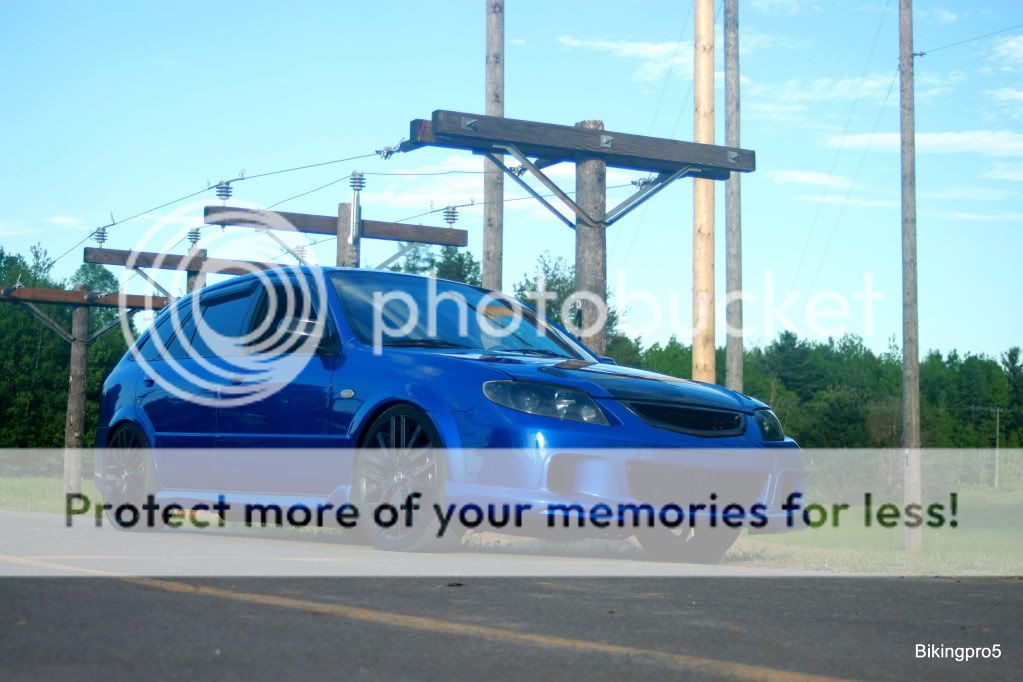

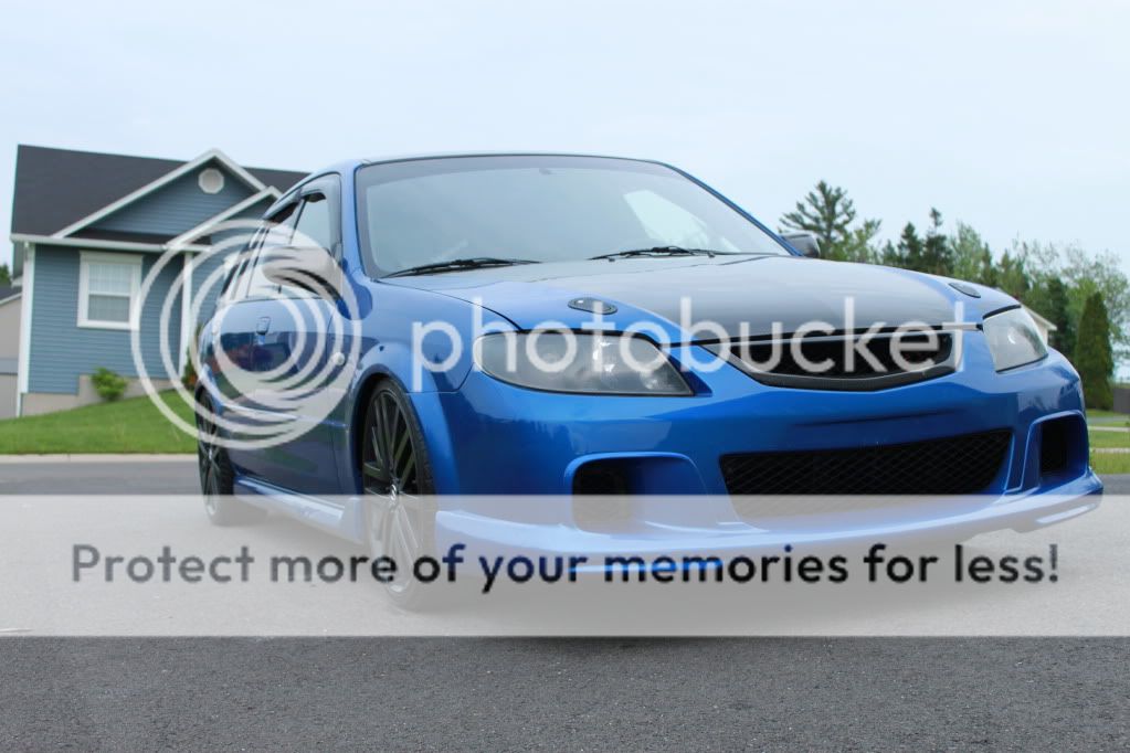

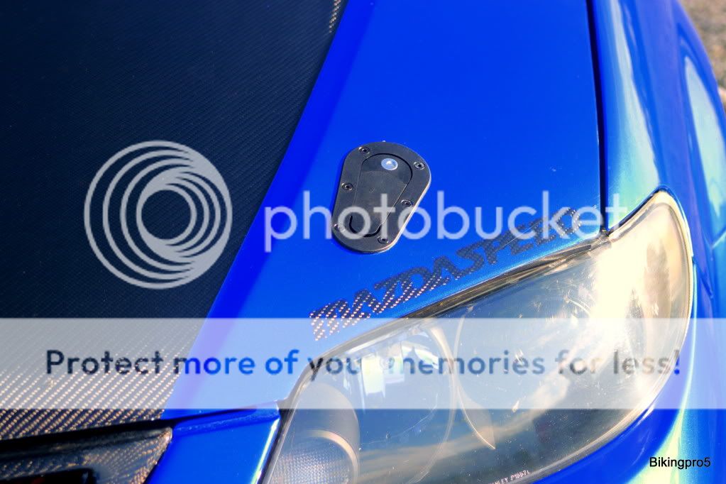

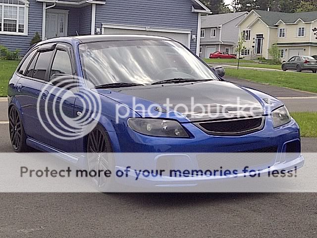

Looks great, with your headlight retrofit, have you done anything else to the headlights to make them look darker? Looks like you've painted the housing, the low beam reflector and the projector shroud, is that it?
I have Canadian lights so the shrouds were already black, i painted the shrouds and the low beam reflector with a low gloss black. Also modded the projector so it looks black when they are off. I also did a set for a buddy whose lights were the chrome and we kept everything chrome and they look good on his car.
Great little touch that many will not notice... I sure as hell didn't.
thanks, when you have all winter to think about how to build something many little things can be changed that people won't notice unless they really look.

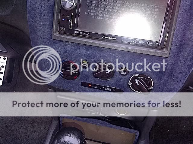

Had to remove my stereo over the weekend to fix the Bluetooth and add a few more options.. so while i had the car apart i modded the AC to work when i wanted it to instead of it automatically coming on with the defrost and other spots.

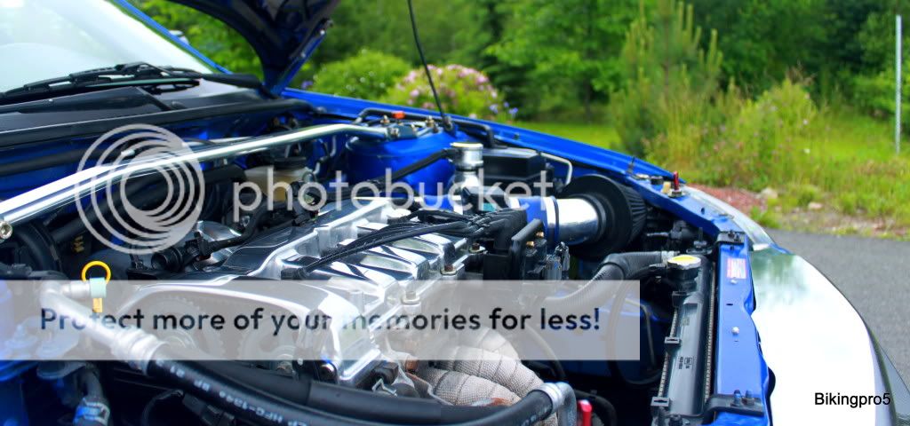

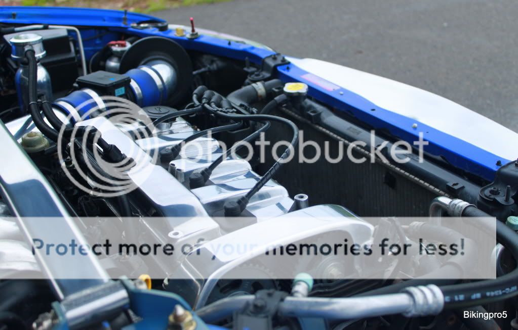

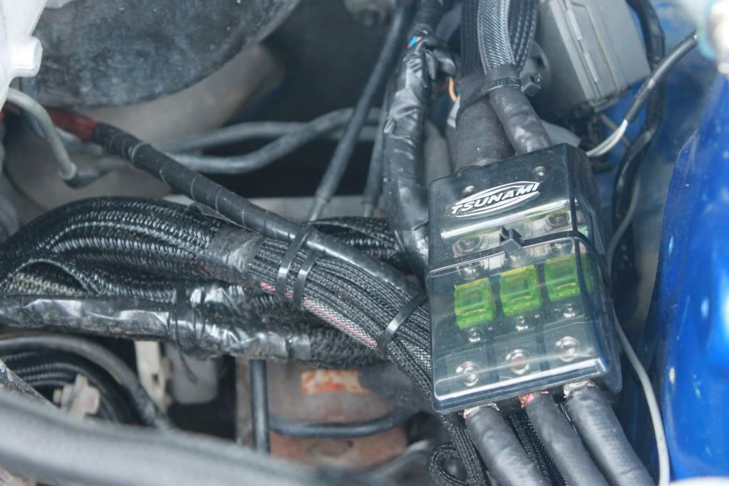

fuse under hood for battery relocate
all 4 gauge on one side, one wire runs from factory alternator wire, one wire runs to fuse box, new wire from alternator to fuse panel. Other side is the 0 gauge that runs to the battery and a 4 gauge wire for the power inverter under my drivers seat.
battery is grounded to the bolt under the side plastic pieces, all the paint has been removed to insure the best possible ground. the power wire is connected through a 200amp circuit breaker. Also off the battery is a fuse 4 gauge wire running to the 4ch amp under the drivers seat powering all of my component speakers.

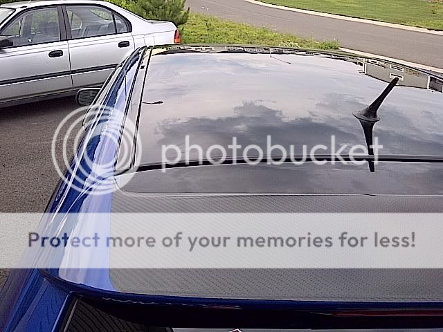

just put the CF spoiler back on, had to have it recleared since the first job peeled right off when they tried to buff it..
interior is done... and its a CF DGM spoiler with the sides painted, similar to my CF hood with the painted sides..

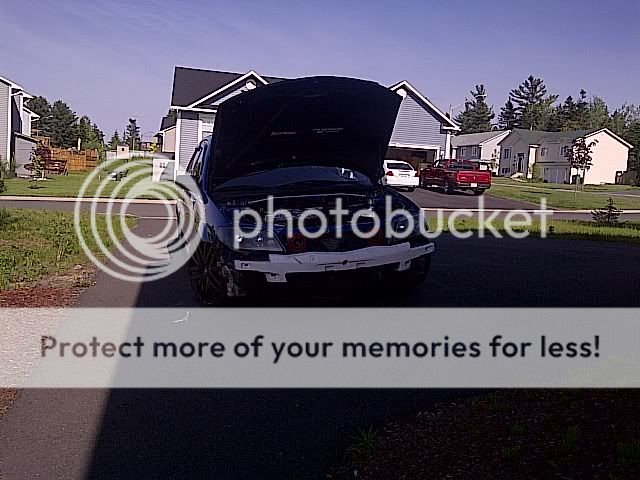

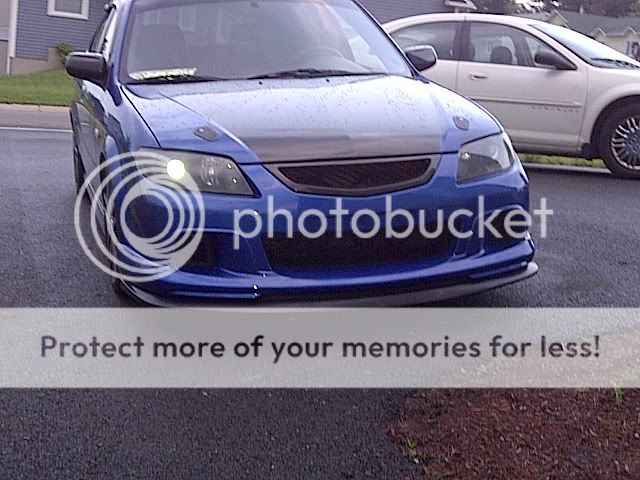

So after a lot of fitting and trying to get it just right the splitter is finally on the car. Still needs a bit of tape...
Cell phone pics, better ones will be taken this weekend...
