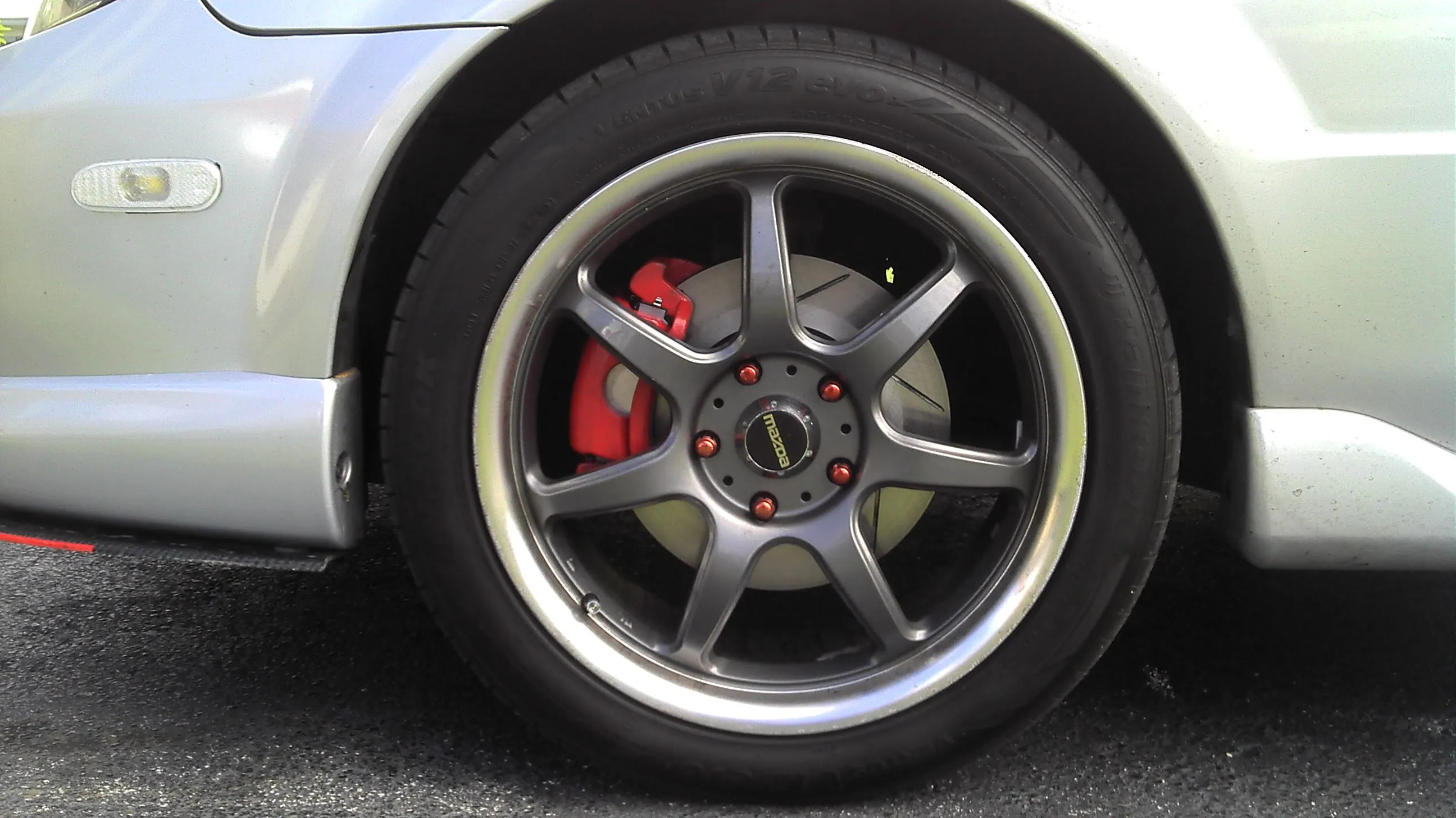

Yeah I know I need to wash it, and a daylight pic would be nice, but you get the idea. I only have about 1/4" clearance between the caliper and wheel. That's on the diameter and the front due to the offset of the oem wheels. Drove the 40+ miles to work this morning and stopping the car is now effortless as compared to the stock setup.

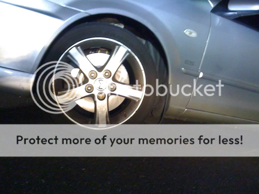

M6 calipers and power slot rotors installed this morning, looks great. Brake is softer.
