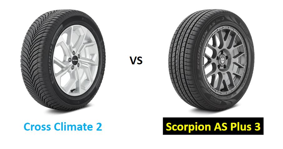

I know I've said this before but testing has shown that the Cross Climate 2 is not the best tire for rain because it lacks the usual channels to prevent hydroplaning. I'm not saying it's "bad", but the better all-season tires perform better in rain. But of course, not as good in the snow.
They have supposedly improved on that for the third version but you'll want to do some research to see how they compare to other options.

I've used the Conti DWS 06 previously and they were/are good tires. However, when I recently needed tires for our CX9, I went with the fairly new Pirelli Scorpion AS + 3s based on reviews and price. Have a little over 5k on them and no regrets. Getting good wear, quiet, good handling. You don't need the Cross Climates unless you have to deal with snow. Based on combo of price and performance, the Pirellis are tough to beat. Read the reviews.

These are the two tires I’d consider. I’ve never bought Continentals but the Pro and ExtremeContacts are highly regarded. We get occasional snow on our little Alabama mountain, so the CC2 three peak rating won me over on our RAV4. We’d be ready for a roadtrip to the Gatlinburg or something to see snow there too. We get hellacious rain and knock on wood I haven’t felt them slip or hydroplane yet like other tires I’ve had (stock Toyos on the CX-5, stock Yokohama on my old CX-5 and Goodyear ComforTreds that replaced those, stock Michelin eco tires on our hybrid RAV4). I’ll be getting whatever CC tire is available when my stock Toyos wear out.
You can’t go wrong with the CC2s or ExtremeContacts. Whether or not you’d benefit from the three-peak rating would be the deciding factor for me.
