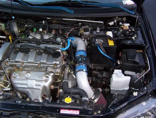

i have one of those...the best solution i found was to get a brackest from a hradware store that is about double the thickness from the one they give you... mount that from the air flow sensor to the engine, you will see where it lines up... mine almost wore through the tube before i noticed it so i repaired it with 5 minute epoxy... here is a general pic....the brace goes from the a.f.s., under the tube to the engine!!!
http://members.cardomain.com/joka1

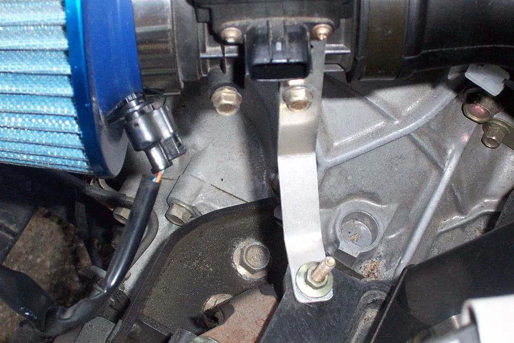

Here's a close up of what I did. For the Air Temp sensor I just drilled a small hole in the plastic ring around the base of the filter. Works like a charm.
