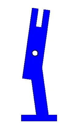

The hood on my car has always been rotated a few millimeters. It was bought used and a previous owner wasn't too good putting things back together so I figured this was just one more thing he'd taken off and not put back on straight. However I tried to adjust the hood and there just wasn't enough play after loosening the 12mm (painted) and 13mm (not painted) bolts which hold the hood to the hinges. Then I took a closer look at the hinges themselves and realized that they are both bent. Pardon my artwork, but both hinges look like the attached image, as viewed from the front of the car with the hood open. The total bend is only about 4 millimeters at the most extreme point. To see it clearly I had to put a straight edge up against the side of the hinge. I'll try to take a photo later today. The forward tips of the hinges are almost exactly where they should have been had the hinges been straight, but they're pointing towards the driver's side, and that's the direction the hood points too.

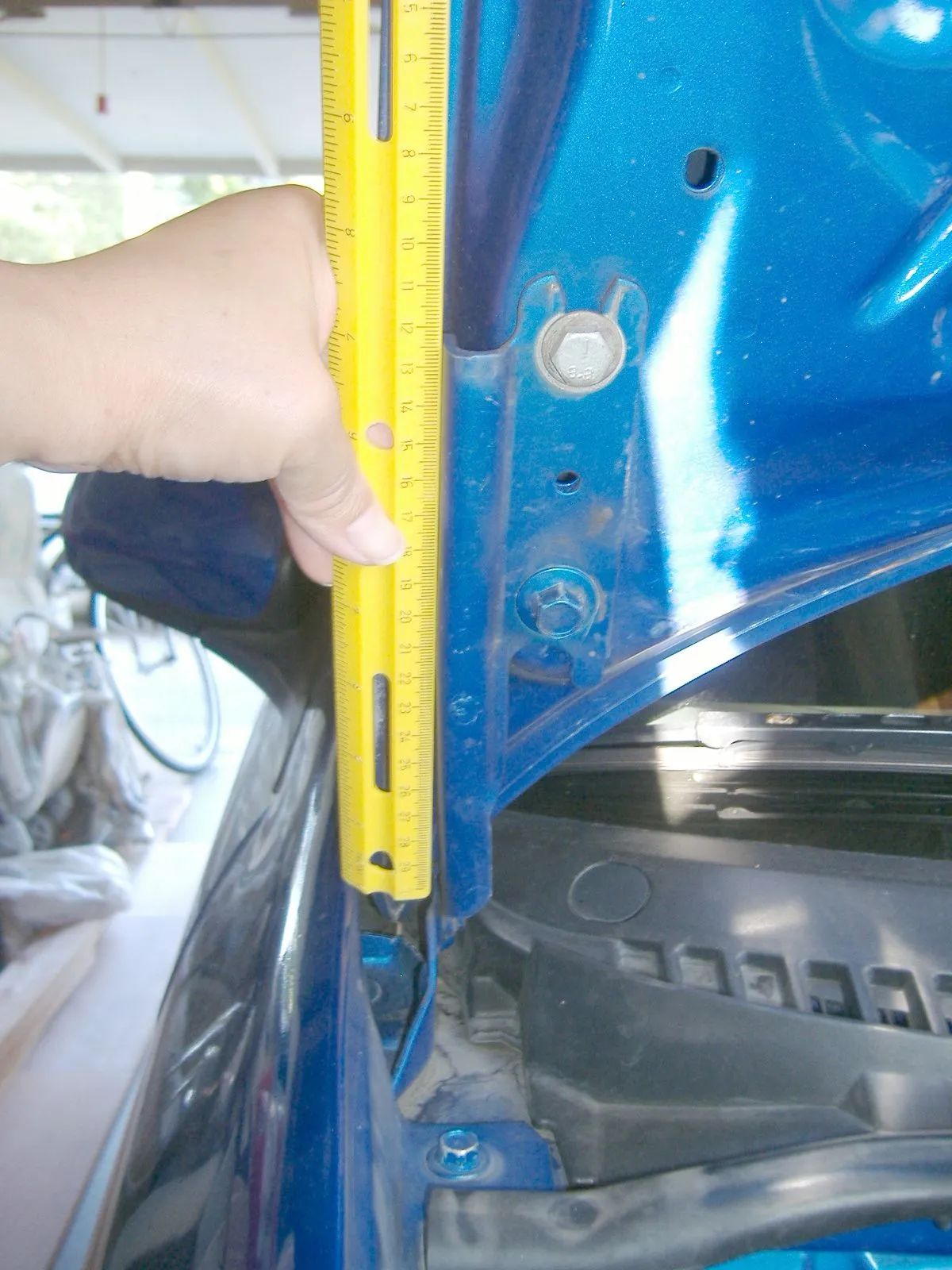

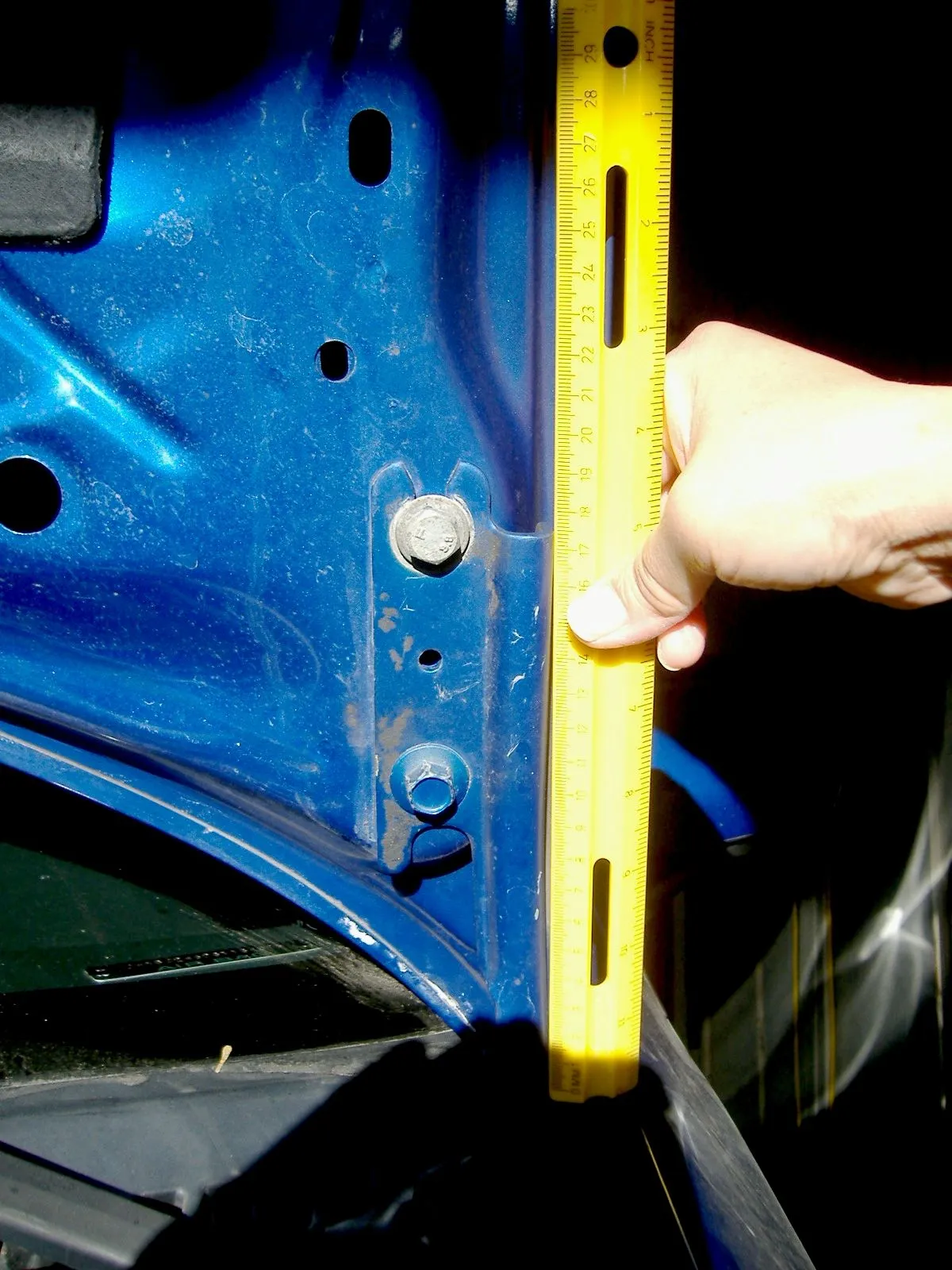

Here are the pics. My wife held the ruler while I juggled the hood and the camera. As you can see the bend is pretty subtle, just a few millimeters. Still you can see that both hinges are bent in the same direction: curved like a C with the open part facing the driver's side. Not too surprisingly the bend seems to be just below the lower bolt on both sides.
