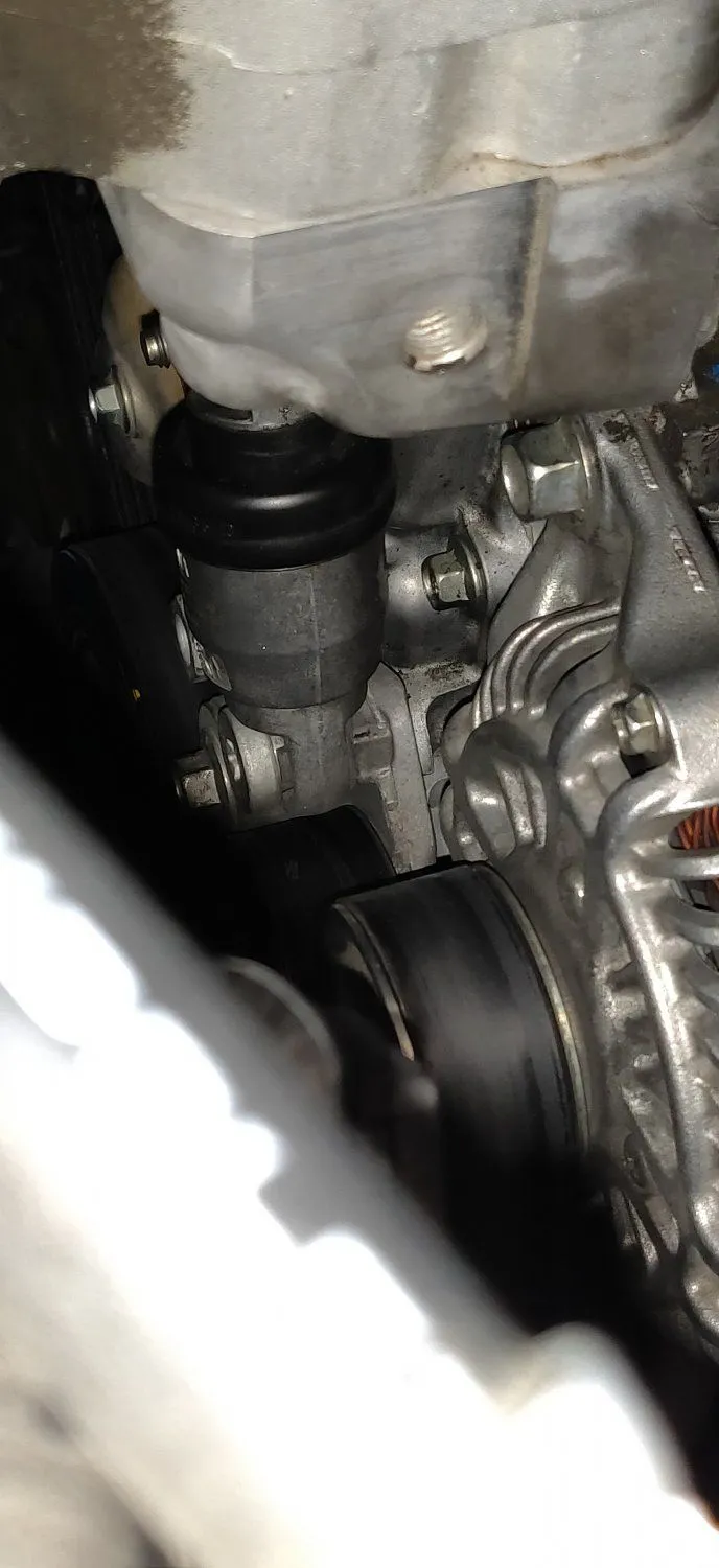

funny thing, I was checking two more cx5 with the same and exact Ina part no. as mine (that was leaking) and they dont leak. So its hit and miss.

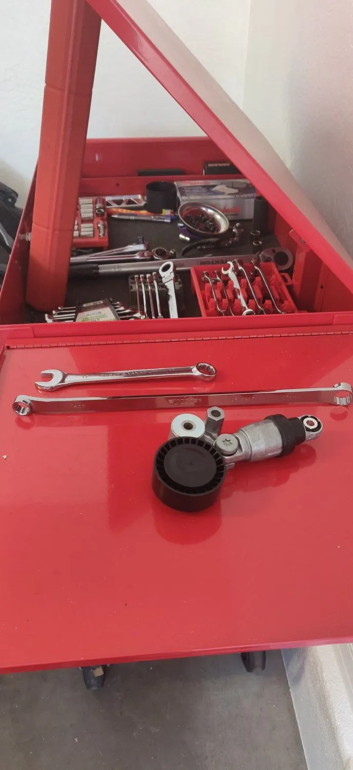

I used this tool to easily release tension from the wheel well https://www.amazon.com/dp/ (commissions earned). It's angled slightly at the ends and long enough to provide ample leverage. See how much longer it is compared to a regular wrench. Now I'm looking for a 12mm variant for easier ability to remove the 2 12mm bolts that hold the tensioner in place.

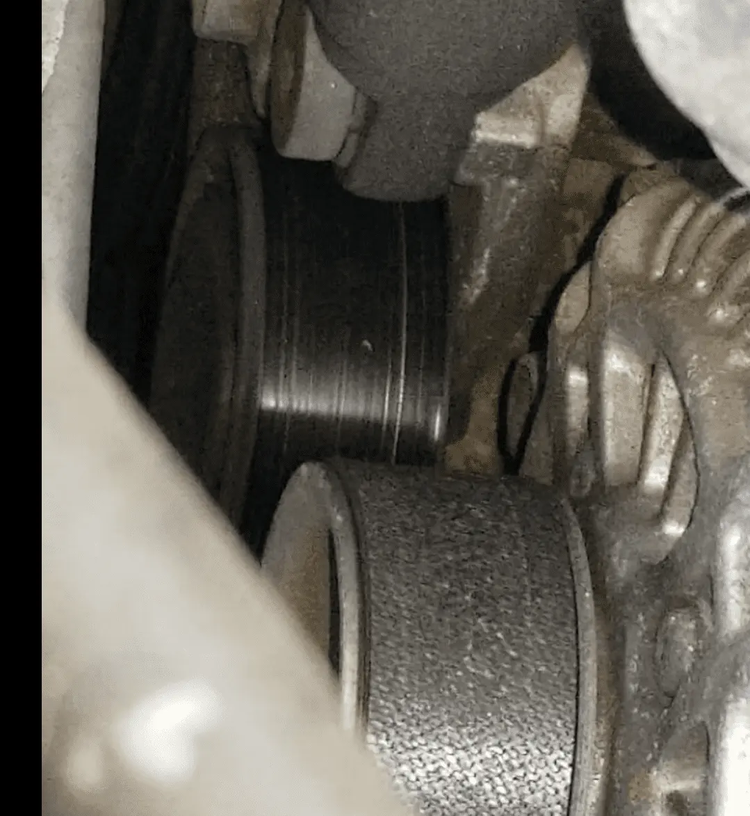

Water pump belt: I studied Felix Dan's video with the goal of developing a "lazy technique" to remove and replace that belt. I didn't use a towel and pulled. I merely too a sharp blade and cut it slowly. 20 seconds later it was off with little effort! Now the install. Where Felix used his finger to guide the belt unto the water pump pulley, I used a chrome wrench's open end for leverage to apply firm inward pressure towards the middle of the belt in between the big pulley and the water pump pulley. The Chrome wrench is smooth and allowed the belt to glide on its surface as I turned the crank. The belt soon stretched over the water pump pulley and made its way into the water pump pulley grooves.

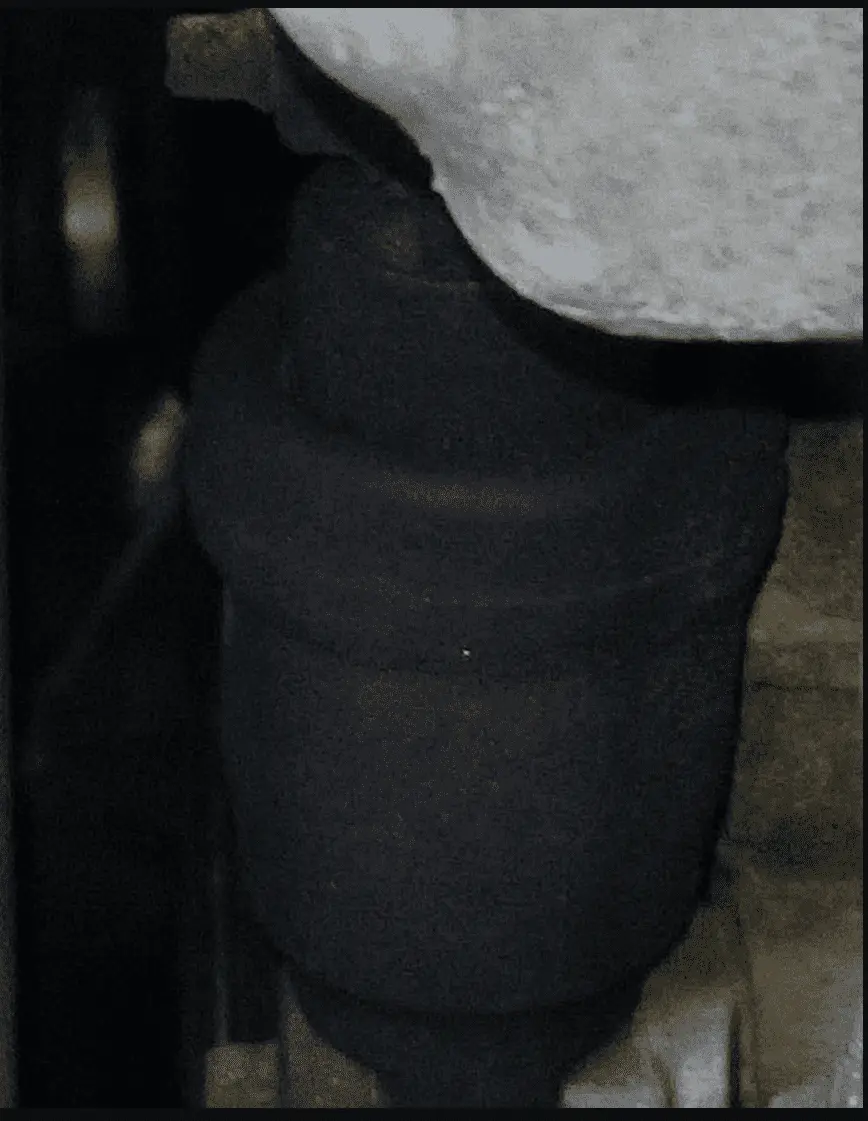

The belt tensioner on your 2013 CX-5 has amazingly lasted 120K miles. I wonder if you can see or take a picture of that long-lasting tensioner showing the part number and / or the serial number? What are the part number and serial number of that spare tensioner lying on the tool box? :unsure: See post #26.

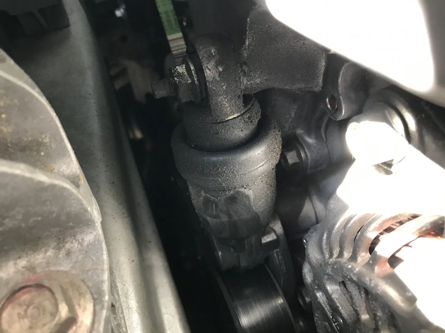

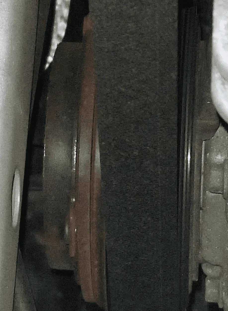

Here are some photos of my timing belt, not sure if it needs replacing. Can anyone else take a look?
I did notice some liquid on the wheel in the first photo though but I'm not sure if the tensioner would be the cause.
There’s no timing belt for your CX-5 2.5L. There’s a serpentine belt for AC compressor and alternator. A second stretch belt is for water pump. A belt tensioner on the topic is for long serpentine belt. A leaky belt tensioner looks like this on my 2016 CX-5 at 41,150 miles:

yrwei52, I kept the original tensioner in the 2013 there. I'm going for the record lol!!! It's in excellent shape. Aside from general dust it looks new. Is the original version too. I could not access to take a pic of the part number but pretty sure its the very first version. Perhaps its because its the 2.0 engine and there's less stress on it? So my backup spare New Tensioner is still waiting patiently in my tool cart:). I'm keeping a close eye on the revised tensioner in the 2.5l Mazda6. It too is still good.......for now. I highly recommend anyone to invest in a long reach 12mm and 17mm boxed wrench with slight offeset. You can also do a search for aviation wrenches as well. Sockets won't do good let alone fit down there.

I think I'm blind but I don't see any leaks in your photo unless you're referring to all the debris and grit that's stuck onto your belt tensioner. Otherwise, for someone that has never seen it before, it's hard to tell lol
My car has about 64k miles so I don't know if it's worthy of replacing it yet.
