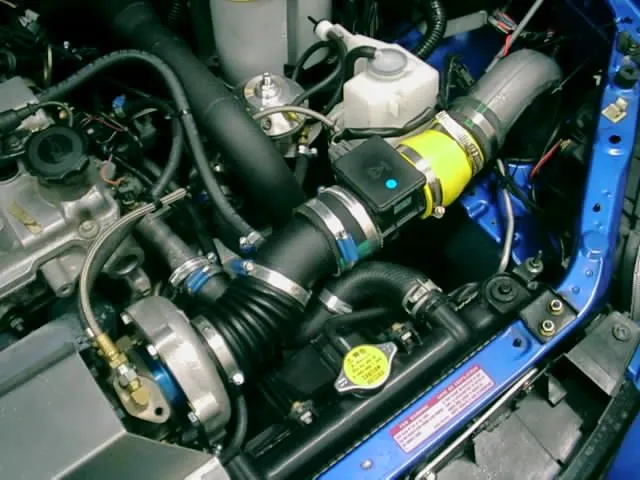

I added an CAI to the BEGI for $15.

The only reason I did it is becuase I noticed that keith mentioned he spotted a good location for a CAI in one of his post. I assumed he ment for the turbo kit. By this I thought it must be better to use cold air then air in the engine bay and for 2 hours and $15 bucks why not do it.

90 degree 2.5" exhuast elbow with a couplin to the MAF then it goes throught the hole that the radiator resevior covered. the resevior had to be moved and took the most time. the air filter attached to the end of the elbow by the wheel.
