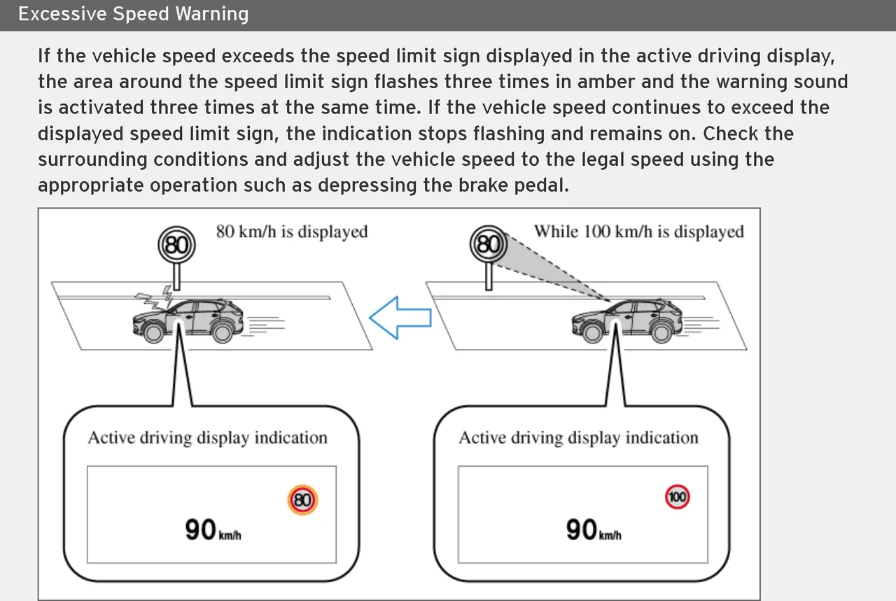

Hi! I experienced a beeping sound whilst driving that went on for about 20-30 seconds in my 2016 Mazda CX-5. No warning lights appeared. Read the manual but no warning beeps appear to correspond with what I was hearing. Any ideas anybody?
