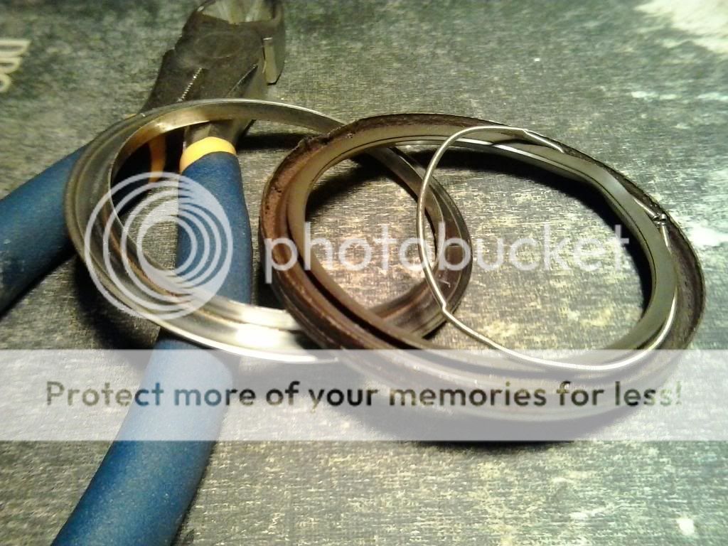

This is a picture of the old bearings seal. It is a much better design. The metal ring is press fit to the inner race and the rubber part is seated on the outer race. The entire rubber surface rotates on the metal part and there is a stainless steel coil spring to keep the rubber seal tight on the metal ring.
The rust did invade the old bearing eventually (it lasted at least 4 years,... since I bought the car) but it didn't fail until the rust swelled the outside of the ring warping the rubber inside and breaking the seal.
