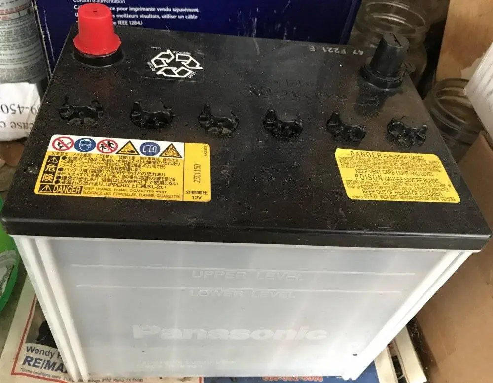

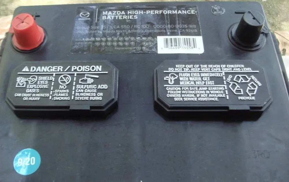

1. Like Mazdauser100 mentioned above, stock battery is a Panasonic battery from Japan which isn’t available in the US. It has white plastic casing with black top and here’s the picture:
Depending on where are you located, the car battery in our hot north Texas usually lasts 4 ~ 6 years. Remember US 2016 CX-5 came out in Feb. 2015, your stock Panasonic battery is more than 6 years old, most likely is due to be replaced.

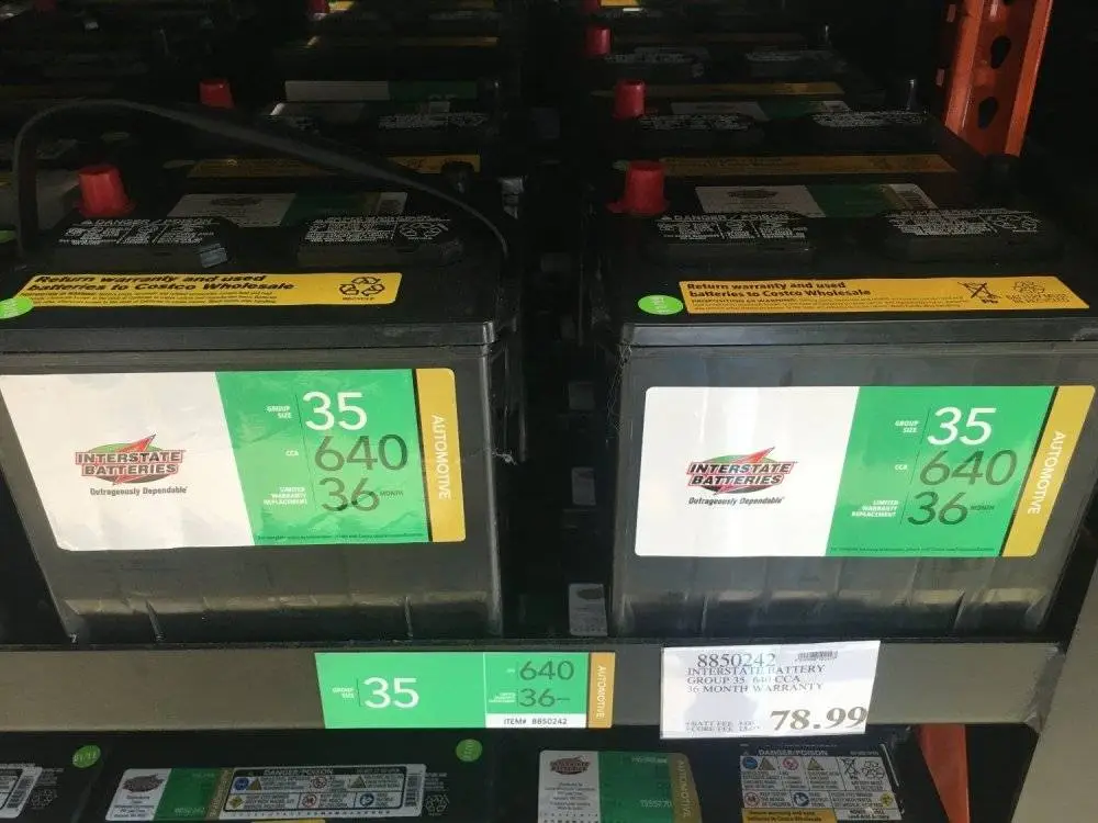

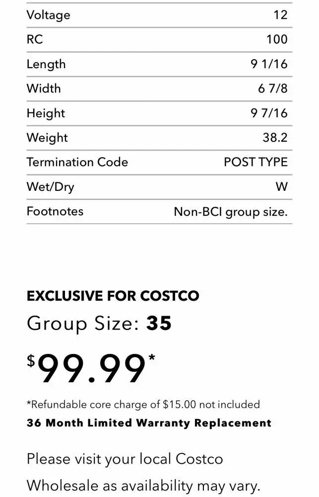

3. Since you do have Costco membership, go to Costco and get a Group 35 Interstate battery:
$78.99 is the pre-pandemic price, right now it’s $99.99! You have to install Costco battery by yourself, and make a second trip taking the old battery back for $15 core charge refund.

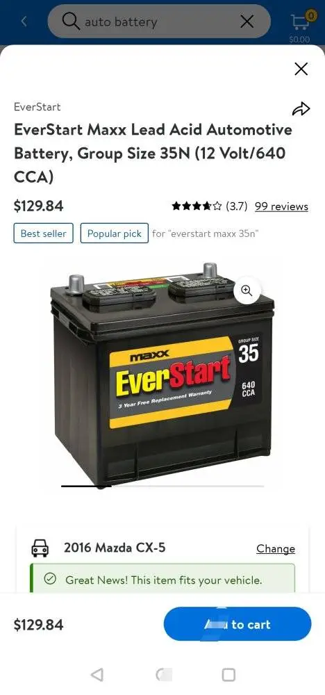

My car model is 2016 CX 5 touring AWD.
When I am searching Walmart there are many EverStart $129 range.
In Costco it's showing 26R/540/36 for $88.99
So I am confused .am I looking at Correct item ?

Group 26R is a bit smaller than Group 35 battery, both will fit CX-5. In fact, Group 35 battery is still a little shorter than stock Panasonic battery. The CCA on Group 35 is 640, but Group 26R is 540. So you really want to choose Group 35 battery over Group 26R battery. BTW, the rollback price $88 on WalMart.com showed up again when I just searched it.
BTW, at WalMart, other than size、CCA、and price differences, Group 35 EverStart Maxx battery carries 3-year free replacement warranty, but Group 26R EverStart Value battery carries 1-year free replacement warranty.

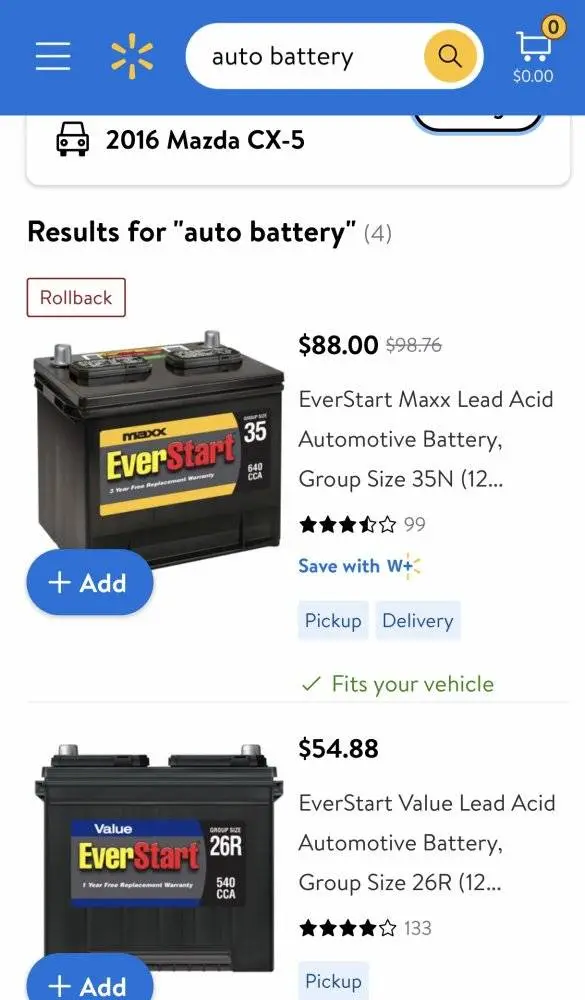

Looks like my Walmart is jacking up prize 😐😐😐. Problem of being in California I believe 🙄🙄
Ha, must be because the lead-acid battery has too much hazard material for WalMart in California to handle?
I’d got a couple of Castrol Edge 0W-20 oil 5-quart jugs at San Jose WalMart several weeks ago, the rollback price is the same as online and in Texas though. And the price on Group 35 Interstate battery at Costco is the same between San Jose and Dallas too.

I've had great luck with Costco batteries. They have full 3 year no questions asked replacement warranty. I just pull from vehicle and take with me so I don't have to make another trip with core.
Looks like they have different (lower price 98.76 at Mountain View CA, Walmart) when using mobile app. Seems like varies by store. Actually, same price using desktop browser also. So price seem to vary by store.

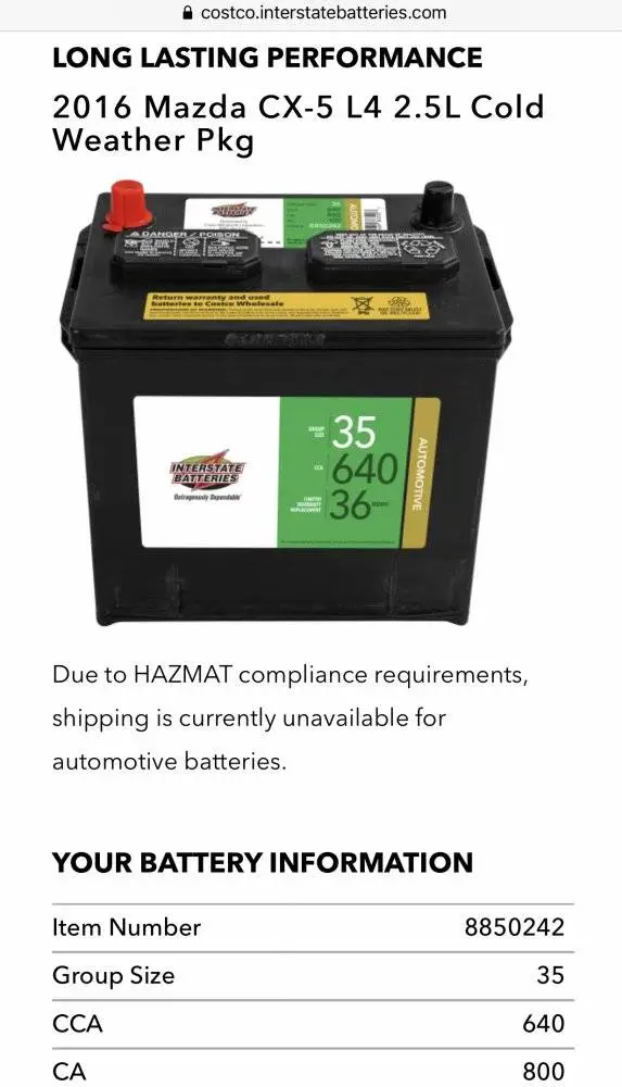

-I don't know why I am not seeing this item in Costco online. Is it available only in store ? If you have online link, please give

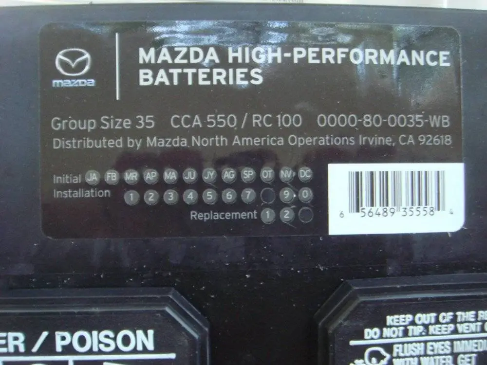

- what is dealer price on the original battery ? Should I check with dealership ?
dealer price is up at 170$ msrp or 120$ if you manage to get the discount.
Due to HAZMAT compliance requirements, shipping is currently unavailable for automotive batteries.
Costco Interstate Batteries Search Results
The OEM Mazda High-Performance battery sold by Mazda dealers is made by Intetstste with 550 CCA (NOT Panasonic) and the price is $120 ~ $170 as cz5gt mentioned above. I paid ~$120 15 months ago.

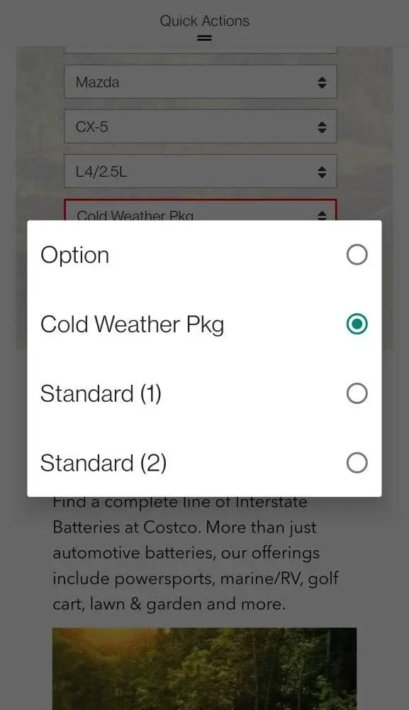

While searching Costco.com, it's showing these options. I should select cold package right ? If the price is same as store, I can just order online and return old battery to store right?

While searching Costco.com, it's showing these options. I should select cold package right ? If the price is same as store, I can just order online and return old battery to store right ?View attachment 306524
For some reason the Interstate battery website for Costco is asking non-existent “Cold Weathrf Package” option when we selected CX-5. If you select “Standard (1)” and “Standard (2)”, you’ll see Group 26R (540 CCA)、Group 35 (640 CCA),and Group 35 AGM (650 CCA) 3 diffrtent batteries. I’d choose Group 35 standard flooded battery with 640 CCA for the best value.
Since shipping a standard flooded auto battery is not possible from Costco, you have to go to a local Costco and pick up one, install it by yourself, then return the old battery for the core charge; or just find a ride taking the old battery with you and complete the purchase / return process in one trip.
Or go to WalMart and have them install a new EverStsrt Maxx Group 35 battery.
