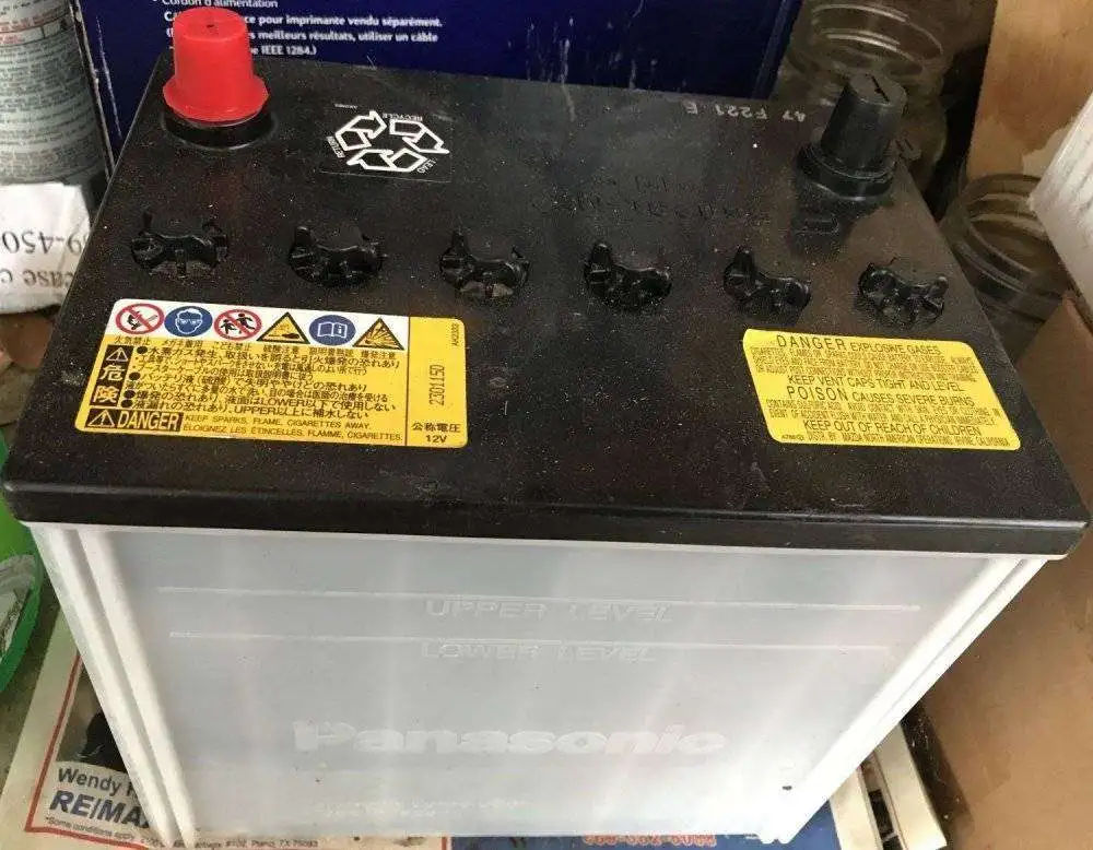

You have a 2018 CX-5 if your battery looks like this:
You still have the Panasonic battery from factory. It’s time to get a new one.
You can go to any auto parts store and let them do a “load test” checking out the battery performance before you make a decision to replace it.

After 4-5 yrs, I would replace it.
Don't want to take risk getting stranded somewhere.
