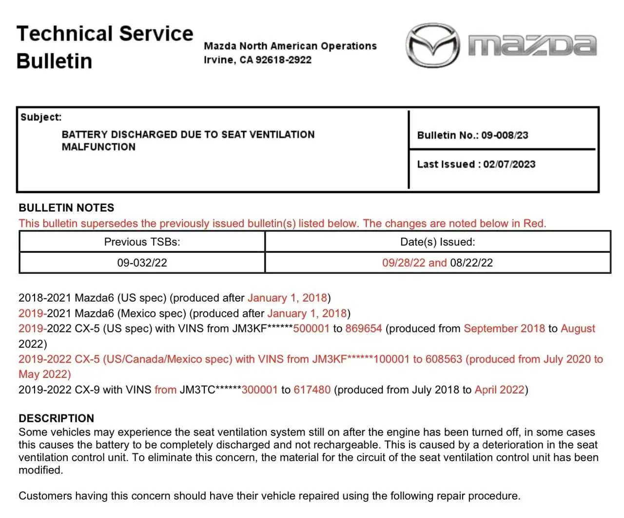

Just found Mazda has a new TSB.
Adding it here in case other folks start to experience this in the future.
Seems the vent seats computer is flawed and has to be replaced.

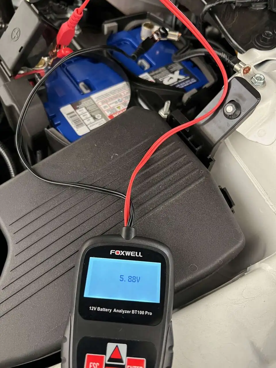

When my battery went to 6V it got me curious what is going on and started digging.
I have the 2nd cx5 for 8 months and never had issues but I also didnt use the ventilated seats much until recently.
Thankfully its a deep cycle AGM so it survived with a recharge after.

The problem is the seat warmer/ventilation control unit. Replacement is with new unit which is under passenger seat.

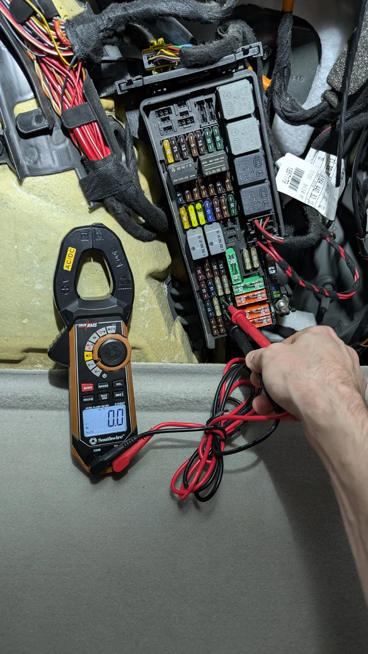

buy a cheap clamp meter and measure Amps draw.
Open hood, close doors ... wait 15-20 mins and measure. should be very low...otherwise something is sucking battery dry :)
if its the seat unit, disconnect and measure again. Its easy. it can also be left disconnected if that is the problem but could be other things.What year is the CX5?
