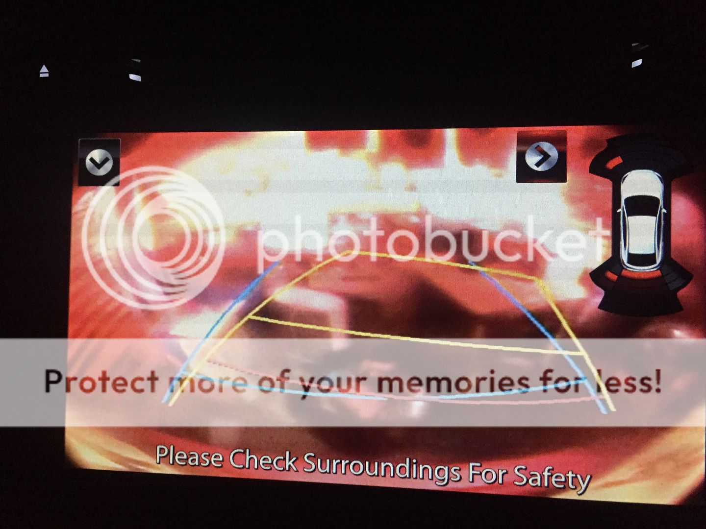

Trajectory lines from back-up camera on CX-5 are available in other regions for many years. Mazda just chose not to offer this feature to US customers. And I don*t believe you can add this feature by a software update as it*s a integrated system with infotainment system and front / rear parking sensors.
Here're factory integrated Front and Rear Parking Sensors and Back-up Camera with static blue guidelines and dynamic yellow trajectory guidelines on a Euro CX-5.
The front sensors are integrated into the rear camera so it generates an image of the front and back sensors on the screen that drops out at about 3mph. Cars with HID headlights must have headlamp washers but not LEDs, don't ask me why!
The parking sensors show up on the rear camera screen too but no headlight washers and no rear camera washer as you can see!
The front sensors come on automatically immediately after having reversed OR they can be manually operated from a button on the dash. When you drive off they go off at about 5mph or you can push the switch again.
