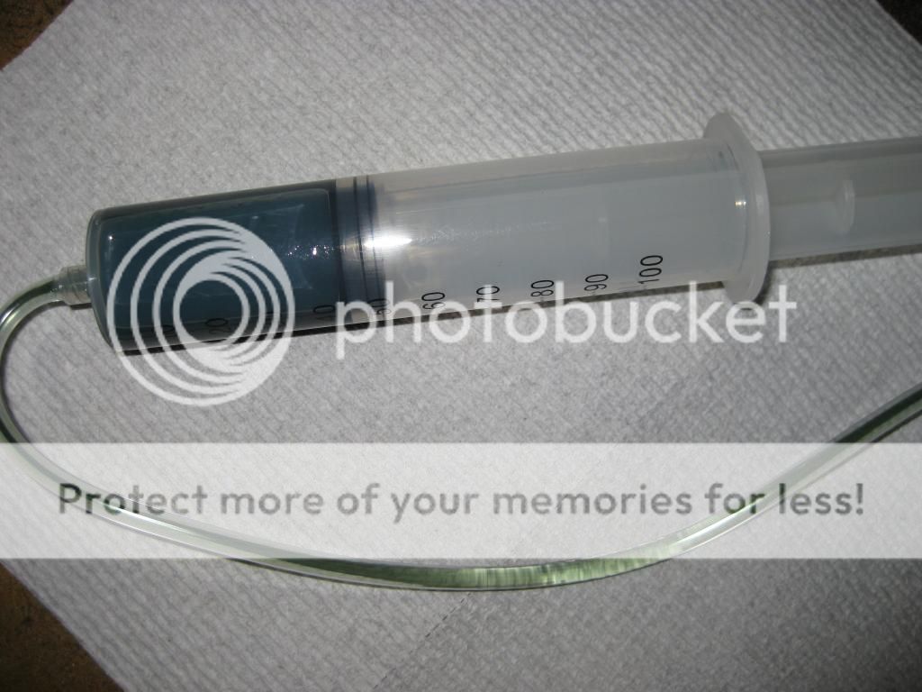

Anyone have any thoughts on why my transmission fluid is clear versus the reported blue color? I wonder if the dye isn't being put in the fluid since they believe most will treat as a lifetime fluid on an item that won't ever be serviced?
Seems really strange to have clear fluid. Having a clear fluid might make it hard to identify should it ever leak.
Don't worry. You can't tell the color by the little bit of fluid on the dipstick. I checked the ATF in my 2014 Mazda6 and thought it was clear too, but then I drew some out with a syringe and tube and it is the blue ATF FZ.
IMG_4271_zps35f9d0bf.jpg~original
IMG_4274_zps520851c3.jpg~original
