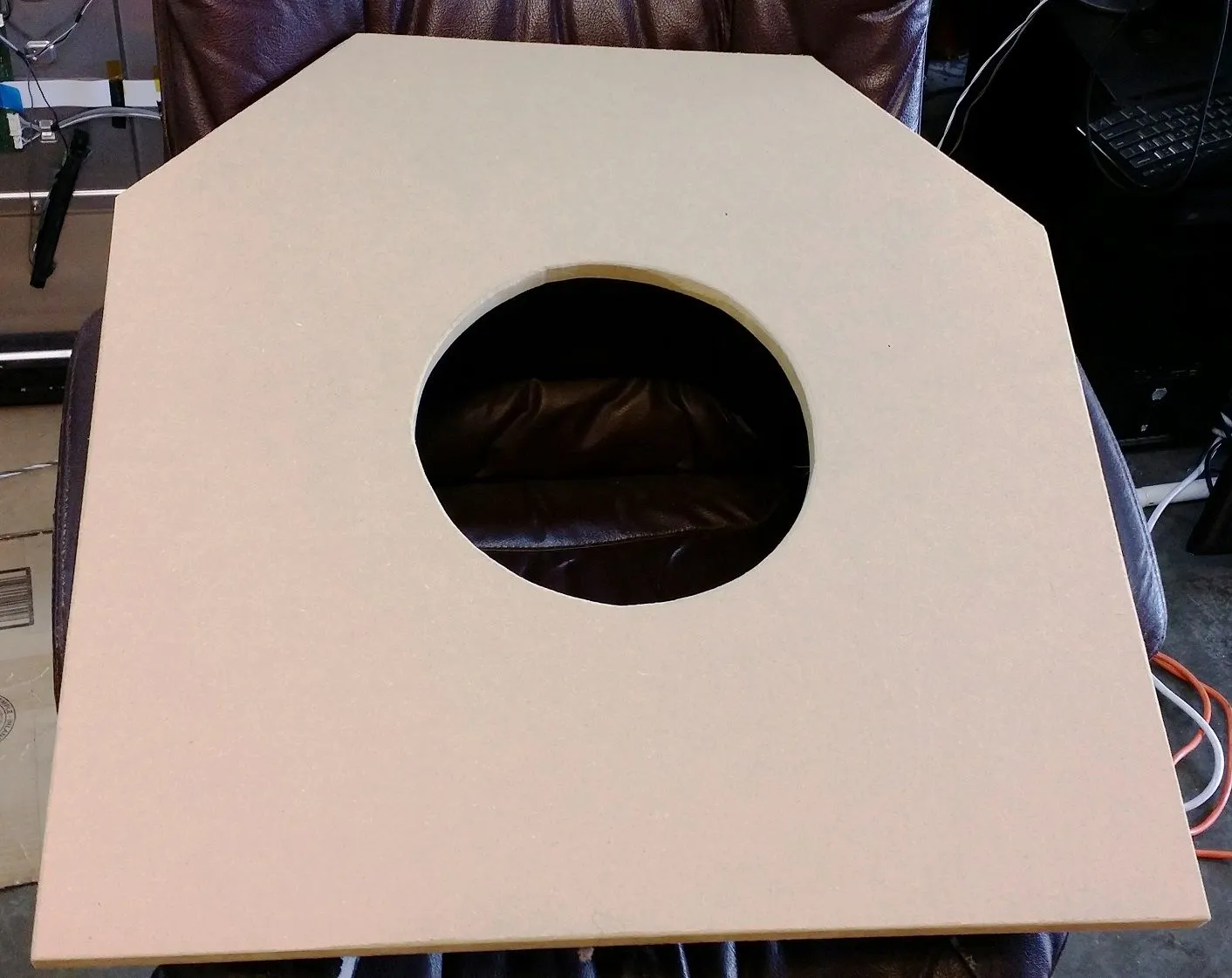

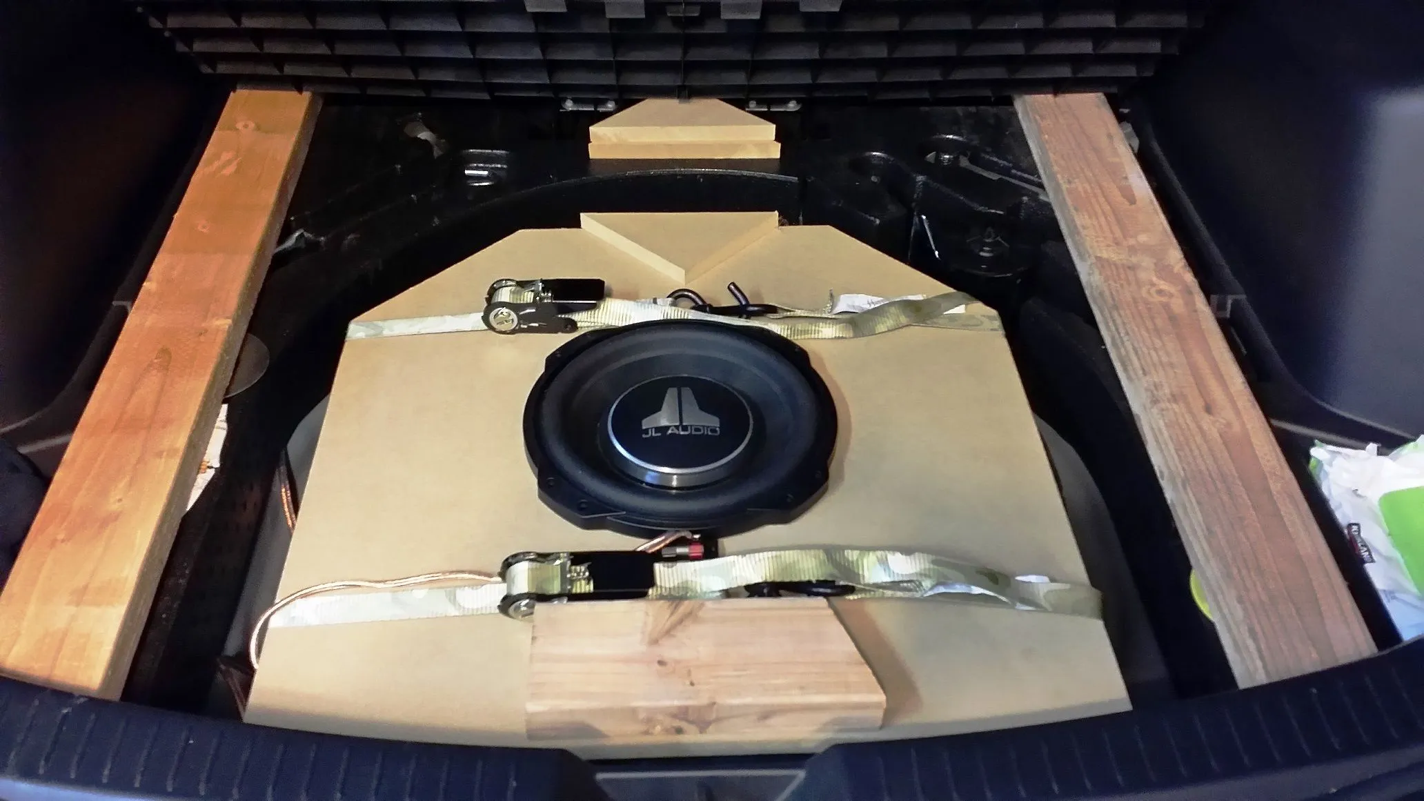

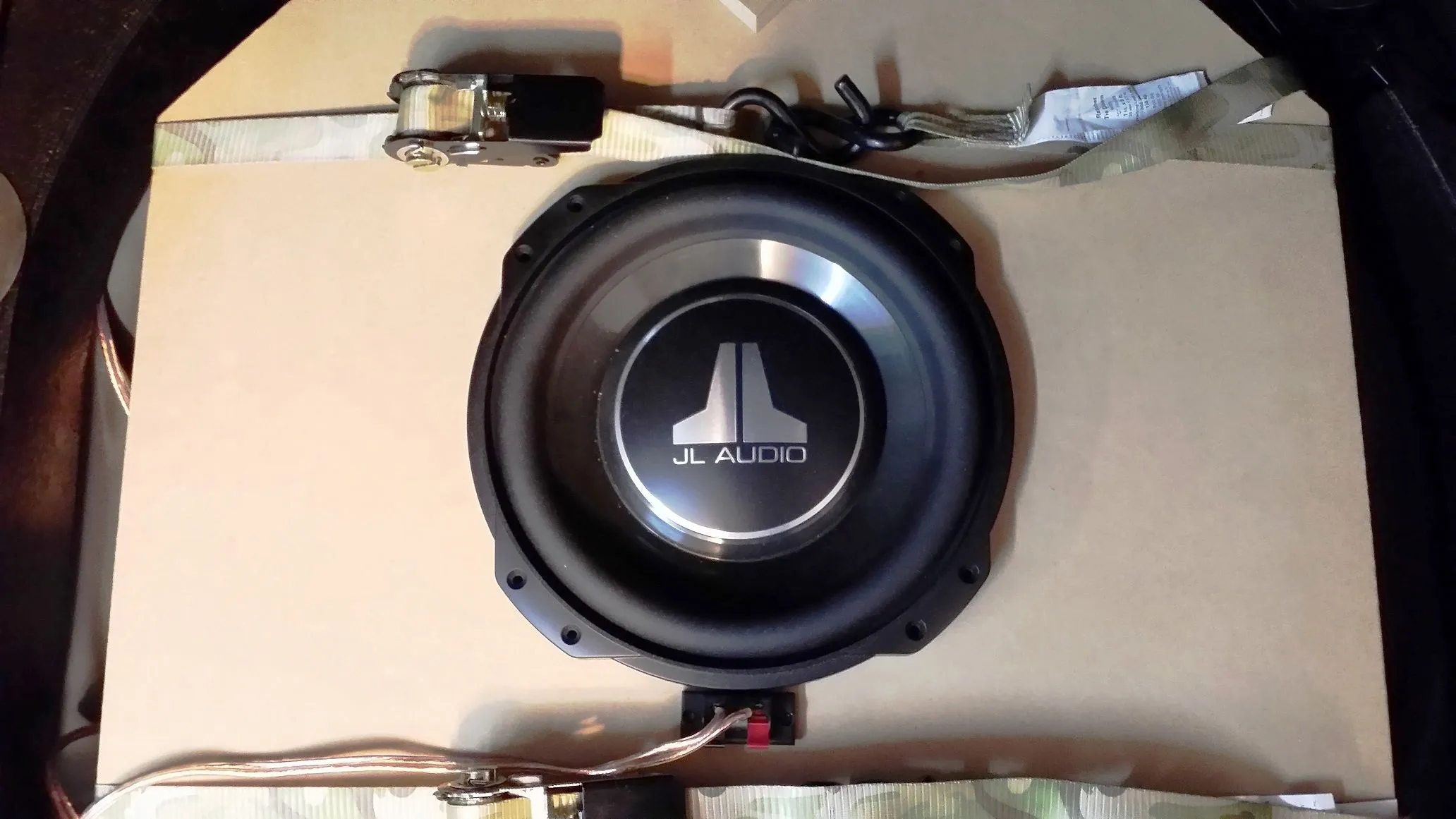

I have a 10" JL Audio shallow sub, in my spare tire. Installed it on a 3/4" MDF and strapped it down, with tie down straps.

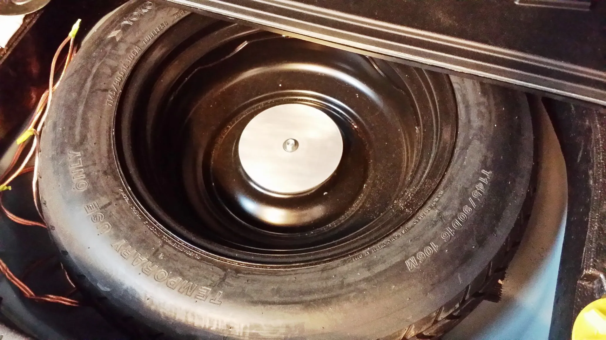

Course I had to seal the holes of the spare wheel, with a 6" rubber seal and a 6" aluminum washer. Bolted everything down, to the bottom of the car. Also added a wrench to the tool kit, in case if I need to use the spare.
Sounds like a sweet setup! Do you have pics of he sub setup in the spare wheel? Would love to see it!
It is ugly, but it works great.
If I had to do it again, I would use a 1" MDF. It starts to bend, after a few years.
Picked up the MDF from the Depot for $12. $200 was the brand new speaker, from Craigslist. $40 broken amp(Polk Audio PA880), that I have repaired. Same for the 4 channel, got it from the Bay, for $40, repaired and it is working great. Polk Audio PA660.
This setup, raised the floor, by 1-1/2-2". I have the grill for the speaker, but I ended not installing it, because that was taller, than the 2x4.

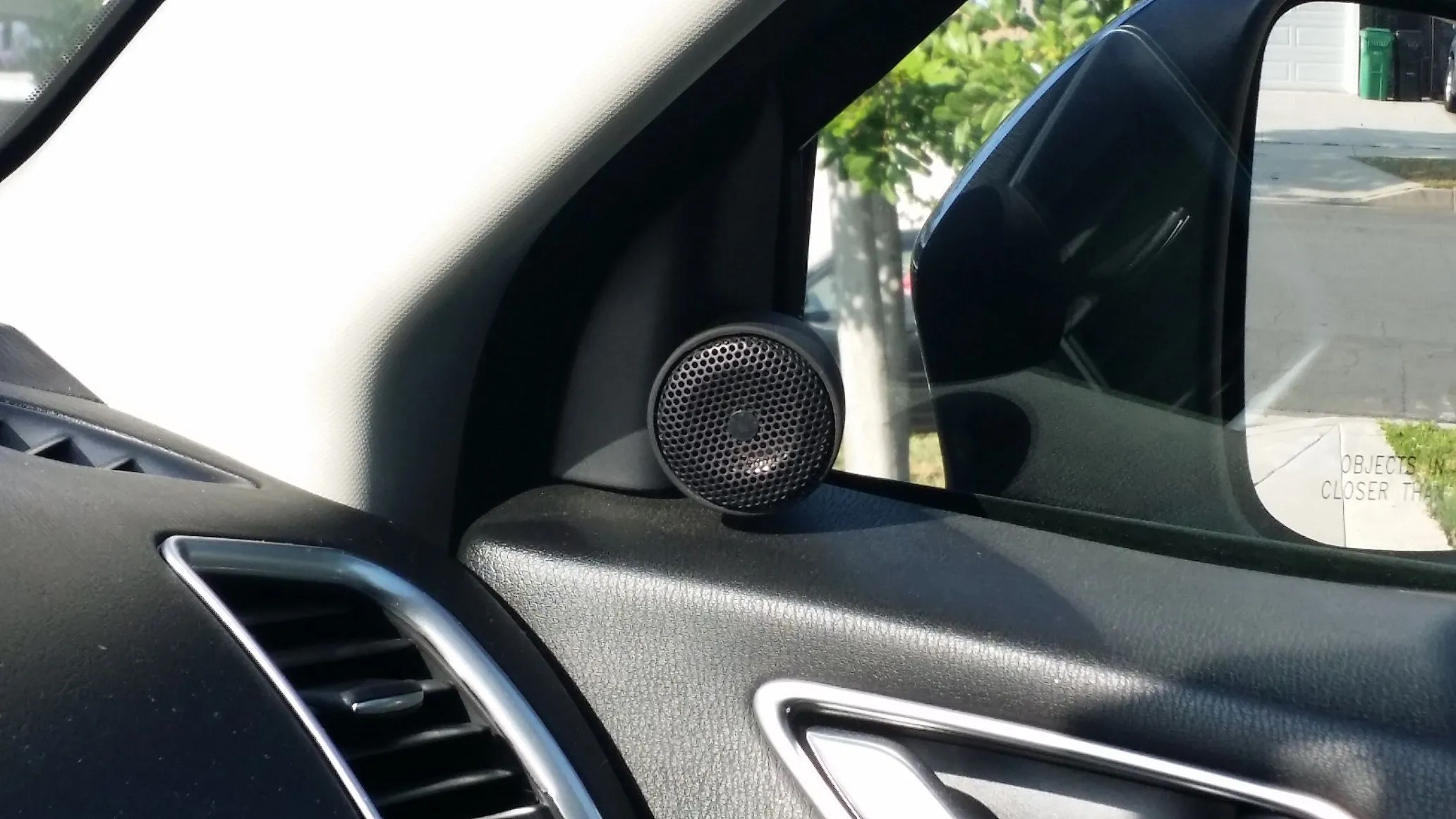

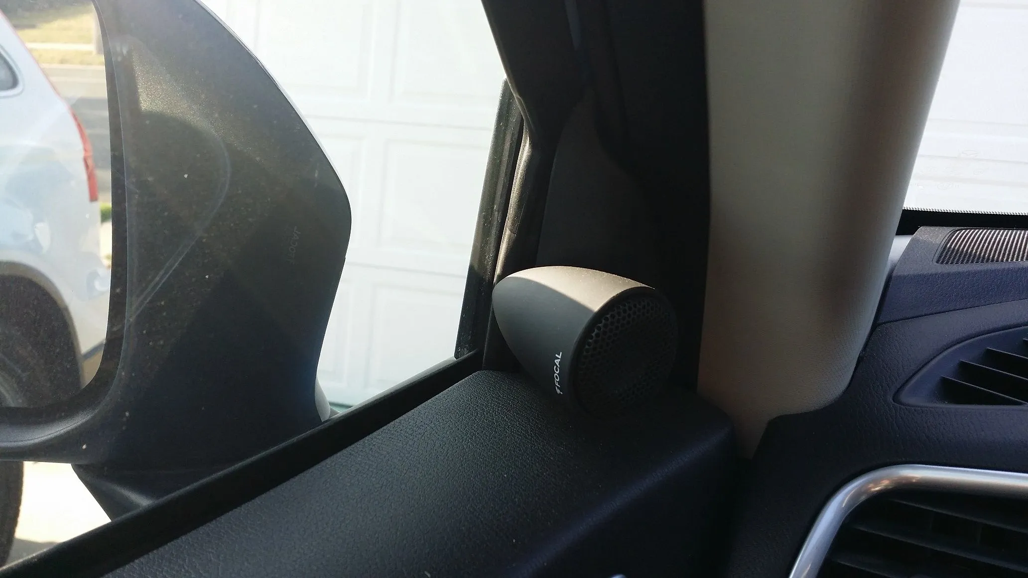

Tweeter's spots.

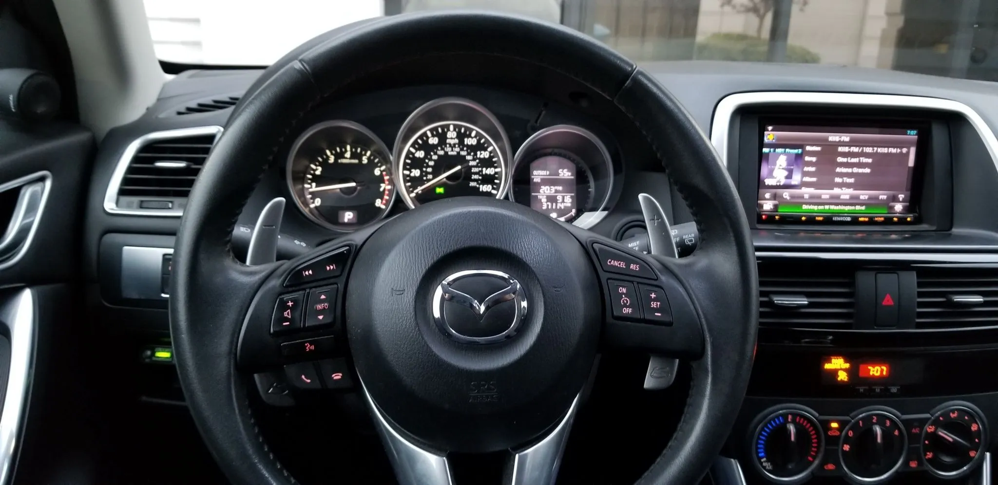

Kenwood DNN991HD

Thanks for sharing your setup! Quick question - does that head unit integrate with steering wheel controls and backup camera? The OEM unit on mine drives me crazy with its slowness and poor iPod integration and Ive been looking to swap it out
It does, but this unit is slow to startup as well. I have installed a newer 6.1" screen Kenwood, for my wife (DNX573S) and that is much faster unit.
The DNN units are Android based units(no Google Play store in these).

Crutchfield will only list tweeters as a direct fit the the dash location of the non-bose CX-5. This is due to the mounting depth limitation(s) present in those locations.
Any 3.5" speaker is going to be (too) deep and you will hit stuff/things when mounting a 3.5" in the stock location. The tweeters that reside there are only like 3/4" mounting depth, if that, and most 3.5" are twice that and a bit more.
I recently installed some Kicker 3.5s in my dash and my post is in this forum.
Since you have a budget, what is you overall plan? What do you want the sound to be, or how do you want the sound stage to behave.
Modest speakers with modest input power should deliver a nice boost in overall sonic volume and possibly clarity. The mounting locations will be your biggest achilles heal unless you have plans to do custom a-pillar or sail panel (tweeter) installations with a set of separates.
