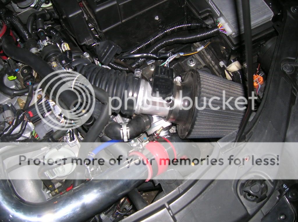

This was the most work i have ever had to do to install any FMIC.....granted all my other cars had side mounts and may have been easier to route the piping this kit was ridiculous.....first of all they sent me the wrong BOV flange i got a flange for a HKS SSQV when i should've got a stock flange.....i had to pay 60 bucks to get the right flange welded on (i choose to do that rather than waiting for the right pipe).....the kit came w/ absolutely no instructions....NONE....i got the larger 600 HP core so i knew cutting would be involved wasn't worried about that.....there had to be major modifications to make this work.....the pipe coming off the throttle body interferes w/ your shifter lever....you have to turn the shifter weight backwards and even then you can't get into first, third or fifth gear....so i had to heat up the pipe and bend it about an inch to get some clearance there....the plastic under the hood has to be cut and the rubber has to be removed....And the cp-e CAI will not work w/ the ATP front mount.....i tried every possible way to make this work but to no avail....i ended up cutting the maf sensor of the cp-e intake and connecting one side to the cpe filter and the other to the stock hose that connects to the airbox or whatever....pretty much a homemade intake.....enough talking here go pics.....

Homemade intake....

that's cool i have no clue what my afr's are but i'm gonna get tuned next week so i should know......i'm happy w/ the FMIC too except all the work*......but the car feels real good spins right through second and sometimes into third......i can't wait to get my TBE later on this week or early next week from Cpe.....oh where did you get your cobb intake from everyone i know of is backordered....i need one bad now i hate this homemade intake i concocted 2 get to work lol....
