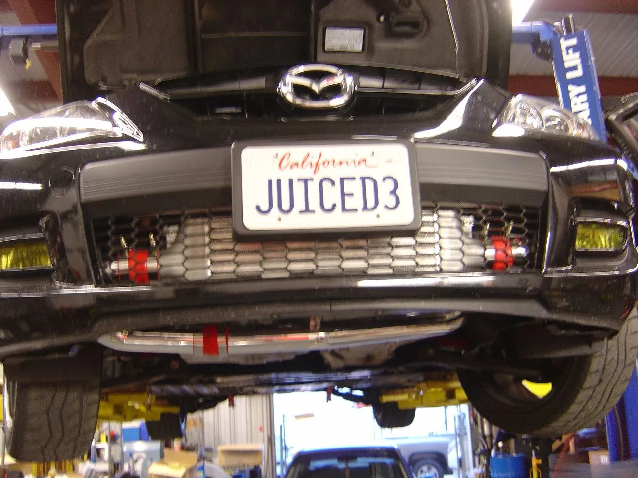

ATP Front Mount Intercooler....
because i was under the impression that i could keep my cai.....lol.....which i couldn't so now i'm pissed but i do feel the power increase i ordered the cobb sri cuz i can't run a cai nemore and i got the atp inlet pipe....

looks good man....how does it feel?.....mine felt a lot faster actually.....and S t r e e t u n i t has the intakes
that just a teaser....car is still at the shop....getting a tune tomorrow....atp turbo inlet / intake is going in tomorrow as well....too bad still no upgrade fuel pump yet....hope it will go well......

yeah after its on i like it, only took about a hour to have everything on then another couple hours moving clamps and adjusting to get things just right! the main issue came with the inlet pipe and intake. i had a question as to were the core mounted and emailed atp had a response with a better picture in less than a hour!
mine went on without any bending pipe and fabrication work.... im getting the atp turbo inlet and their High Flow Intake Extension, MAF HSG And Filter Kit as well

i mean to each his own....it was a lot of work but in the end i feel like it was worth it....i didn't run into any problems that couldn't be fixed....the car is running way better than it was b4....i am kind of disappointed w/ the lack of instructions but it's nothing that can't be figured out.....i like the intercooler kit overall once i get my intake situation resolved (cobb) and cpe sends my tbe i will tune my car w/ the standback and c how powerful it is...
