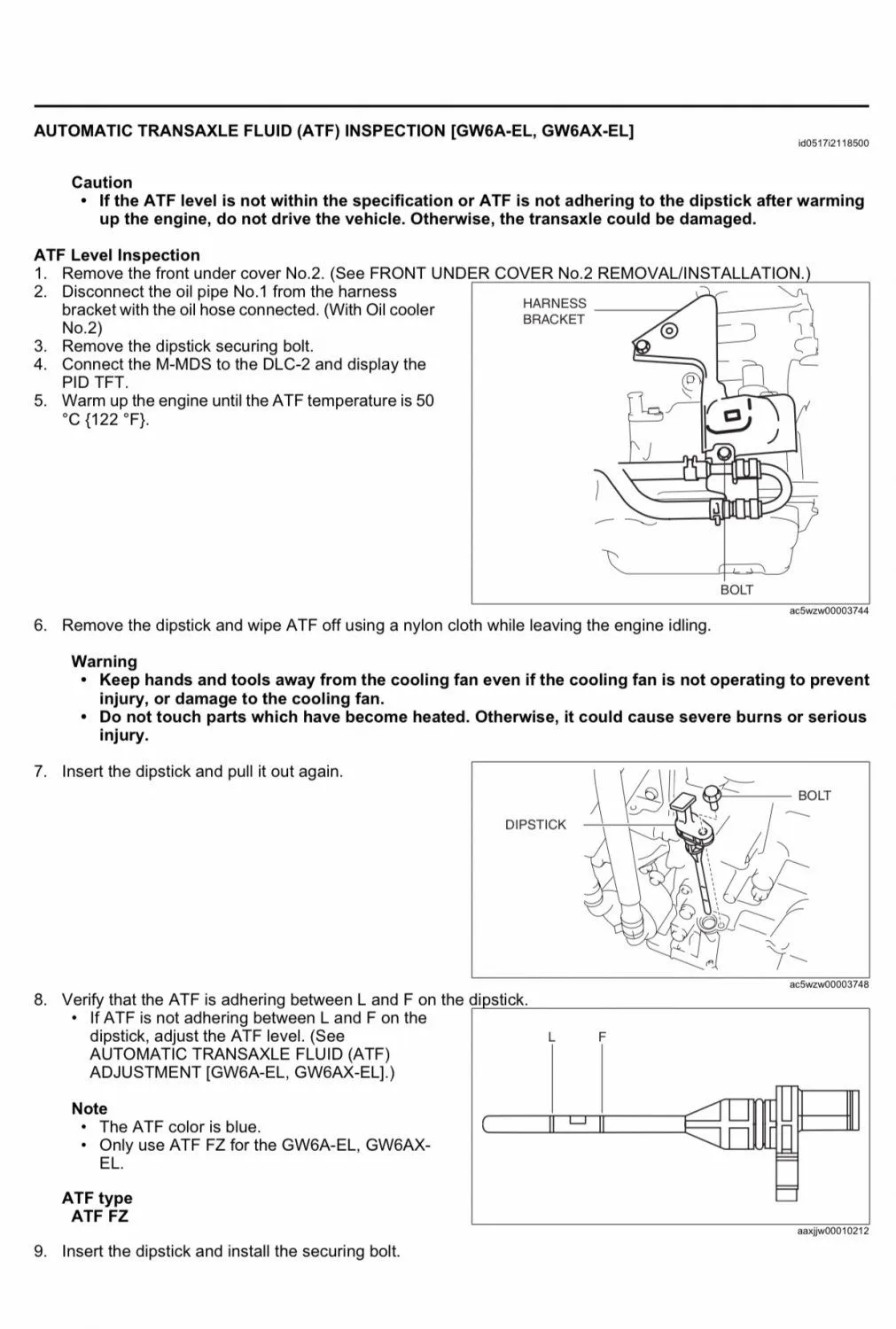

So you read the dipstick with the car shut off? I thought you had to do it with it running.
how many times did you have to remove and install the air cleaner, or did you pull the stick from below?
I don’t plan to pull the pan this time. I will be doing it at around 40k.
⋯ Hardest part is going through the whole motion of getting the car warmed up/shut it off and read the dipstick as the dipstick is wildly inaccurate once the car is off.
Wait, the ATF level is measured when the engine is idling with ATF temperature at 122°F.
My mistake, I meant the dipstick has to be read with the car on. I honestly can't remember how many times I had to take it off since I did it last year around October/November but I can assure you if you don't get it right the first time, you'll probably have to take it off a handful to a dozen times. What would help ensure that you get it right closer to the first time is: (1) checking the ATF fluid dipstick before draining to see if it's at the center point and (2) having a measuring tool for the fluid to get an idea of how much to pour back in such as a 12 quart container.

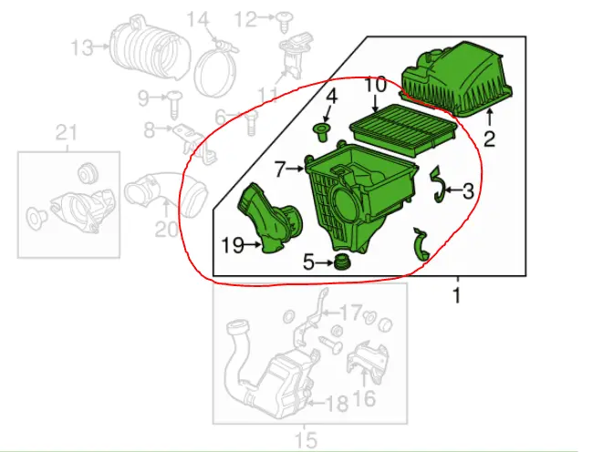

There's many ways to do the adjusting:
1. Either go under the car and pull the dipstick while the car is on = Risk burning your hand/car isn't flush with the floor unless you jack up all (4) corners or you're willing to do some yoga.
2. Keep the MAF connected while disconnecting the air cleaner assembly lower half = You can access the dipstick from the top but it may be slightly messy as the fluid on the dipstick will dangle everywhere. I found that this method worked best for me with paper towels underneath.
The red is what I disconnected and it comes off as one entire piece.

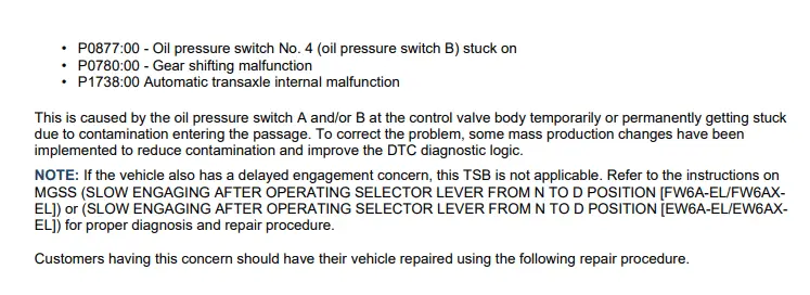

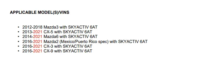

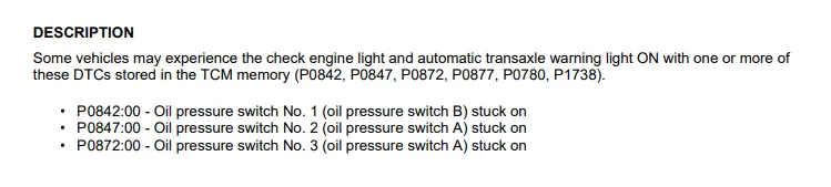

if I am not mistaken there is also a TCM calibration update with the TSB. Gets you the latest version.
I wonder if one can request the software update from the dealer as a service even if no issue experienced.
I can do the PCM but was never able to find a way to do the TCM.
yes. they also have a subscription for short term which gives you the latest pcm calibration updates. quite similar to Ford, they are using the same actually at least for 2020 and prior.
Its not Mazda vcm but Bosch :)
I assume legacy from the old partnership.
Asbuilt data also follow the similar principle but Mazda is more secretive on the options vs Ford.
IDS could do all modules (not just pcm and tcm but other stuff like forward camera firmware and few other systems, etc) but its costly for a home use.
Easiest is to go to the dealer and let them do it I guess.
