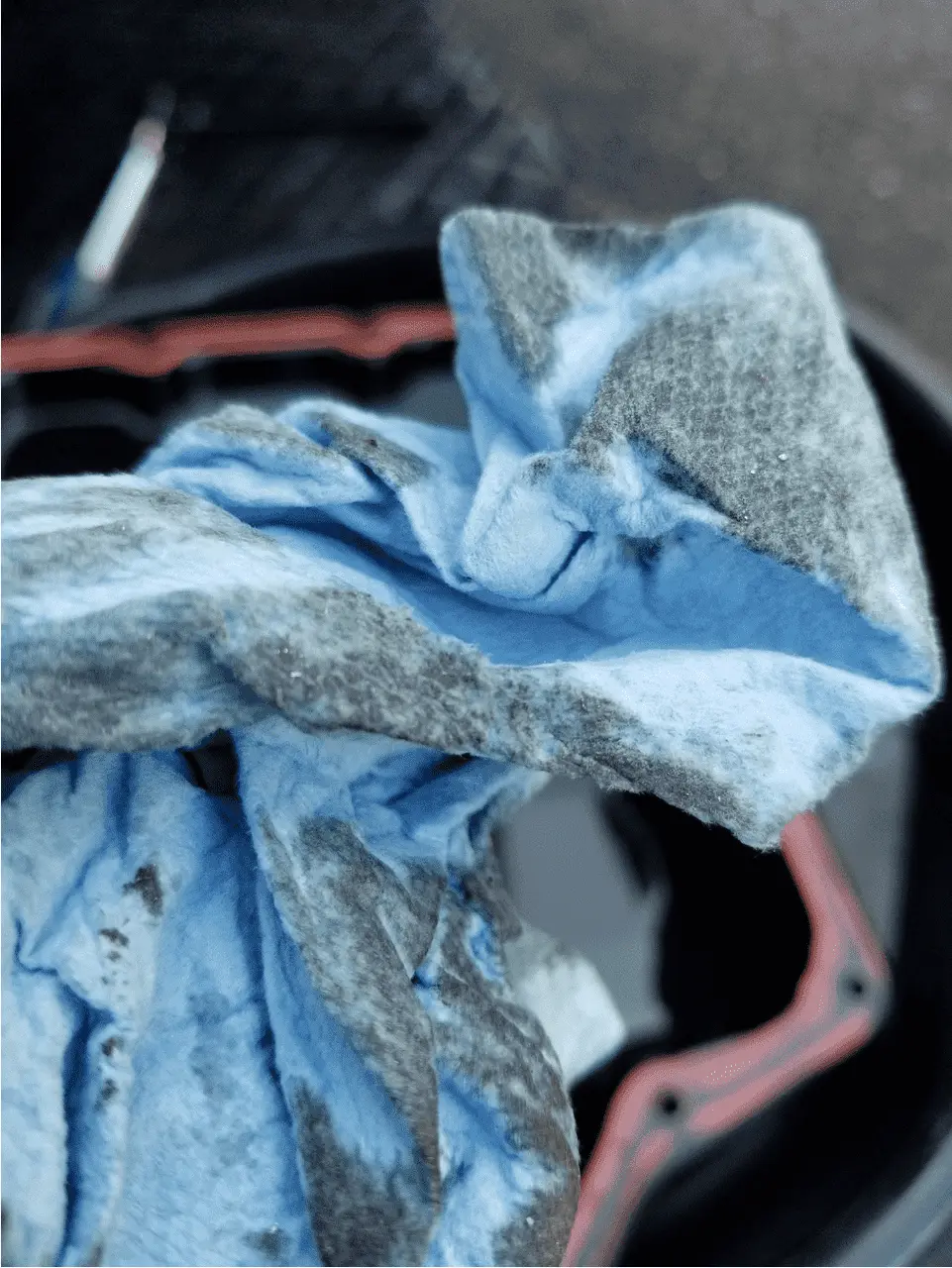

I did mine today. 2020 CX-5 Touring, 2.5L NA engine, 50,000 miles.
Drained the pan, dropped the pan, and changed the filter. The filter only held back a cup or so. I let it drip for 3 hours with the pan and filter removed. I have a bi-directional scan tool that gives me the transmission temperature, the transmission took 5 liters /5.25 quarts. I got genuine Mazda fluid in liters from Mazdashop online - they had the best price and it was half what my local dealership in Florida is charging.
A couple of notes: I use to work in a transmission shop, and this Mazda transmission pan and magnet are the cleanest I've ever seen on a first transmission service, like all things mechanical, transmission parts wear in, which leaves debris. - I was pleasantly surprised.
Use red can Brakleen and a wire brush to remove the factory RTV pan sealer - it goes really fast. Get a toothbrush size wire brush and Brakleen to remove the sealer from the bottom of the transmission case. The fluid was very discolored, but not bad. Bad fluid smells like burned popcorn. I will drain the fluid again tomorrow, refill with new, and button up the bottom. I'm expecting the drain and fill I do tomorrow to take about a 1/2 quart less than what the transmission took today.
The WIX filter and gasket I got from Rockauto had a different variation of gasket (similar but 2 holes were about 3/4" off), so I ended up buying RTV from a local auto parts store, I was a bit pissed about that.
*EDIT*EDIT*EDIT* I did a drain and fill today with a 2 hour drain time after driving the car for 30 minutes to heat up the transmission. 3.5 quarts is what it took to refill what I drained out.

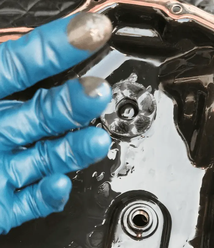

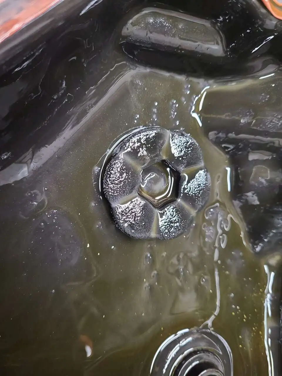

Many here felt there’re too much metal shavings and gunk on the magnet even on the pan for the first pan drop. Here’s the report from @Digbicks1234 at 63K miles:

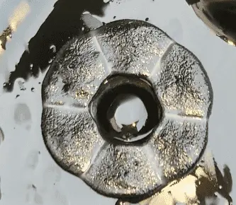

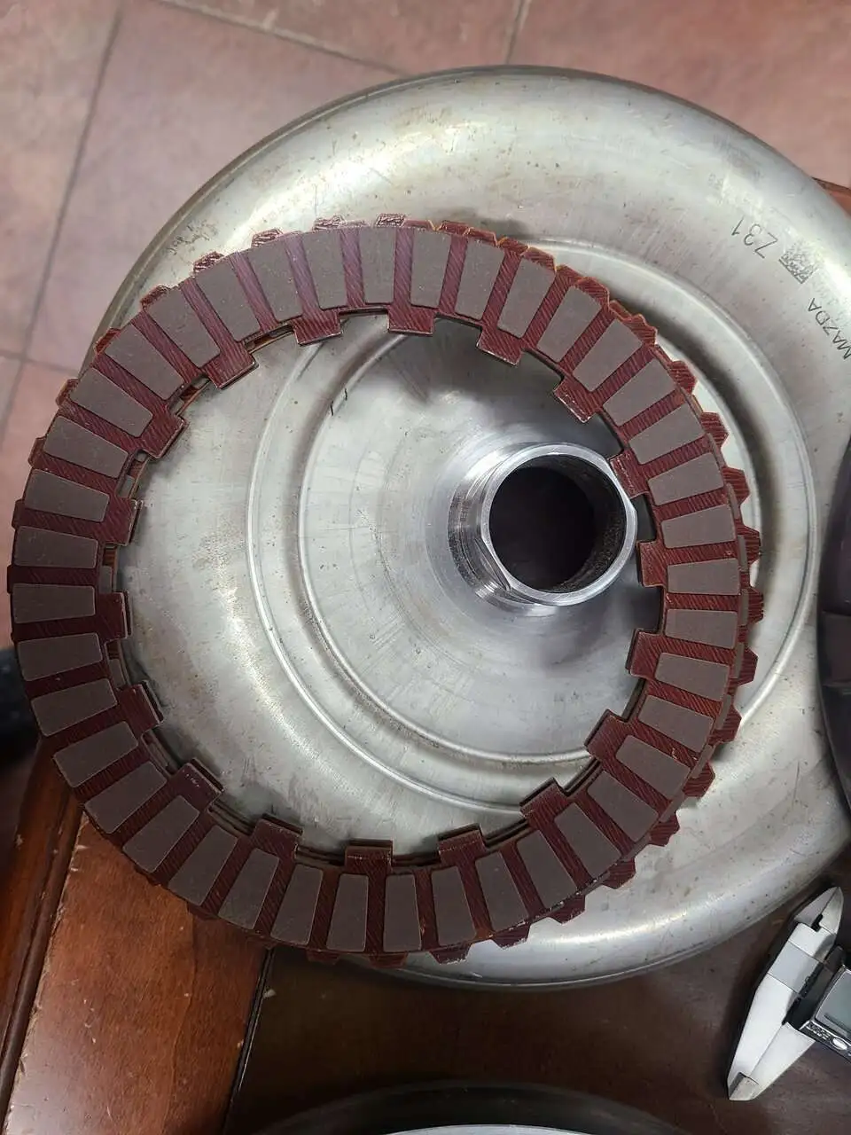

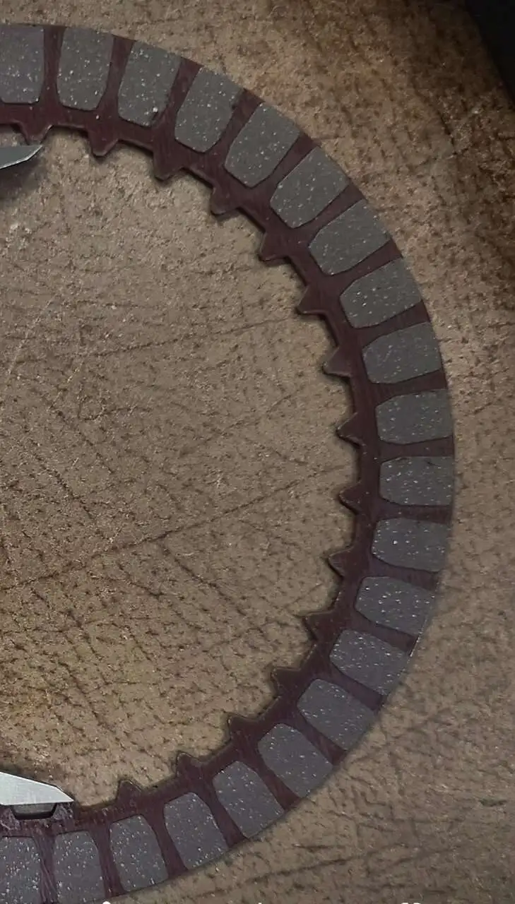

2016.5 CX-5 Transmission fluid change questions
The concept of "too much debris" varies by transmission family. That magnet is typical of any transmission that uses Exedy multi segment friction. Having multiple segments means great lubrication flow but you make up for it in friction compound to keep strength proportionate. There is a lot of metal in the friction compound. The TCC clutches shed a bit as well and they are relatively large and also a high metal ratio. The shiny stuff in the clutch close up are metallic chunks in the base material. The magnet picture is from the Sky I tore down for one of my videos. Everything was perfect inside the unit except for some hot spotted 3-5-R steels.
