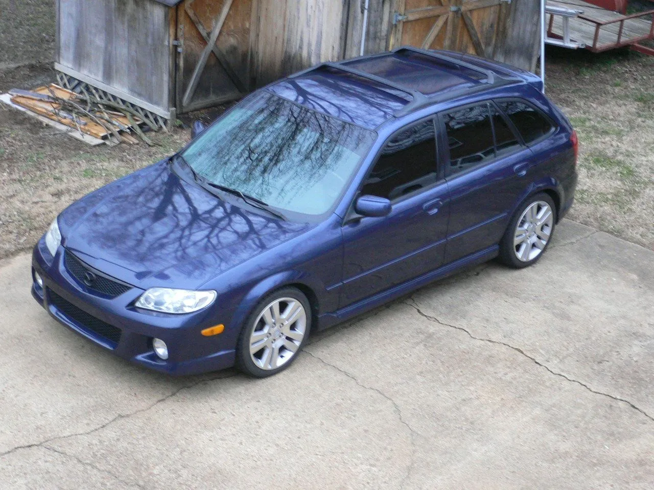

.7 of a mm? Actually, .35 of a mm on each end. I don't see how that could even be noticed. I doubt the studs are even that perfect in the first place. I'd just do it. As far as the bore goes, I just took a grinder to the bore on my Ford wheels and everything is fine and I don't think anybody could put anymore stress on their car than I do.

a grinder? oh dear...
.35 mm off center on a stud experiencing 100 ft lbs of ROTATIONAL force.... multiply that by the thread pitch for say a 2000 lb static load, then, put on a 140hp rotational load, and a 1500lb dynamic lateral load... even with the dynamic loads spread over 5 studs, if you're off center at ALL you're just asking for trouble. without getting the stud holes remachined, professionally, I wouldn't dream of it. I also, for the record, wouldn't take a grinder to wheels to make the hubcentric fit...
