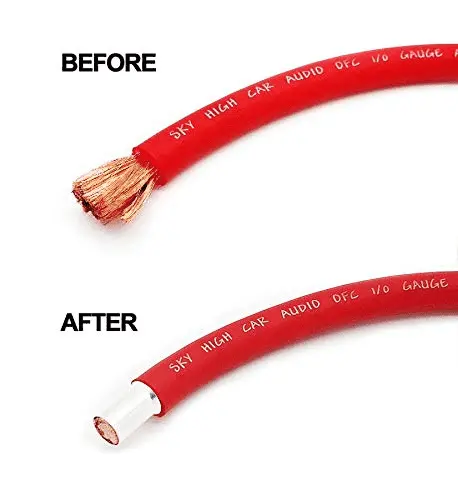

You can certainly use a hydraulic crimper for the ends, but that's not the only way to do the job. If you choose an amp that has Allen style terminals, you don't need crimps at all, just ferrules. Slip the ferrules over the ends of the wire, and clamp down the Allen screw! Done and done!
