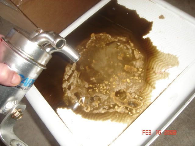

Anyone put an oil catch can on?
It's on the bottom, passenger side facing toward the back of the car. YOu can see it from underneath with the diffuser off. It may even be possible to install the can without removing the intake but you're going to need some pretty small hands.
does it matter what kind of catch can you own? Certain manufacturers like greddy and perrin charge like 100 bucks for this but ebay you can get some knock off for like 10 bucks. lol. I usually lean towards more name brands s*** for a few reasons but it doesnt seem this matters all that much.
so...??
Cheaper cans are usually just that: an empty can with two ports (one In, one Out). The vapor travels through the can with some velocity, and if there's nothing to impede its travel, it can blow right thru the can and go right back out the Out port, ending up in the intake mani after all.
The more expensive cans have some type of baffling or screening built into their interiors to trap or "condense" as much of the oil/fluid as possible.

THe catch can placed in the intake/crankcase pcv line as described in Whoosh's thread will prevent that s*** from flowing through your motor, i.e. cylinders, exhaust mani, and turbo. Probably the biggest gain is prevention of oil knock caused by vaporized oil getting into your cylinder and lowering the octane rating of the fuel. As the line comes in to the intake mani, a catch can installed here does nothing about oil in the intercooler, though in my experience with this car, that is a non-issue.
My main reason for doing it was to prevent oil knock which I believe happens randomly with this car.

That's just gross. Guess I'll need to add this to the list...

The problem is a really sensitive pcv valve. Is supposed to vent oil vapors among other stuff, but we are getting too much.
