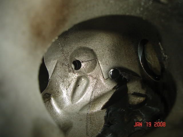

pull off your intake manifold(not your intake pipe or CAI)
and see what gifts Mazda has left you.
maybe this
and some of this
