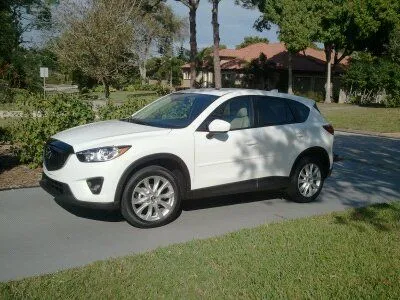

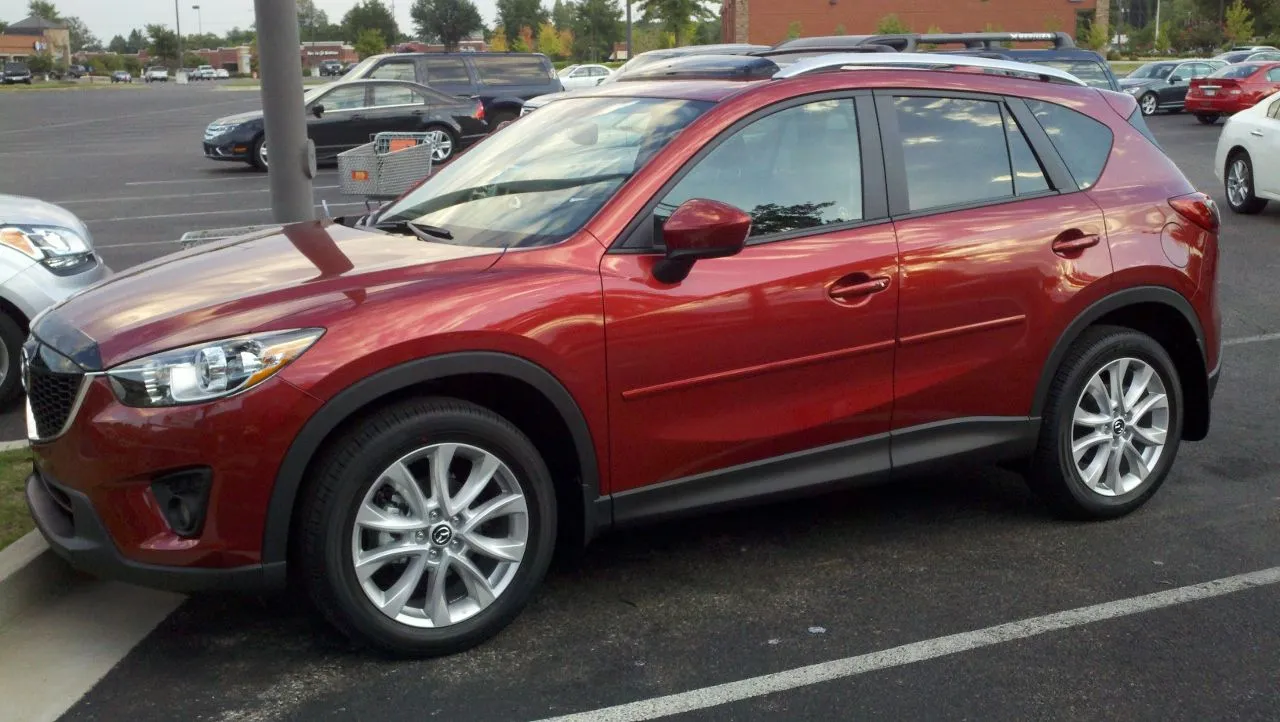

Hi all. New to the site and glad to be here. Just picked up our new CX-5 in late July (to add to our family fleet of a 2007 Mazda3 and a 2012 Mazda3). I installed the body-side molding on the CX-5 and the 2012 Mazda3. Looks great on both. Here is a photo of the CX-5:

Seems to me that the molding isn't going to do much because the hi point of the doors is above the molding. Someone is going to open their door on you and miss the molding. Am I missing something?
No. Realistically it's only expected to protect body from some of the dings.
Regardless, it's a clean-looking installation, hardly noticable which is a good thing.

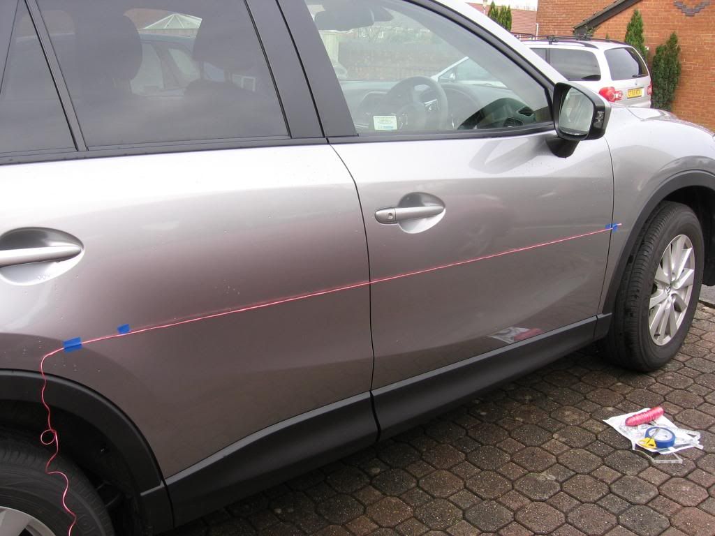

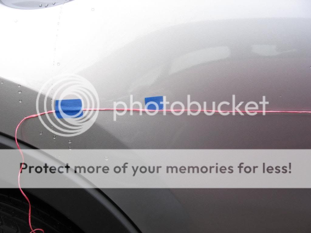

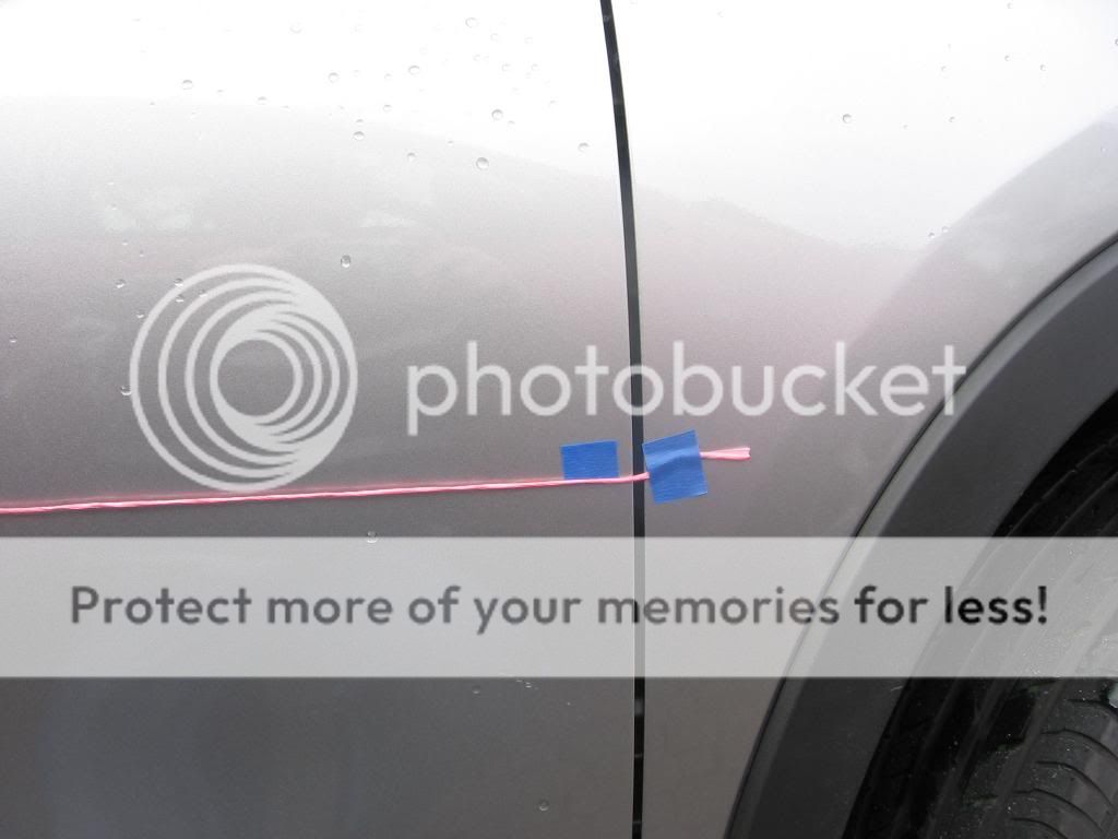

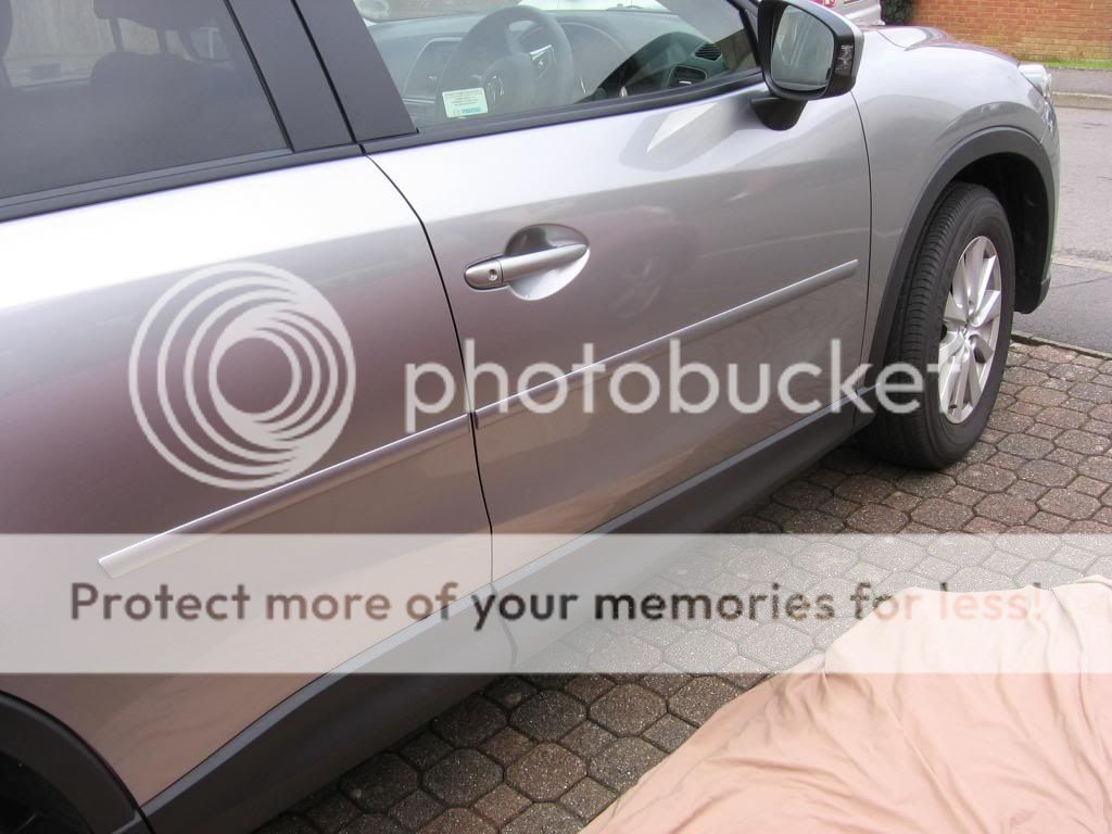

Well finally, the temperature rose to 9 or 10 deg C today and being dry for the first time in a while, today was the day to put the body side moldings on.

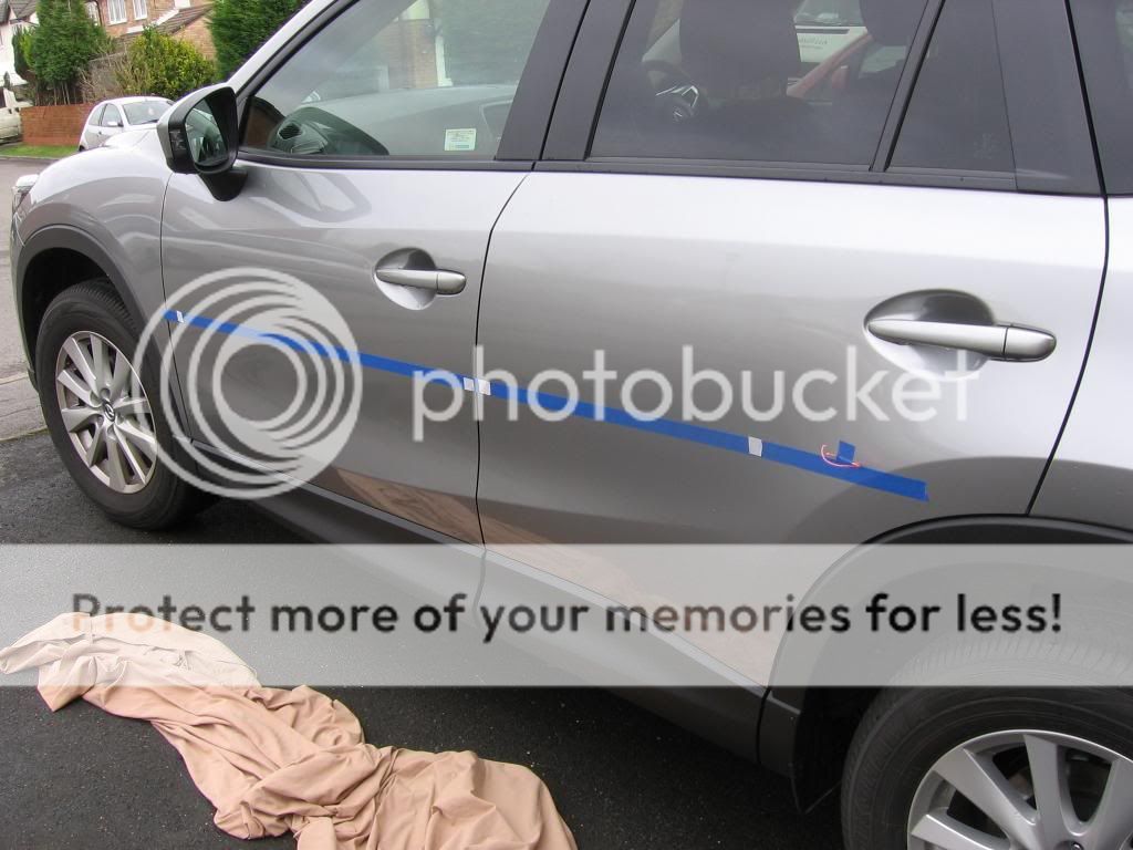

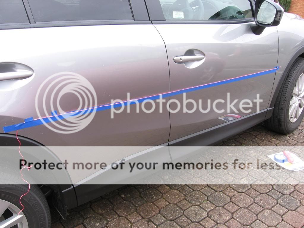

Washed car, then measured as per the instructions. I ADDED an inch to both measurements because that was the width of the masking tape and I lined up the TOP of the masking tape with the string line. I Re-checked the masking tape line against a new string line and found that the masking tape had sagged down just over an eighth of an inch in the middle. lifted over half the tape and re-positioned. Check again all now OK with the lines on both sides.
I measured out the trim end with smaller pieces of masking tape. Then I cleaned with the cleaning pad and then the pro-bond.
When it came to fitting I removed the protective film on the end pieces of adhesive BEFORE the trim was placed on the door. I did of course peel about 12 inches from the straight end as per the instructions.
I used a heat gun to warm up the doors first, I think to be honest if the temperatures were any lower there could of been a problem getting them to stick.

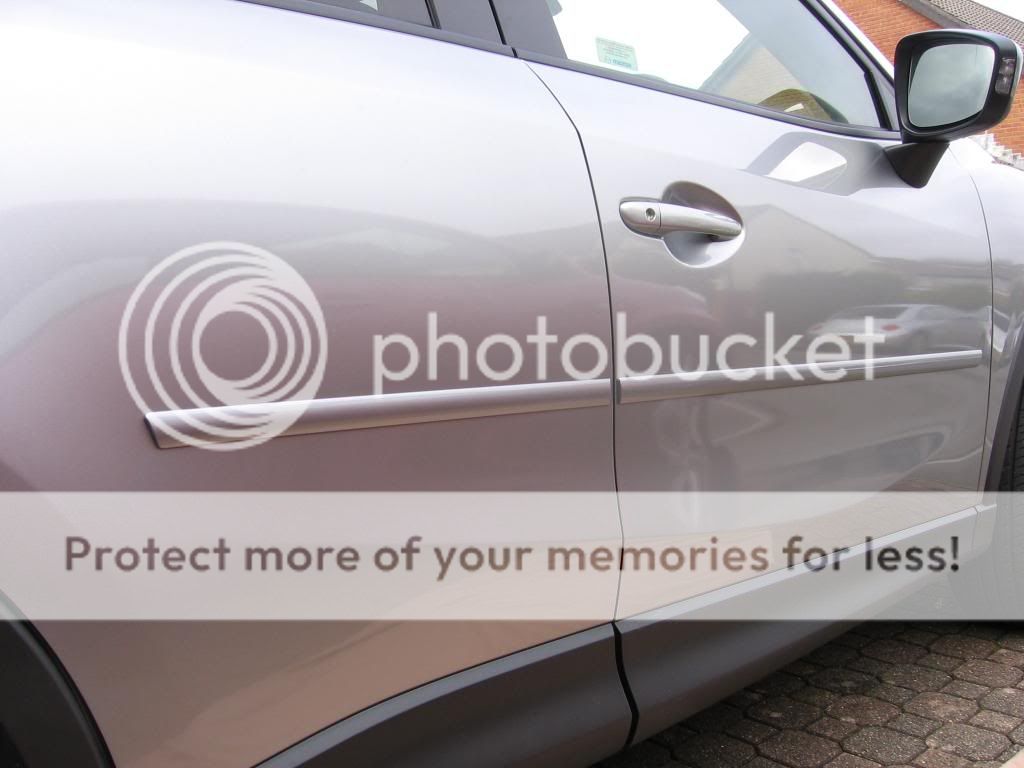

I could well be the first in the UK to have these fitted! No one was interested in fitting these for me. *too small a job*
but I'm glad I did it myself in the end! Many thanks to all who shared their photos and comment of how to fit.(yippy)
Looks great, but does the tape not leave a gap between the moulding and the door? A gap where you can look down and see the adhesive tape?
It does, but it's not too bad. If Dawn-ent had recessed the door facing side of the strips a bit and placed the tape in the recess that would have been an improvment. But until mazda uk come up with something better, (will they ever?) It's more than ok for me.
Very nice install jobs! Looks like OEM if the designers had incorporated it into production.
