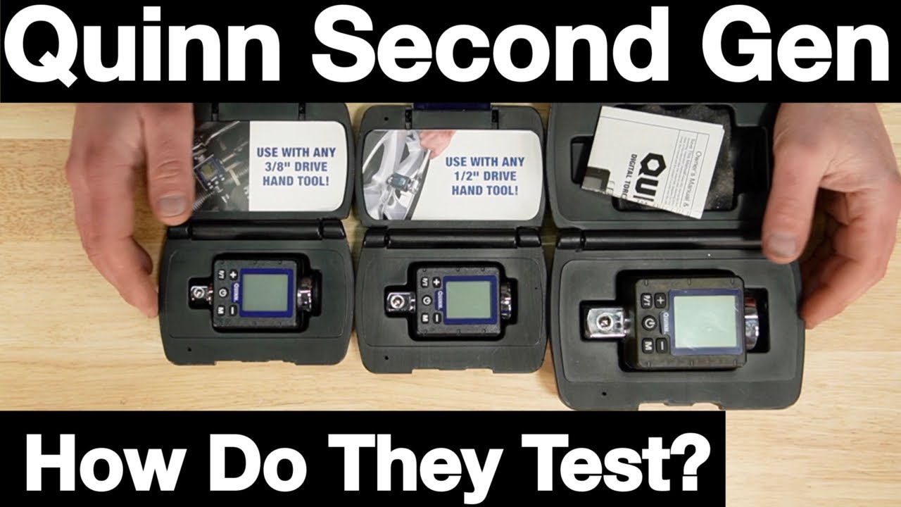

I have a digital torque adapter that I picked up NIB at a good price on ebay. It's the "Bikemaster" brand and is identical to some others (including the "Powerbuilt 940962 on Amazon), some of which differ cosmetically. It covers 27.5-147.5 FT-Lbs. It's identical to the early version (no longer sold) of the Harbor Freight Quinn. Basically it's just a 3" extension with 1 or 2 strain gages bonded to the sides of it and some circuitry in a case with buttons. I bought it to check my TW calibration not to use on the end of a breaker bar.
They have 2 modes. One where you preset the target torque and leds flash with beeping as you approach the target. The other captures the highest reading which is what I want to see when the TW releases at it's setting.
Here's a guy on youtube with a few tests on adapters and other tools (incl. TW's). He actually does a decent job in his videos. There are reviews on other YT channels as well. I find it useful but won't deny the 'toy factor' as well.

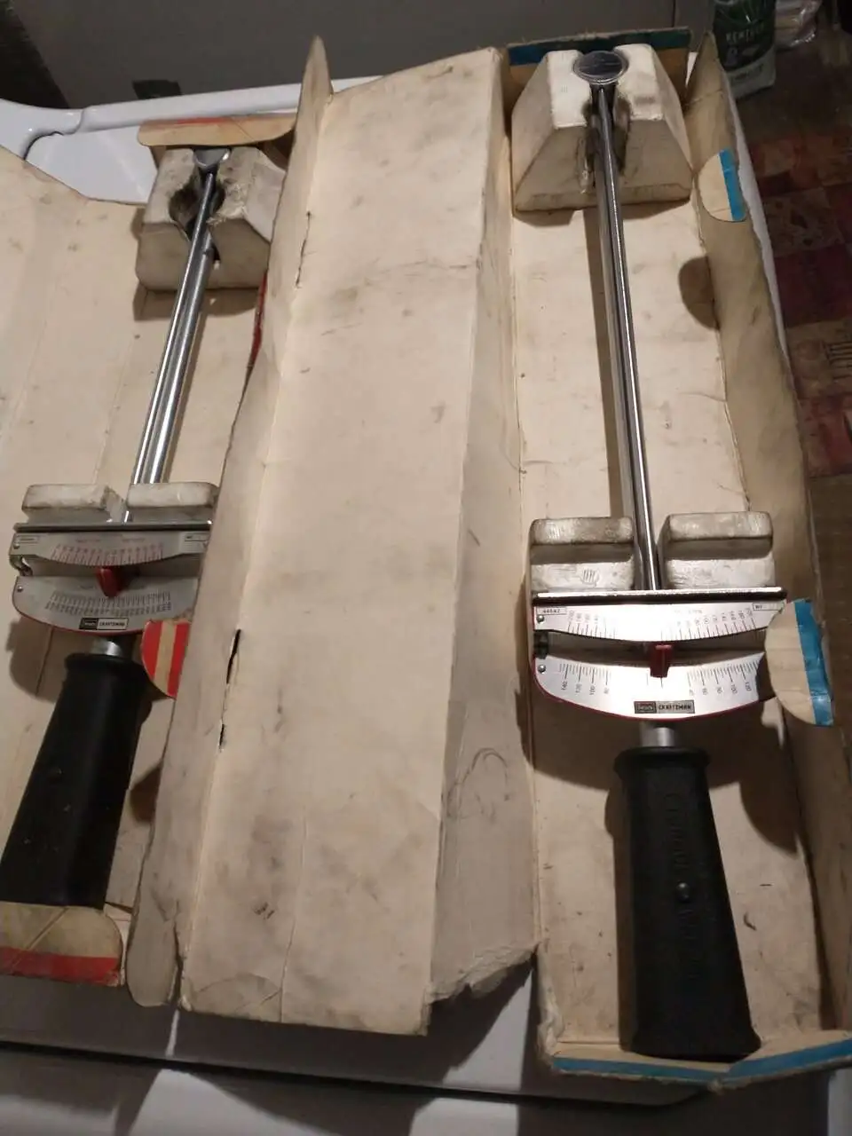

Torqued to ~100 ft-lbs . Since they get torqued in steps of roughly 40, 70 and 100, it's quicker and easier to use a beam type (with pointer) torque wrench than adjusting a clicker torque wrench. Thru the years they consistently loosen at~80 when torqued to 100. I don't even bother to recheck at 50-100 miles later except for new aluminum wheels. They never come loose. A beam type torque wrench with short extension and appropriate socket has lived in the trunk of my vehicles since the 1970's. I guess a person just goes with what works for them.
Jeez, I didn't think anybody used these anymore. I have 2 I bought in the late 70s, must have used them less than a dozen times.
Yea well, sometimes simpler is quicker and it's been mainly reserved for lugs. And that style served well for 25 years until my first clicker many years ago. It's still in my suv and also handy to check loosening torque if I have the tires rotated someplace like for a free rotation and balance check. You know, you request 100 ft-lbs and they torque to 200. In instances like this my cordless impact has been a back saver before me retorquing the lugs.
BUT, since I posted that months ago, I acquired a 1/2" drive clicker which is kind of nice in that I don't have to look at a scale while pulling at the same time. Actually, I possess 2 other (1/4" and 3/8") clickers for in-lb and lower ft-lb (10-100) applications. So, 1 oldie out of 4 TW's ain't bad.
