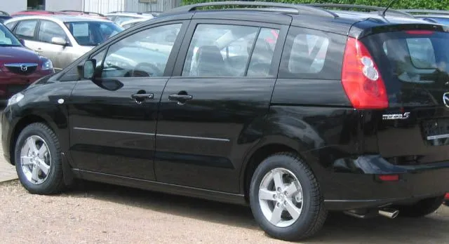

15s are downgrading (boom08) LOL. It just looks completely different...

there wasnt clearance issues with 15"s? I thought out brakes only fitted in 16s =p
Yup, you are right, OEM 15s have a smaller brake disc and are only available in Europe and Japan I believe (scratch). I think they did not make it here as they did not pass the decent look test (poke), LOL
Rear disc diameter (mm):
- 15" brake 278
- 16"-17" brake 300

prob for the 1.8 and 2.0Ls

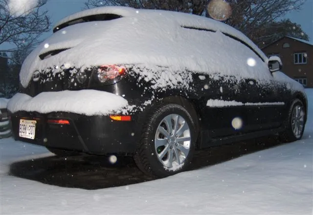

I just replaced my '08 MZ3 P205/50R17 tires with P205/55R16 on '07 MZ5 16" alloys for winter.
They look and handle great - so far ! (cool)
