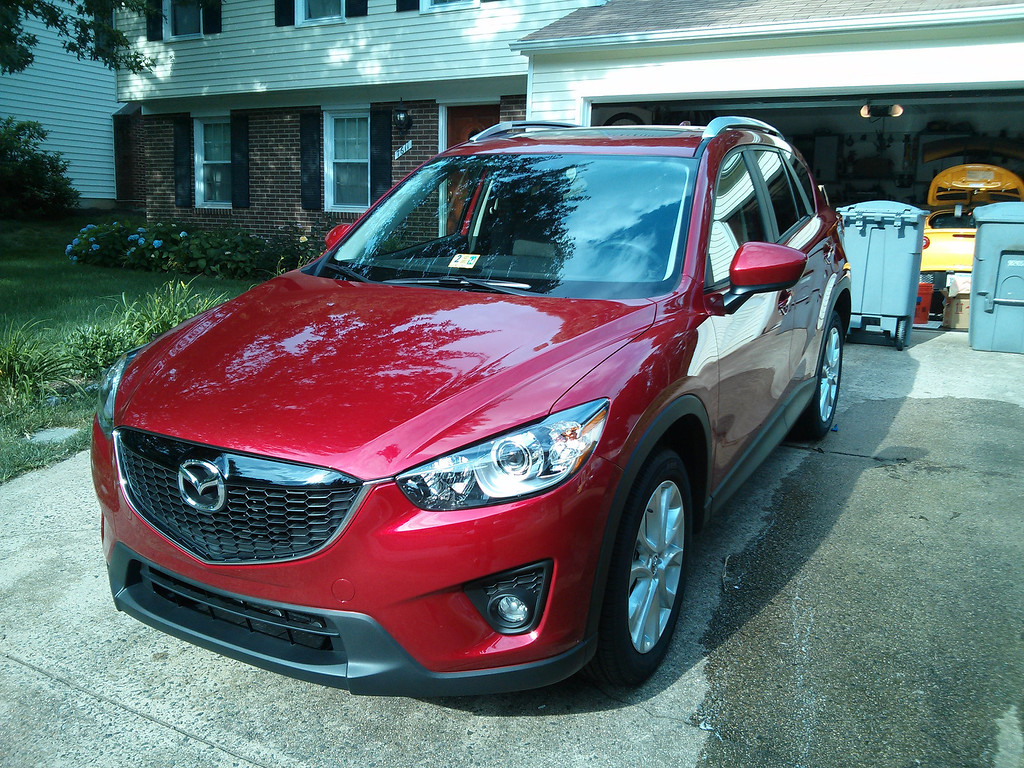

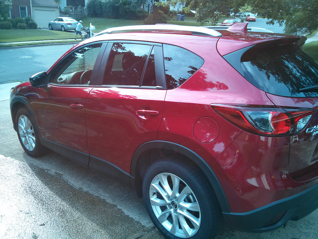

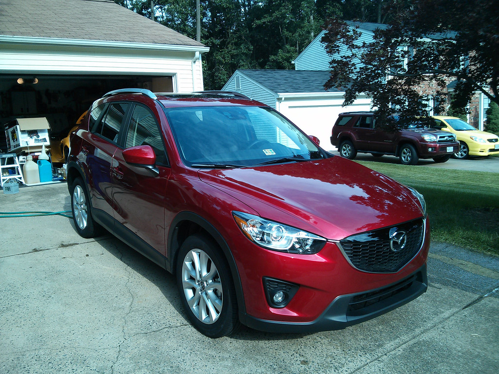

My car came with plenty of DISO (dealer installed swirl option) so Ive been planning on doing a light correction on it.
I really like meguiars line of products. Ive been using their tan bottle pro line products for years and gotten very good results. (see my old 99 miata thread for a great paint rescue)
Ive heard raves about their new consumer ultimate line though, so I picked up some ultimate polish and ultimate wax, a couple new foam pads and planned to go over the car with my porter cable.
however, was short on time with a rainstorm pending so I used a single step Pinnacle XMT 360. First time using a single step, I originally bought it to do cars that I dont want to spend much time on like my truck or wife's car.
Not overly impressed with it, but I guess I shouldnt have had high expectations with a single step.
I used a polishing pad but it still didnt do much correction, and the gloss at the end wasnt as good as a true sealant or wax.
this was before I did the wheels or tires
