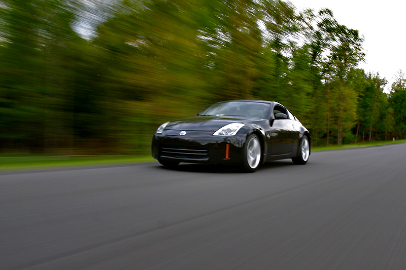

someone did a write up on how to shoot and post process clean looking motion shots. once you get it down, I think they look better than the sterile rig shots.
In this case..I want the rig so I can shoot at more different angles and get closer to the car, etc etc.
This pic has camera shake. You can check out my motion shots in this thread too. I think they start around page 79?

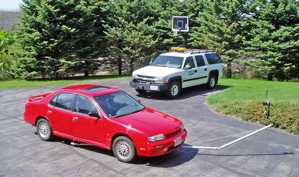

I got to thinking about making a camera mount to hang the camera outside my car. Only, I wanted to do it tonight, which meant using just what I had on hand. When I got out to my car to work it out I realized immediately I had all the pieces I needed.
Some time ago I made a scrim to soften light from my flash while taking macro shots. The scrim was mounted to one end of a 1"x3"x18" board using a 1/4-20 screw post. My flash was mounted towards the other end of the board on another post. This then attached to a second tripod which was now a light stand.
For the camera mount I simply mounted the camera where the scrim would go and anchored the tripod to the rear door. A camera mount was born...
The set-up:
The angle of the camera is adjustable. I thought this setting was more visually interesting then level.
The results:
The results were mixed. I had difficult time keeping the camera steady. I also longed for more interesting lights to use as a background. Plus, the location of the camera leaves a lot to be desired. Oh, and I don't have a sweet 12mm fish-eye lens. Or an Audi TT.
