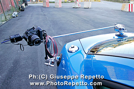

I've been looking for a cheap way to build a rig as well, but there is no cheap way around it. especially if you want the entire car in the photo.
Well, no, not 123lbs applied off-axis to the cup. BUT, the 4:1 safety factor takes into consideration imperfect positioning, dirty surfaces, etc. Careful placement and a clean surface means you will probably achieve or exceed 123lbs of force even off-axis. Besides, when they use these to carry multi-hundred pound granite counter tops into a home they have the weight off-axis.
I agree about the challenges of extending the camera away from the car. The under-car magnetic mount has two things going for it. 1) it doesn't overlap the body nor appear in reflection, and 2) there is only a single bar to PP out of the image. With a triangulated suction cup mount you'd have two or maybe three bars to edit, plus the cups on the body, if visible. Those cups are sizable, too, at 10".
the problem with under car mounts is in the tuner scene, its not always easy to put something under a car due to suspension changes.
and as you say with suction cups, due to their nature you cant always find a good surface to put them on.
my camera can weigh up to 5lbs. and bogen/manfrotto cups are rated at ~6.6lbs IIRC
would you trust 2500$ on the end of that? I know I can't. add in the weight of the rig and movement, as well as leverage as the camera gets further from the suction cup.
having said that, magnets ARE the cheapest way and strongest way I feel.
some strong magnets and piping is all you need.

I got to thinking about making a camera mount to hang the camera outside my car. Only, I wanted to do it tonight, which meant using just what I had on hand. When I got out to my car to work it out I realized immediately I had all the pieces I needed.
Some time ago I made a scrim to soften light from my flash while taking macro shots. The scrim was mounted to one end of a 1"x3"x18" board using a 1/4-20 screw post. My flash was mounted towards the other end of the board on another post. This then attached to a second tripod which was now a light stand.
For the camera mount I simply mounted the camera where the scrim would go and anchored the tripod to the rear door. A camera mount was born...
The set-up:
The angle of the camera is adjustable. I thought this setting was more visually interesting then level.
The results:
The results were mixed. I had difficult time keeping the camera steady. I also longed for more interesting lights to use as a background. Plus, the location of the camera leaves a lot to be desired. Oh, and I don't have a sweet 12mm fish-eye lens. Or an Audi TT.
Anyway, I am still pretty confident that I could rig something using that Anver 10" pump mount that has a max capacity near 500lbs. I think that could really prove versatile, especially if I can make it part of a larger system.

so I picked up a 125lb magnet today...and I have to say it has about 20 lbs worth of pull on the most flat part on my undercarriage.
the problem is in the magnet design. they are designed to be taken off an object easily by tilting the magnet to the side. straight pull its surprisngly strong, but not 125lbs.
also if you do the math, 5lbs worth of camera at the end of a 5' pole = a lot of weight.
to give you an example grab a 5 lb sledge and try tilting it from the end.
definitly need at least 2 magnets to put some leverage on the user side.

it looks adjustable.... i did see some other bigger rigs that you attach to the bottom of a car.....
It's pretty adjustable . Look at the pics he has taken with it. it's pretty cool actually. I'd like to have a cage around the camera though..just in case LOL
it is adjustable, but not very far. his full car pictures are taken with extreme wide angle.
this will get you better results, but I hear it is not very stable.
I think this is probably the preferred rig in the industry because it is so easy to edit out in post. I can understand that a camera at the end of that long arm would be unstable. I think a secondary arm to another part of the undercarriage would provide at least some additional stability at only a small cost to flexibility and speed of the set-up.
As for making your own, I think you'd have to have access to metal working tools like a metal saw, drill press, etc. Maybe you could get a local machine shop to donate an hour of work. I think if you worked hard at it, you could put together something similar for $400 or about half the retail cost of the pro rig.
