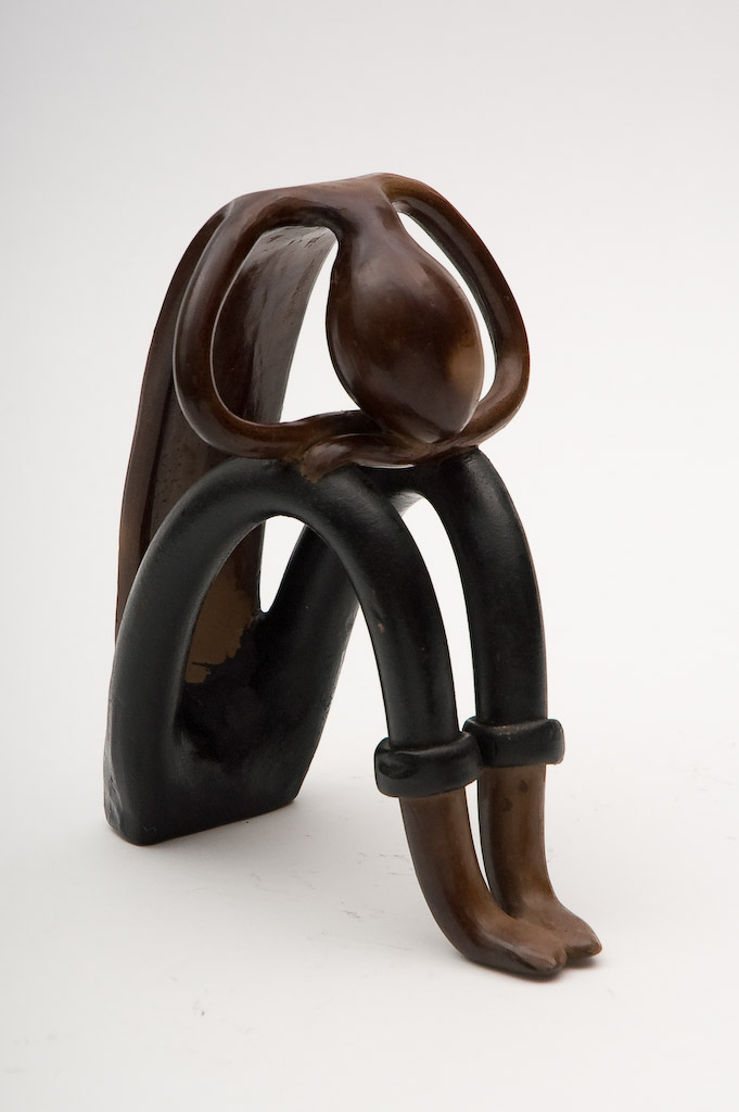

Here's a product shot done by my friend.
Barely any shadows, 2 flashes, 2 umbrellas.
