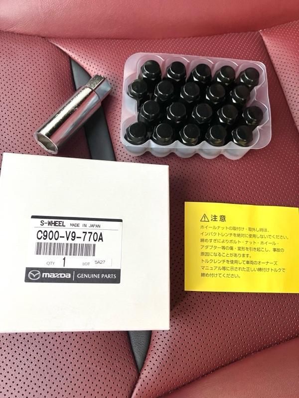

I did a quick search on Mazda USA's site and found none listed for the CX-90, I only see wheel locks? Here is a part number for the set of OEM black lug nuts that I bought to replace the wheel locks on our daughter's CX-70. She has the PHEV PP with 21" wheels so I'd imagine that these will work fine.
OEM Black Lug Nuts
Pricey when you consider that you have to buy four sets. But if you don't mind the locks or are ok with buying one set of the lug nuts I listed above, you can buy this OEM kit on Ebay for a fraction of the cost.
OEM Black Lug Nuts - Kit
If you wanted to go aftermarket, I'd search McGard and Gorilla to see what they may offer.

Mazda part # C900-V9-770A listed for the CX-5, CX-60, CX-80, etc should work, since the stock lug nut part number is B002-37-160B... basically all Mazdas use this lug nut these days, which was first used on the 323 40 years ago
