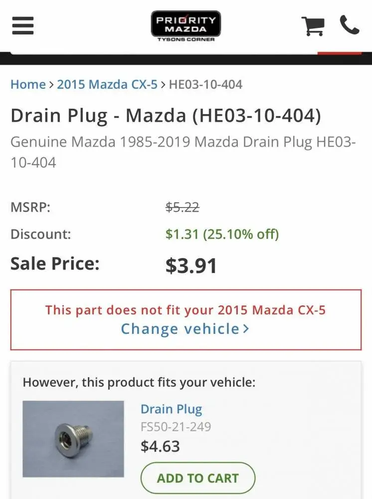

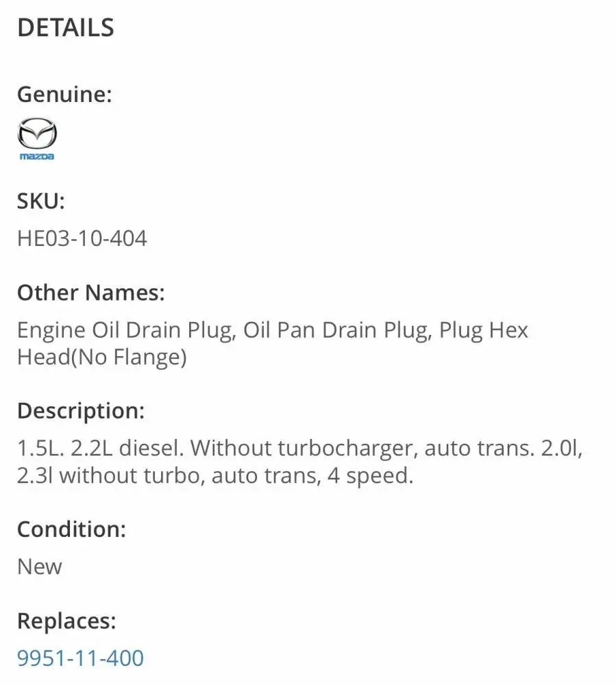

HE03-10-404 Plug. This MAZDA drain plug shows a flange on the plug. Sorry I was unable to cut and paste the picture.
Upvote 0

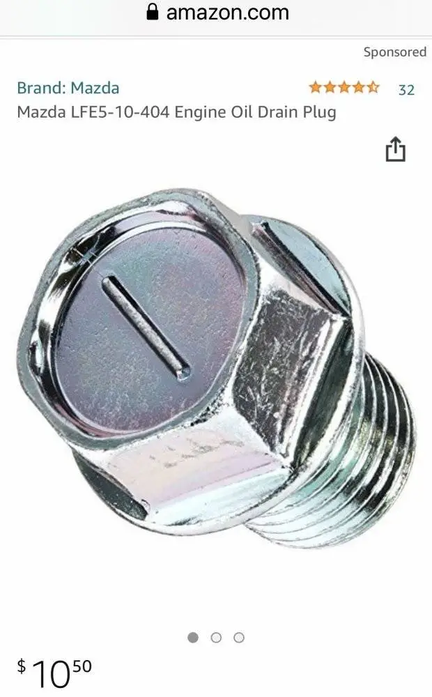

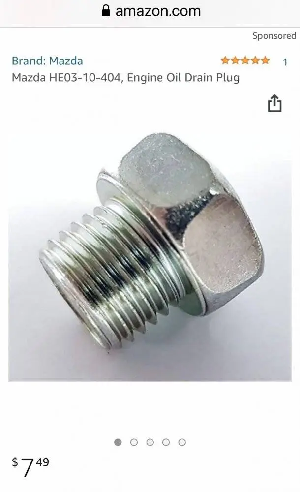

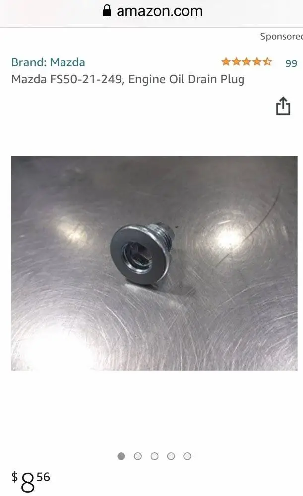

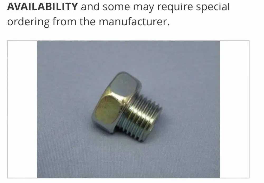

HE03-10-404 is not a correct part no. for drain plug as it doesn’t have the flange (see comparison pictures below).
The part no. for 17 mm flange hex drain bolt on newer 2.5L and 2.5T is FS50-21-249 or LFE5-10-404.
You may have trouble to find 8 mm internal Alllen drain bolt right now as Mazda has switched to 17 mm flange Hex drain bolt for all engines. You’ll find the same part no. FS50-21-249, as the drain plug for ALL MY 2.5L and 2.5T’s. And it should be ended up with a Hex drain bolt, although the specific 17 mm flange Hex drain bolt used to use part no. LFE5-10-404. Just use part no. FS50-21-249 to get correct drain plug.
yrwei52 is exactly correct. The updated part number to replace both the allen oil and aft drain plugs is indeed the hex LFE5-10-404. I've already swapped both of mine.

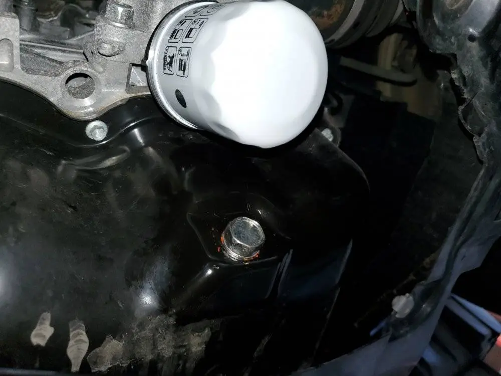

The plug in the photo looks like the Mazda part. I hope they aren't trying to cover up a messed up oil pan. Is that a dent just left of the plug?

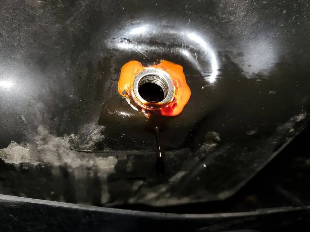

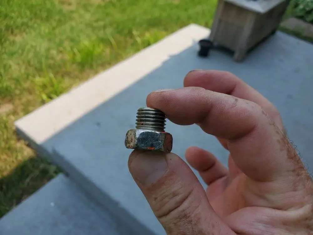

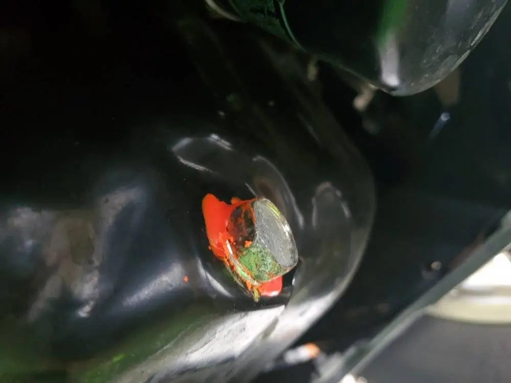

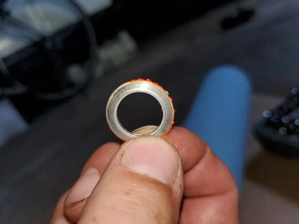

Ok sorry for the delay on updating this thread. While I was out of town our other vehicle was totalled in an accident. I wasn't about to possibly render our one running vehicle undrivable by messing with a shady looking drain plug so had to wait until we got that all sorted out.
I went ahead and proceeding with changing the oil myself after calling the dealership and asking the same type of question about my drain plug (I had never identified myself when I stopped in personally) and they were adamant that it was just a drain plug sealer compound and they put it on strictly in case a crush washer fails and to keep the plug from vibrating loose. As they put it, an extra bonus for having them perform the oil change.
Started out by chipping away the sealant with a small flat head. It came apart without any real effort. Once I put a socket on the plug it came out nice and easy, nothing out of the ordinary. Took a little effort to get the old crush washer off since it was covered in sealant still. Got the pan and bolt cleaned up as best I could and reinstalled the drain plug with a new crush washer. I didn't notice anything unusual at all while removing or reinstalling the plug. Left the plastic cover off after filling the oil up and went for a short 3-4 mile drive and let the car sit for a couple of hours to see if there was any oil leaking but not a drop so I think all is well.
Thanks again to everyone that chimed in. Really appreciate everyone's input while I sorted through this issue.

Glad the situation came out fine for you and thanks for the update. But if I were you I’d get a correct drain plug, the one with flange stated in post #44 above, for the next oil change.
Upvote 0
Hex head oil drain plug should have flange with the same size as aluminum drain plug washer on outer diameter. Thus the bolt flange can apply even pressure to soft aluminum crush washer on entire area and make sure it evenly deformed the aluminum washer with specified torque. The hex head used on OP’s CX-5 doesn't have larger diameter flange to cover the entire aluminum washer and the uneven load spread from the smaller flange could cause some minor leak eventually.
Here’s a comparison picture on deforming aluminum washer with original 8 mm internal Allen drain plug and hex head small flange drain plug currently used by OP’s CX-5:
I agree with yrwei52, my OEM aluminum washer doesn't look like that either (red arrow indicates uneven load spread from the smaller flange hex bolt), I'll stick with the larger flange allen bolt that came with the car

HE03-10-404 is the current drain plug on OP’s 2015 CX-5 Touring:

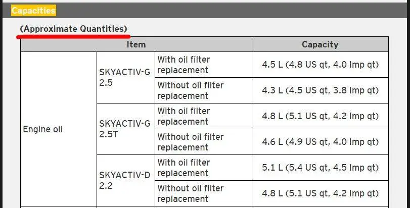

⋯ On a separate note my manual states 4.8 quarts of oil for the AWD 2.5 liter engine, but after putting a full 5 quarts in I'm just between the lines on the dipstick. Is the manual not accurate with the oil capacity?
The owner’s manual on several fluid capacities for CX-5 are inaccurate. For engine oil it says 4.8 quarts for oil and filter change on the 2.5L. But most DIYers found it needs 5.25 quarts to reach to the “Full” mark of the dipstick.
Upvote 0
For engine oil, the quantity specified isn't inaccurate, its an approximation. See below. That said, if you prefer the oil level to be right at the full mark, you may need an extra quart.
Upvote 0
Putting in an extra quart than “approximate quantities” for engine oil replacement definitely will overfill any engines listed in owner’s manual.
The fluid capacities in owner’s manual for Mazda CX-5 are mostly inaccurate as those are “approximate” quantities. The manual says 4.8 quarts on engine oil replacement with oil filter for 2.5L. But it actually needs 5.25 quarts to reach the Full / Max mark on dipstick. Front transfer case is correct at 0.45 quart. The rear differential requires ~0.75 quart but the manual says 0.45 / 0.37 quarts on gen-1 / gen-2 CX-5 respectively. I don’t agree with those inconsistencies as “approximate” quantities. The actual capacity of the rear differential is 66% larger than given capacity on specs, and Mazfa call it “approximate” quantity?
Besides, this’s the only car I have owned offered such inaccuracies and inconsistencies on fluid capacities.
Upvote 0
Six quarts would put it almost a quarter inch above the fill line mark. I put in 5.45 quarts with filter replacement to get it to the full line. I would use OEM oil filters.
