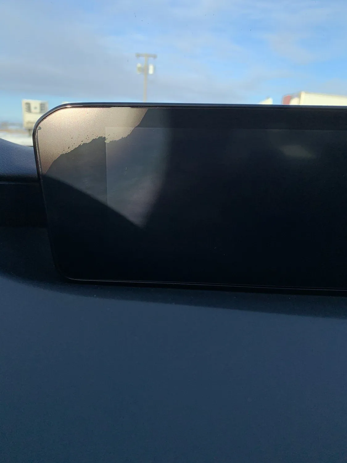

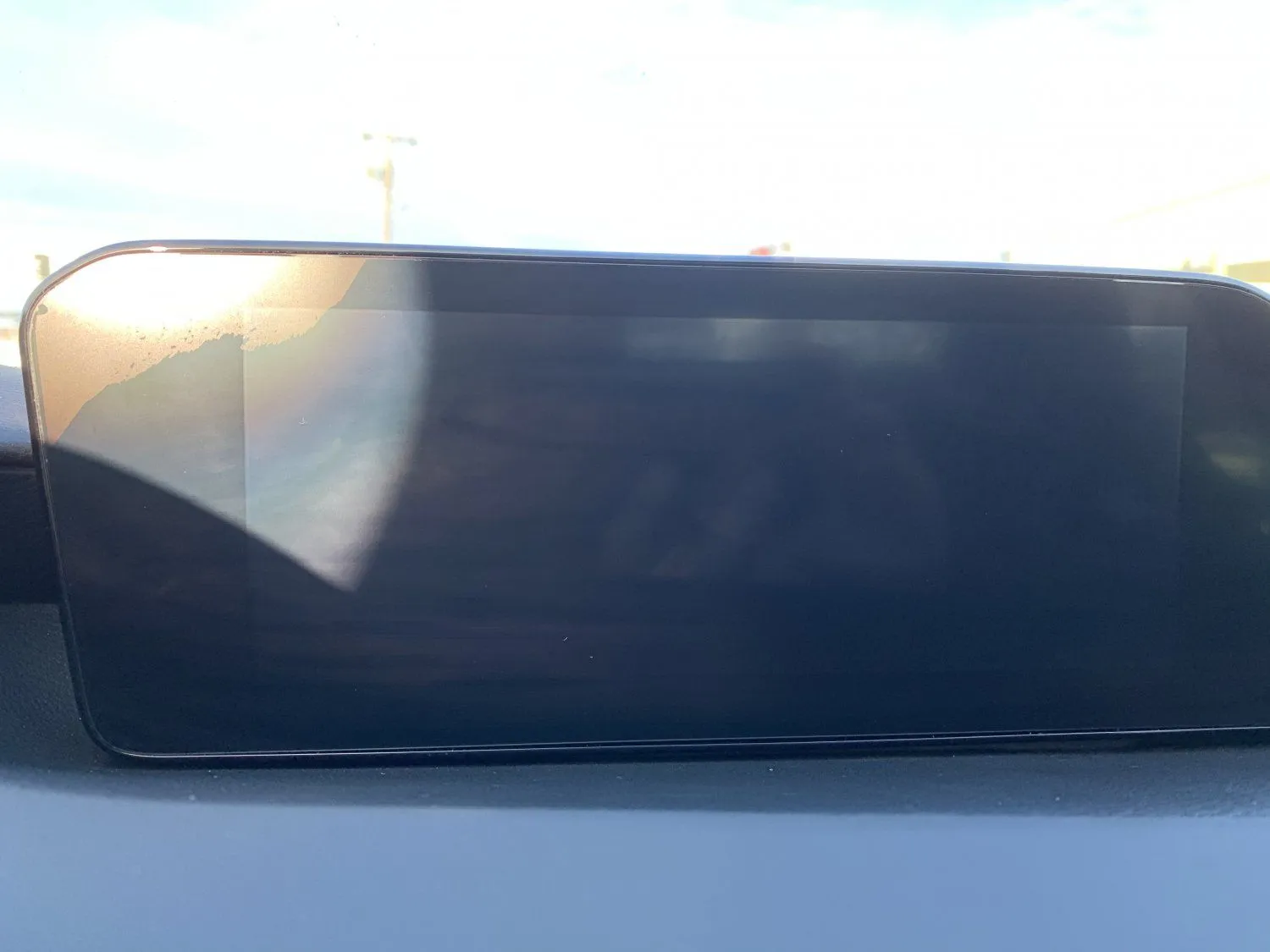

Just recently got a 2019 Mazda 3 and the infotainment screen’s anti-glare coating is starting to peel off with a portion on the top left corner appearing (see photos). Took it to dealer and said they’ll have to replace entire screen and make a claim to Mazda (under warranty of course). I compared it to other cars in their showroom and none had this issue nor can even see any anti-glare coating in a similar vehicle. Has anyone else experienced this in any 2019/2020 Mazda 3?

Are you sure that's not a peel-off protective sheet? I've never seen ant-glare coatings on eyeglasses, for example deaminate like that.
It’s not...the initial protective film was already removed by the dealer prior to delivery

Sounds like a similar issue if not the same but in my case I just got the vehicle from dealership less than 2 wks ago when the issue popped up (likely dealer didn’t notice it during delivery as it was already there). Therefore, they have to cover it in case Mazda doesn’t cover it under warranty but vehicle is new so either way it’ll be covered by them and not on my dime.
Just to close off this thread, my infotainment screen was replaced by my dealer last weekend under warranty that was approved by Mazda Cda. Now looks perfect and brand new!
