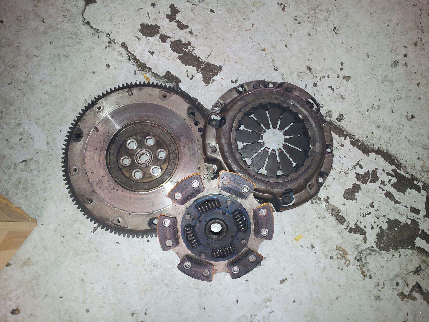

After the problem that i had withthe clutch that was slipping a friend of mine had for sale a 6-puck from another mazda that it is a direct fit.
Finally no more clutch slipping :D

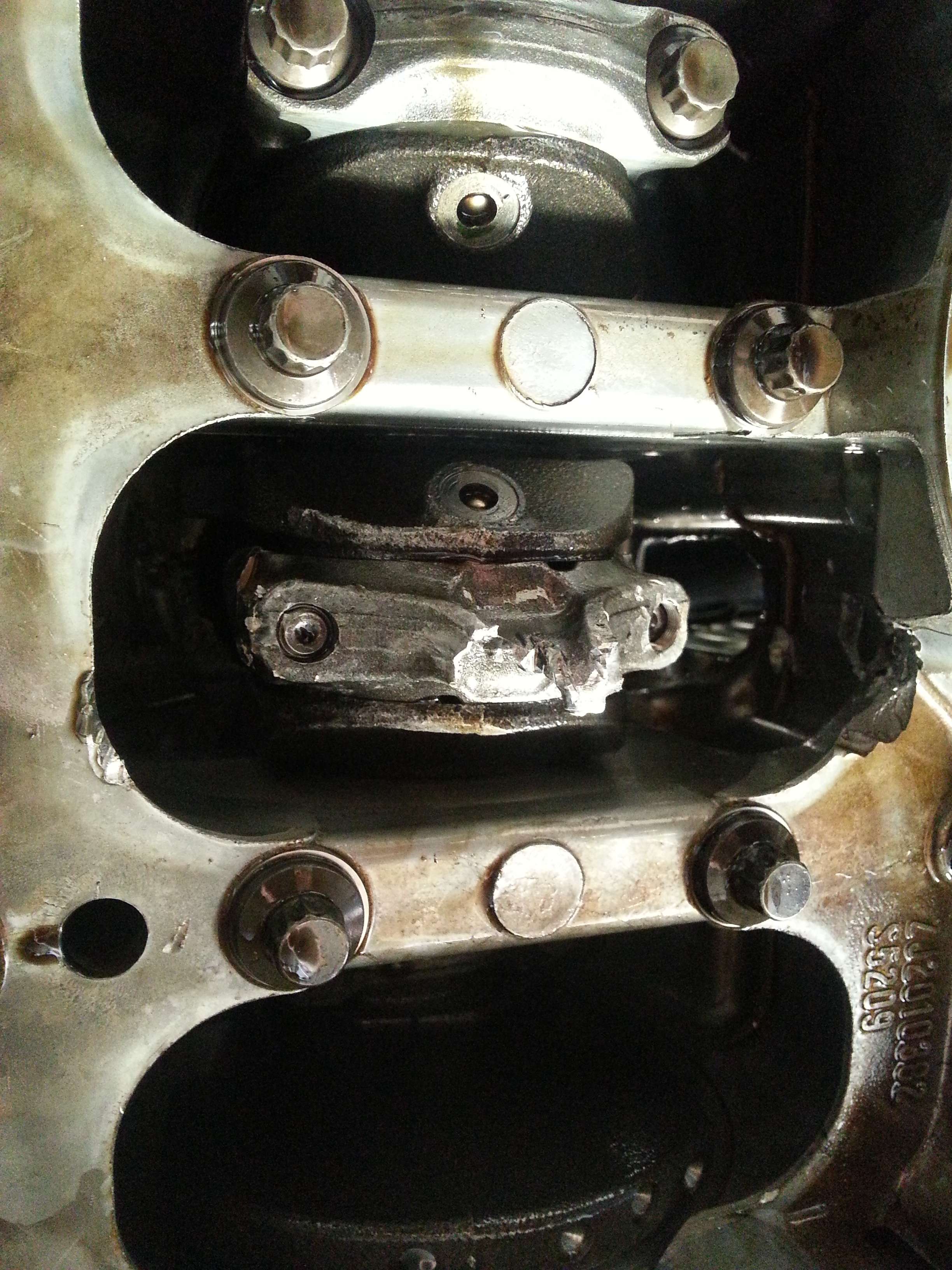

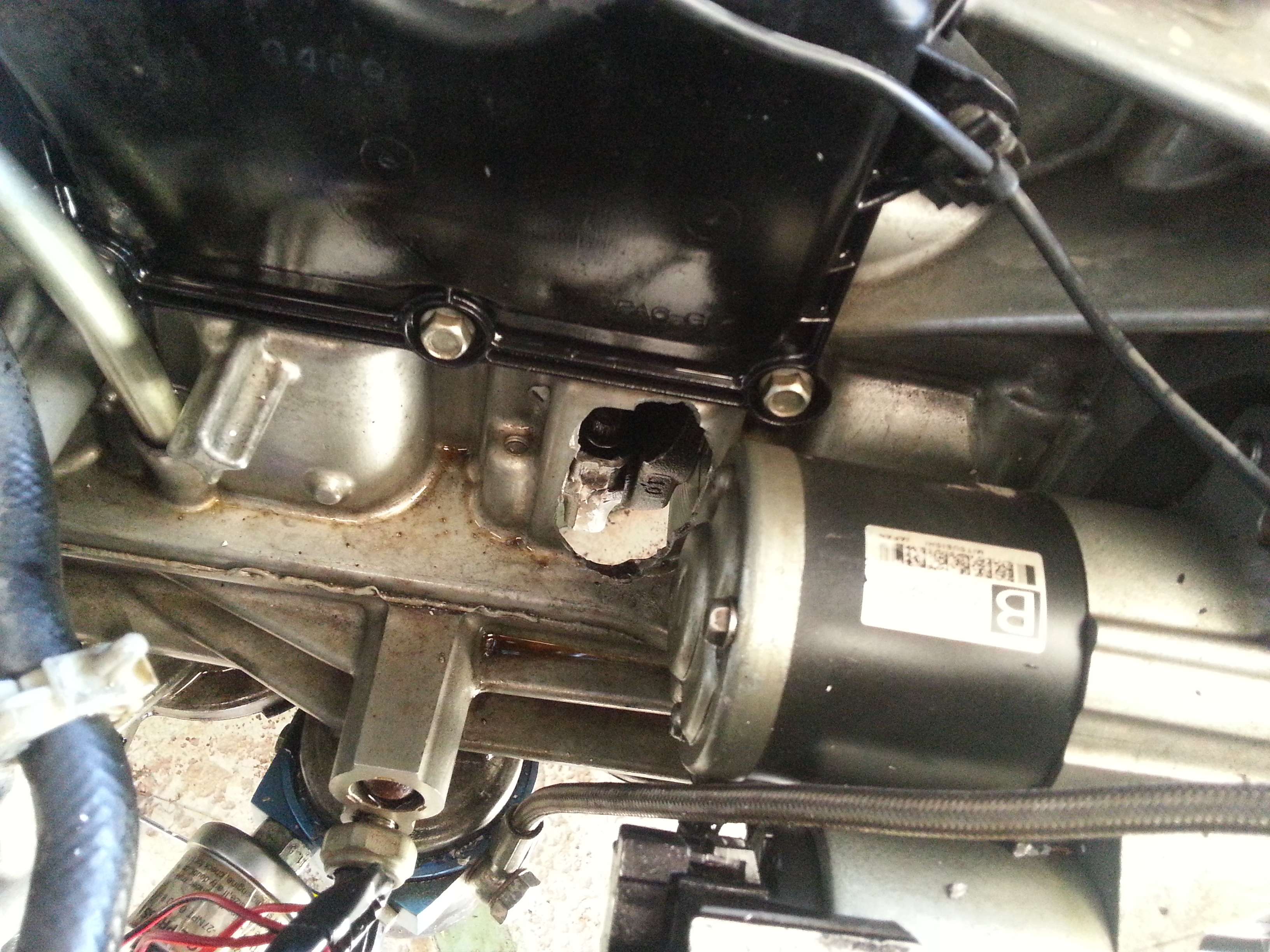

After almost 20k miles and a very abusive driving (i believe that 10k or more are WOT :p) the connecting rod of the third cylinder broke and did a big mess.
Now we know the limitations of the stock connecting rods.
For a super safe setup, 21-22kgm(151-159 ft) is the top like knight sports rotrex setup.
Mine broke at ~ 26kgm(190 ft)

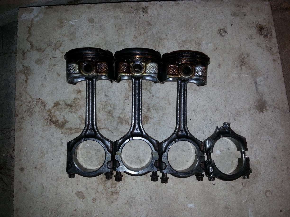

Today I dropped the engine and tear it apart.
The broken rod(last in the picture) is the 3rd cylinder and and the bended one(3rd in the picture) is from the 4th cylinder.

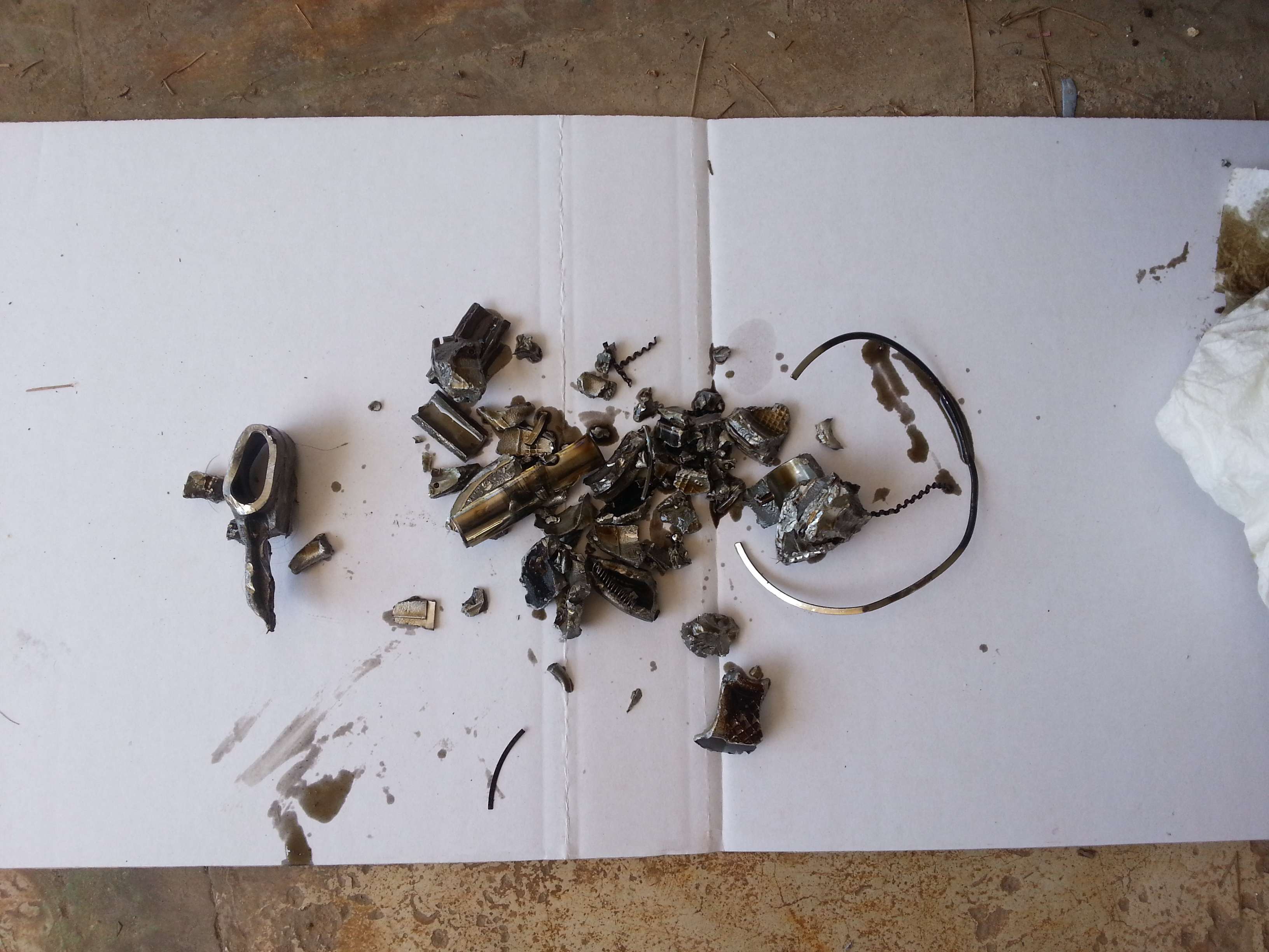

I found many bits from the broken piston tou all the other cylinders.(in the picture I've cleaned them)
