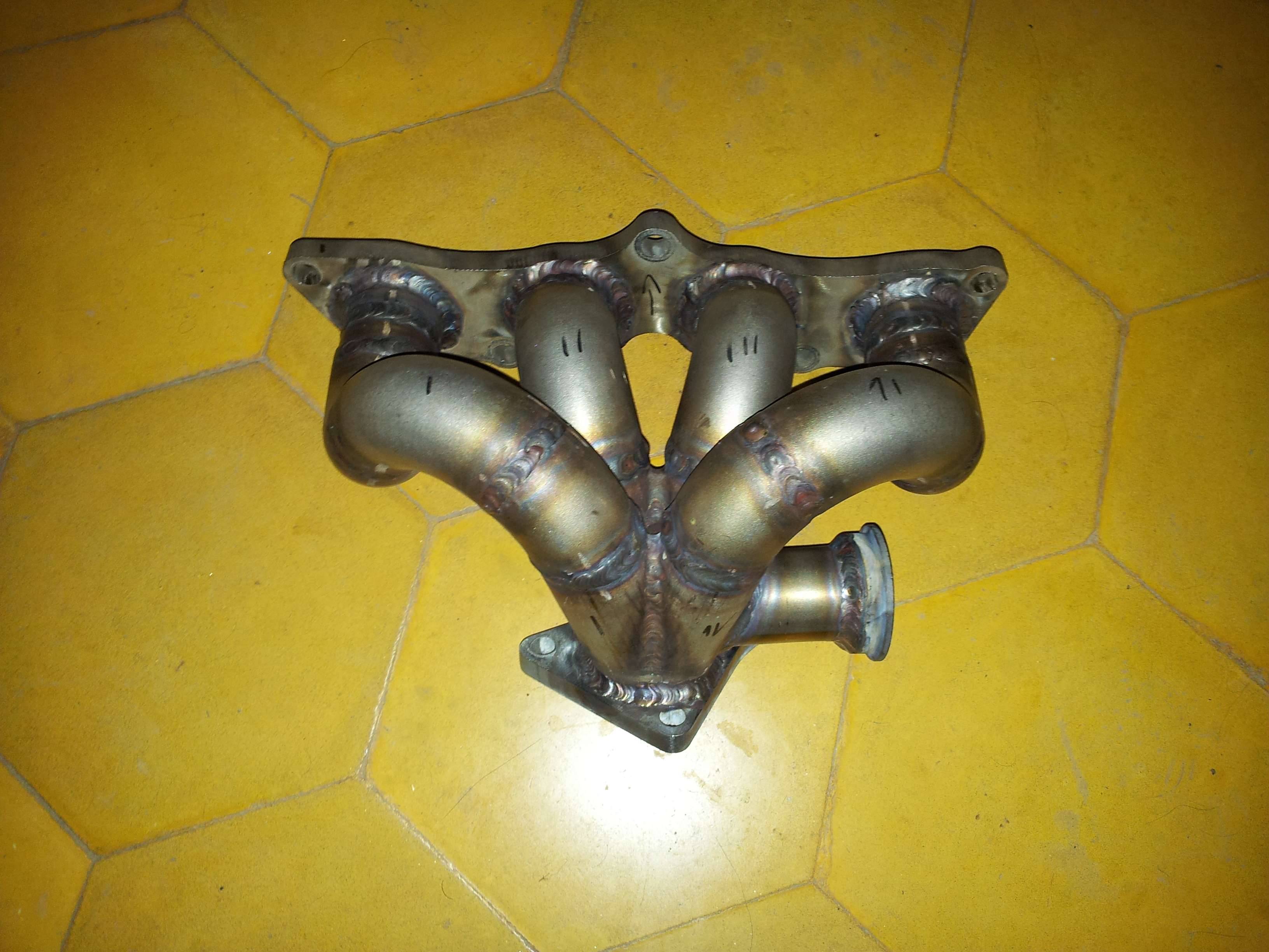

Finally today we finished the manifold which is made by me and a friend that helped to the welding cause he has tig welder. :)
Next step, oil return to the pan and T plug for the oil supply.
Just to make it clear, it is for a turbo conversion.
Because it is custom for my turbo and where i wanted the turbo to be placed, i dont think that it is wise to be replicated for others.
Im a welder so If you feel like it PM me measurements so I can compare location for optimal clearance.
what about a drawing of the exhaust flange then?
That would be helpful but the drawing and the cutting was done by the machinery shop and i didn't ask to take the drawing of the flange.
Im a wwlder so If you feel like it PM me measurements so I can compare location for optimal clearance.
What kind of measurements do you want?
