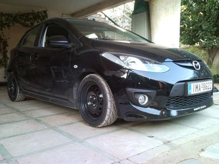

Another photo with steel rims and semi slicks on them for track use,
